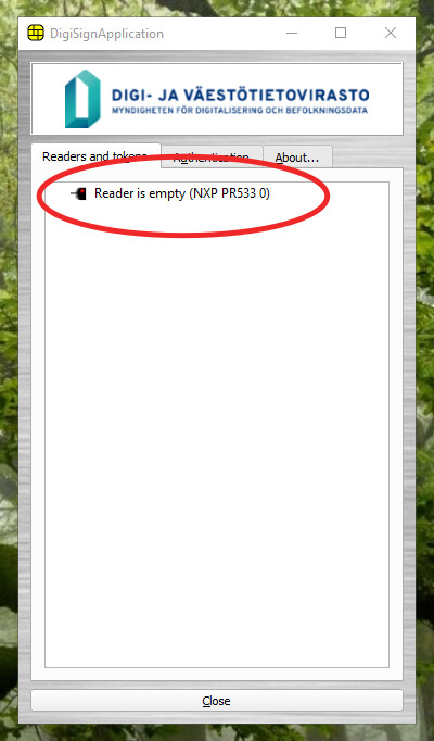

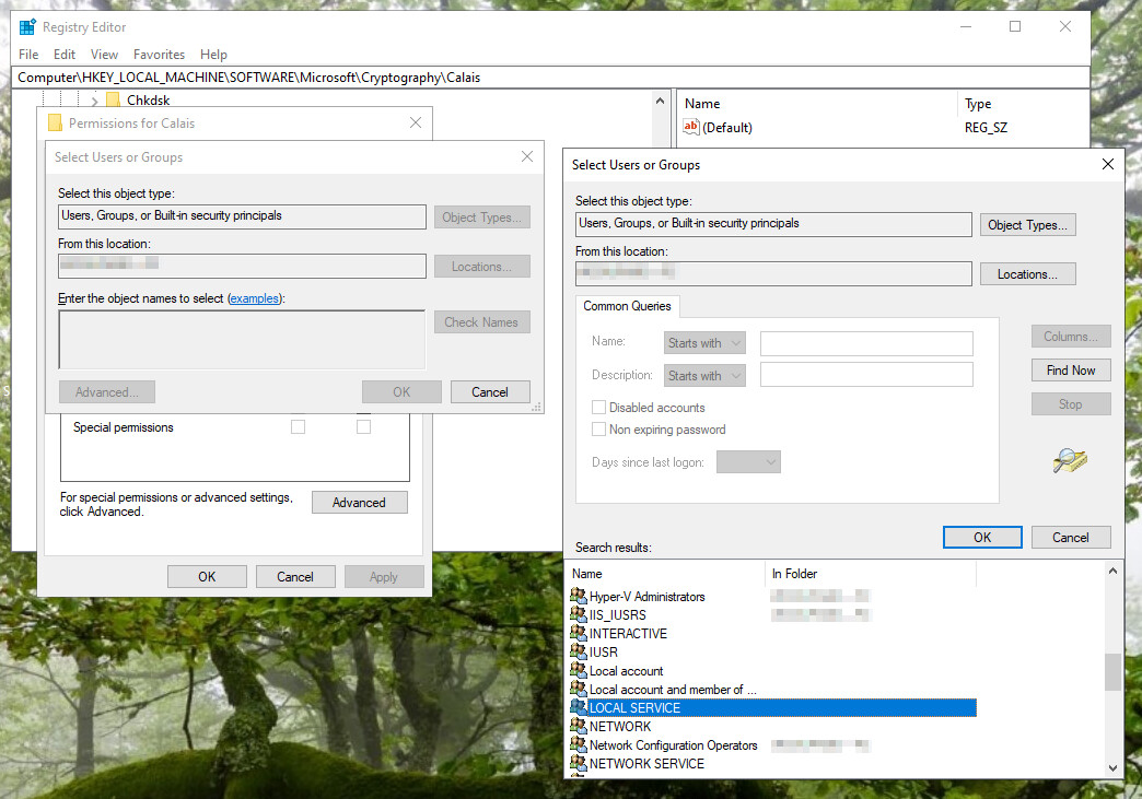

However, if none of your PC/SC applications seem to see the reader, that’s because there seems to be a permission issue with at least Windows 10. To fix it:

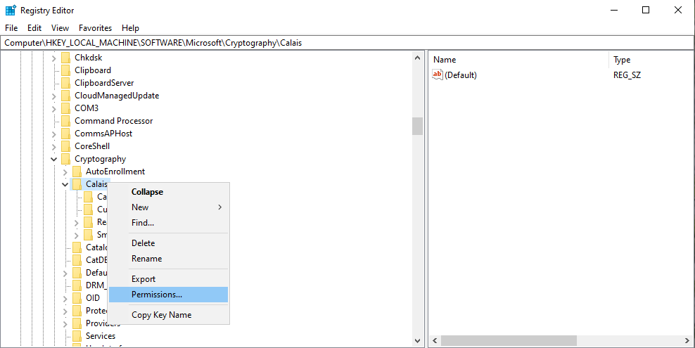

Run regedit, right-click on Computer\HKEY_LOCAL_MACHINE\SOFTWARE\Microsoft\Cryptography\Calais and select Permissions:
I assumed Windows worked straightaway but this doesn’t seem to always be the case. In particular, from what I can tell, this permission problems seems to happen on Windows 8 machines that were upgraded to Windows 10, rather than machines that came with Windows 10 from the start. Sorry about that, I should have checked before making assumptions.

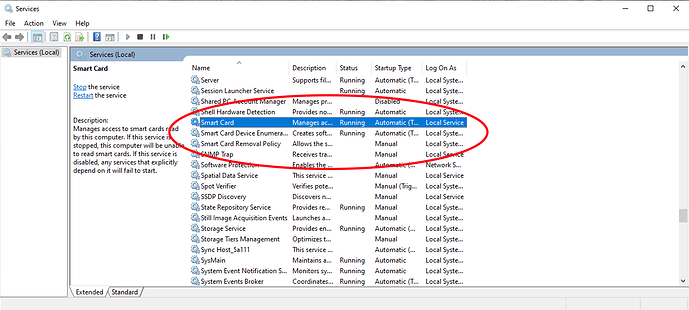

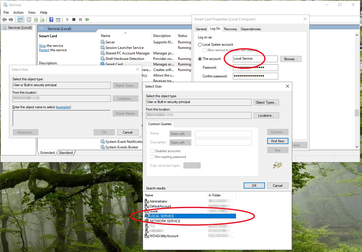

I can’t connect. It must be down. But do this: run services.msc and check that the smartcard service is running. If it is, stop it, give it the same permissions as Calais above and restart it.

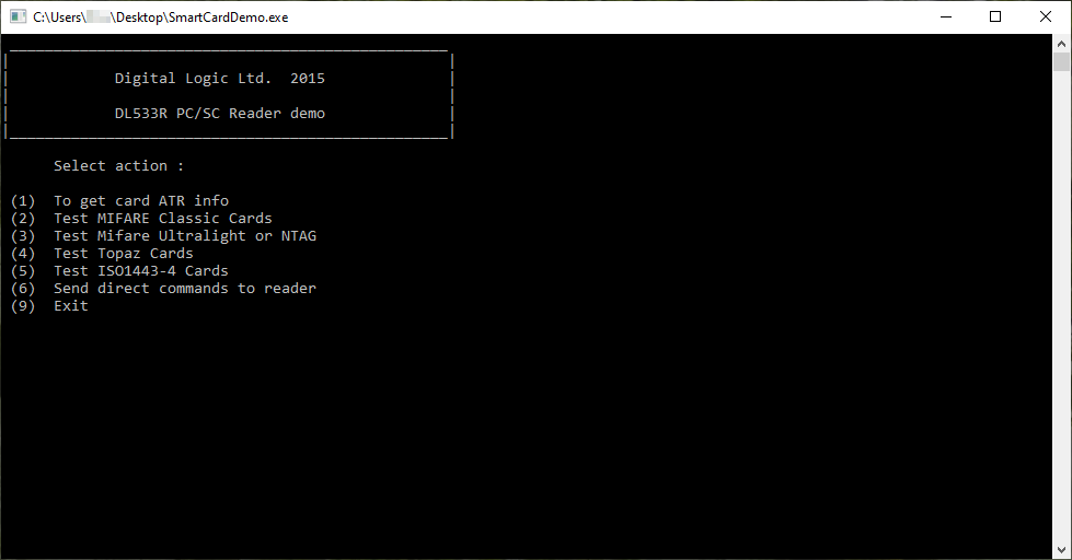

Hmm well, as least I think your smartcard service is running okay, else you would have had a SCardEstablishContext error.
Do you see the menu in the SmartCardDemo utility? Cuz if you do, it works
