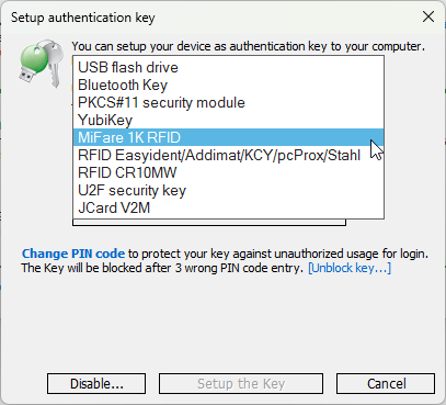

Rohos Login
So I’ve been using Rohos login on my workstation because it’s simple and works.. but it’s old.. old design.. old list of credentials.. UID only auth for RFID/NFC transponders wherein it calls all RFID transponders “MiFare 1K RFID”.. but this is where and how you register chips like NTAG216 or even Apex smartcard chips.
There is YubiKey support but USB only, not NFC.. it’s just old. You basically give Rohos your account password and it will pass that to Windows when you tap a recognized UID to a reader. It’s also esoteric and confusing.. there’s talk of PIN codes which don’t apply to RFID transponders and if you set up your account following the incorrect steps, it will try to ask you for a PIN code to your NTAG216 which fails because it doesn’t exist and then you get locked out after 3 failed attempts.. it’s just kind of a trash interface. There are so many painfully obvious things they bolted on well after initial design and user experience flow, which hasn’t been updated in probably well over a decade.

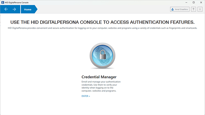

I recently came across HID DigitalPersona which is designed to be part of an enterprise access management system.. however they appear to have a “trial” of a “Workstation” version which is more like a “personal” version that works with stand-alone systems not tied to active directory or joined to a domain. Yes, it still just caches your password and passes it to Windows proper for login, but it’s a modern take and gives you a ton of interesting alternative logon options.

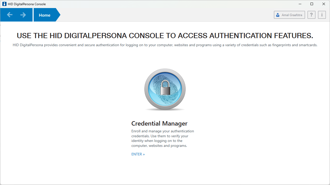

I’ve already configured DP to use my machine account (provided my password) so this is not a setup walk-through.. just a series of interesting screenshots. After initial config, when you open DP “trial” you get this console with just one option “Credential Manager”.
Login options include;
  • Password (like really?)
  • Fingerprints (need a biometric scanner)
  • “Cards” (more on this below)
  • OTP Authenticator “one time password”
  • PIN (really?)
  • Passkey (aka FIDO2 resident key)
  • RADIUS (whoa.. old school)
  • Bluetooth (not sure how it works)
  • Recovery questions

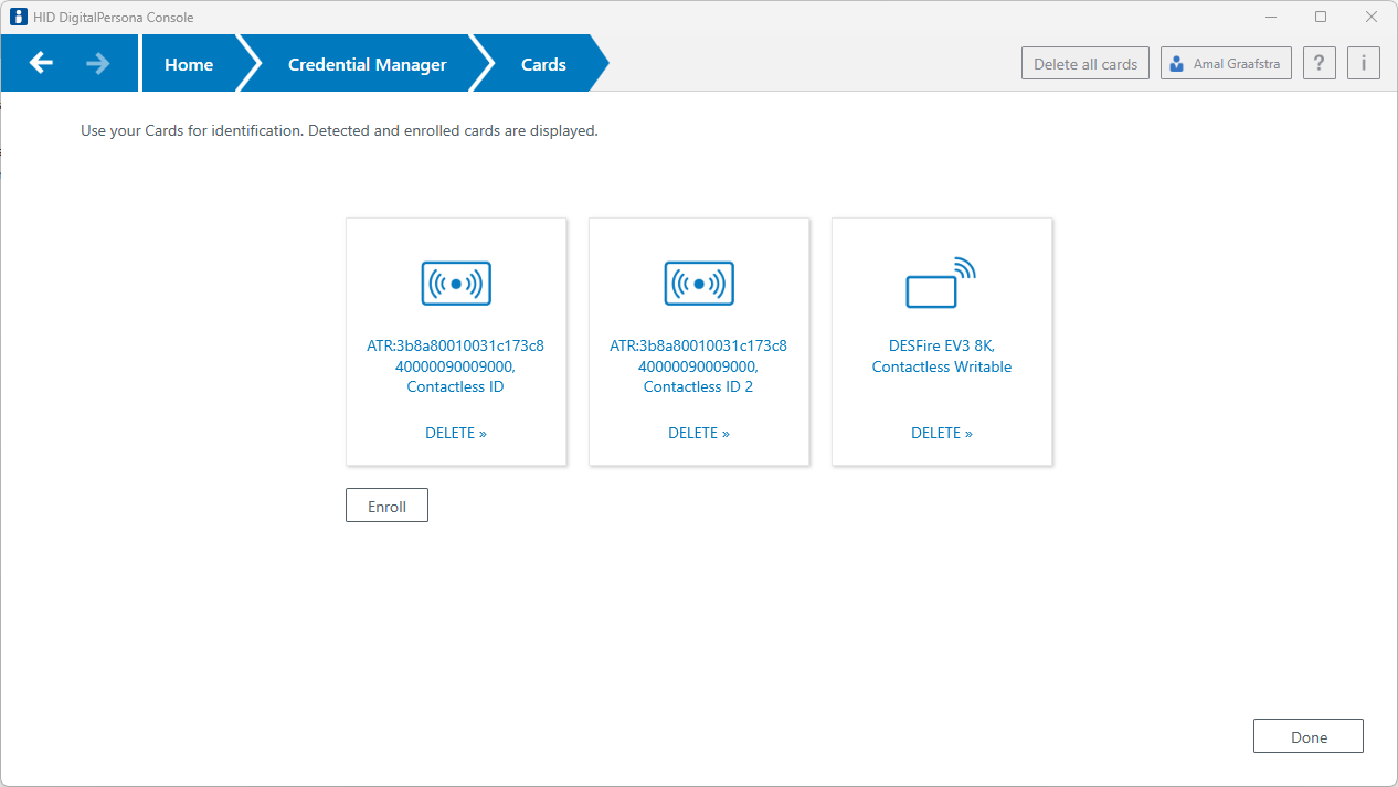

Hilariously, where Rohos can’t use anything but a UID from a transponder, the “Cards” option requires a specific type chip - a smartcard or a DESFire.. basically a chip that speaks ISO7816 over ISO14443A. I’ve enrolled my two Apex and a DESFire EV3 with nothing on it;

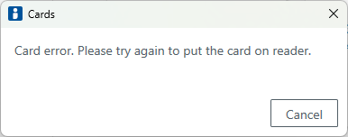

Transponders like NTAG216 will just not work at all with this.. if you try, you’ll just get this;
Apex doesn’t work though
Even though I was able to enroll my Apex, only the DESFire card seemed to be recognized properly and only it was able to log me in. I tap my Apex to the reader and nothing happens. Come on what?!

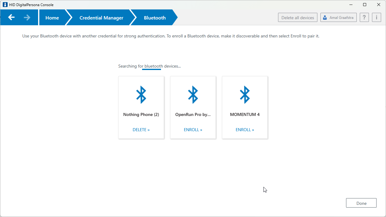

Bluetooth what?
I have no idea how Bluetooth works..
I’ve enrolled my phone, but I have no idea how it works. When I need to auth inside of the DP Console to make changes, I can click Bluetooth when my phone is near by and it works.. but when I try to actually log into my workstation, Bluetooth is not presented as an option;
But, upon reading the release notes..
2025-06-20-EQeDRTghSw
So they removed the ability for it to log you in, but kept the whole enrollment and in-console auth function of Bluetooth? Like.. wtf?

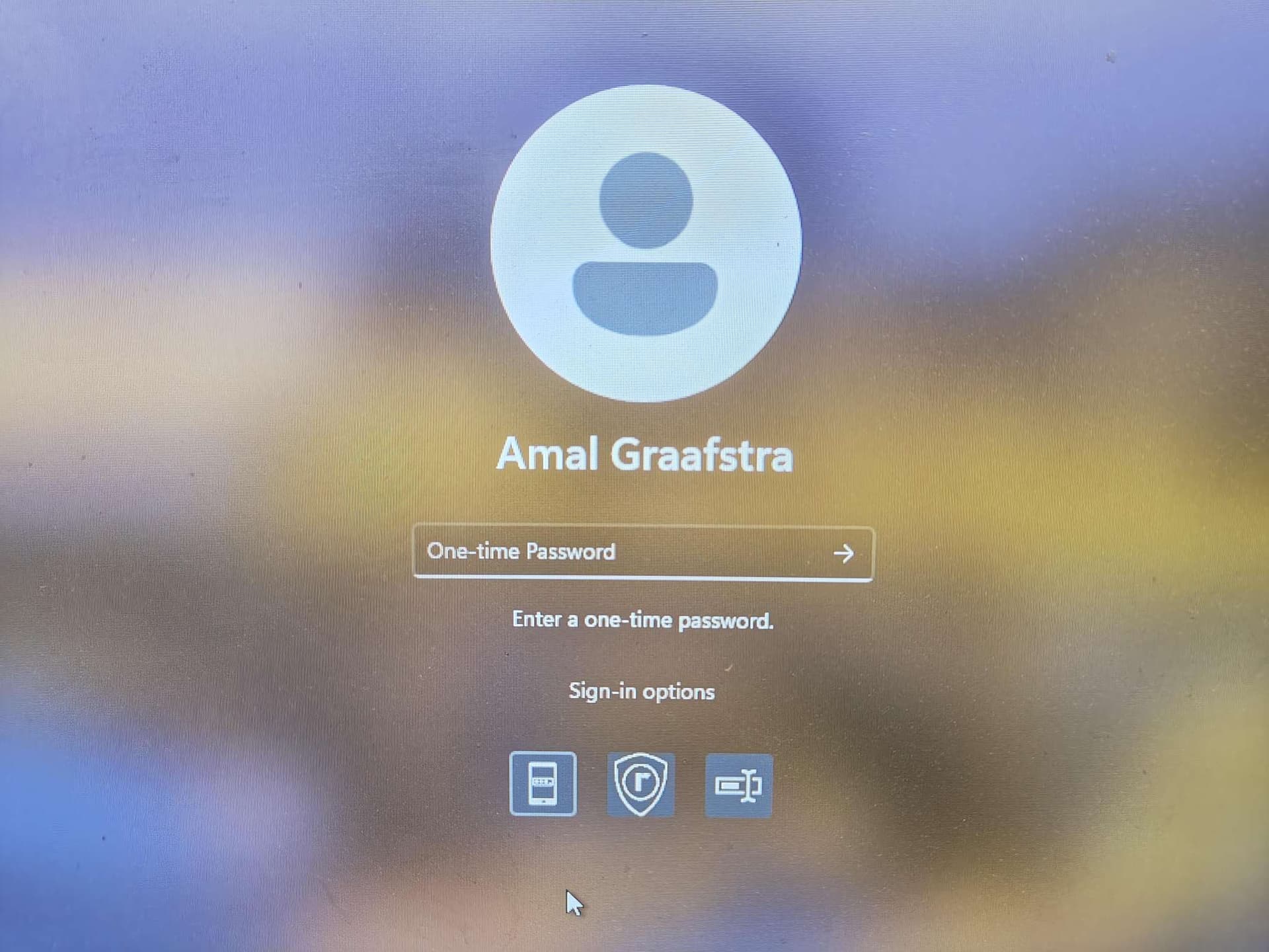

I still use Rohos on my workstation while I test out DigitalPersona on my laptop. This software looks nice but I’ve found a lot of jittery jank. Sometimes card enrollment just hangs.. reboot. enrollment started working again. Sometimes I go to log in with something and it just borks.. gives odd error message. For example, I put the DESFire card on a reader at the login screen and it blipped, then said “Present writable secure contactless card to log in” which I already did.. then removed and tried again.. the error message did not go away or change.. I had to cancel out and log in with my real password.. reboot.. worked again.

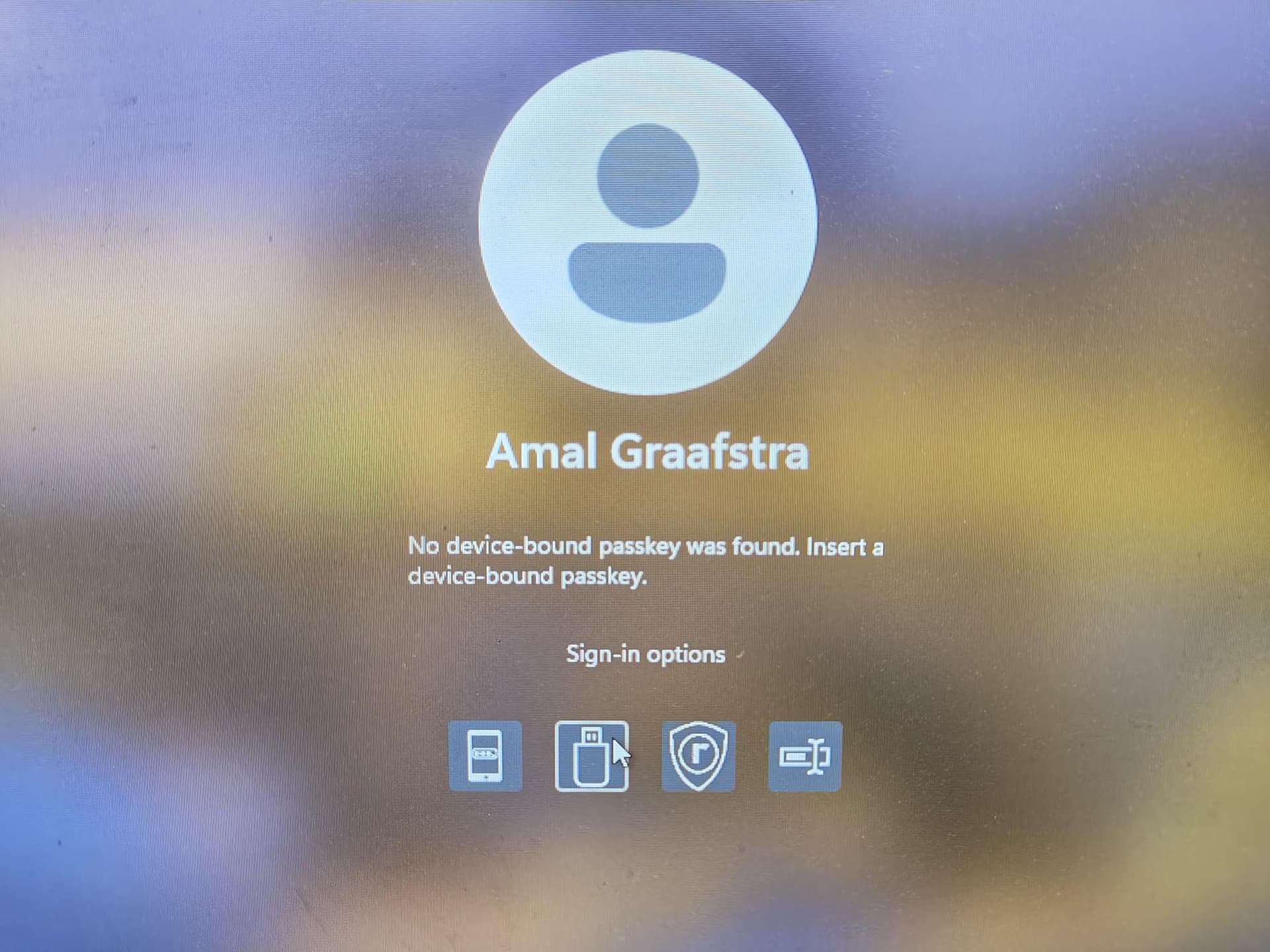

I like the OTP option DP offers but so far I can’t seem to get my Apex working as a “card” and while I did enroll a Passkey option it uses the Windows FIDO interface for talking to my passkey, but when I try to actually use it to log in, I get this;
WTF you mean insert? Bitch, I registered a contactless Passkey through the Windows FIDO dialogs. I can’t even ask it to try to get Windows to prompt me to present my passkey.

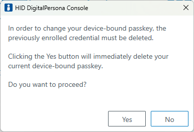

Oh yes, and apparently you can only have one Passkey registered? That goes against like basically every premise of FIDO, but ok..

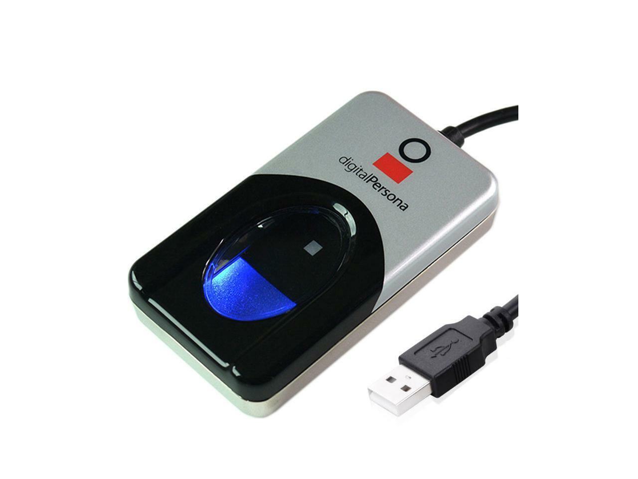

Random fun fact: DigitalPersona originally I believe a biometrics manufacturer and Crossmatch Technologies acquired them and HID later acquired them. They’ve been around a while and have SDKs that someone posted on GitHub somewhere for their fingerprint readers and how to use their dev tools for home brew stuff. Not sure if this is relevant but thought it would be useful to tell you folks
You just made me feel old… I remember their fingerprint readers…
