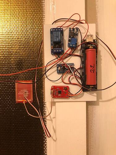

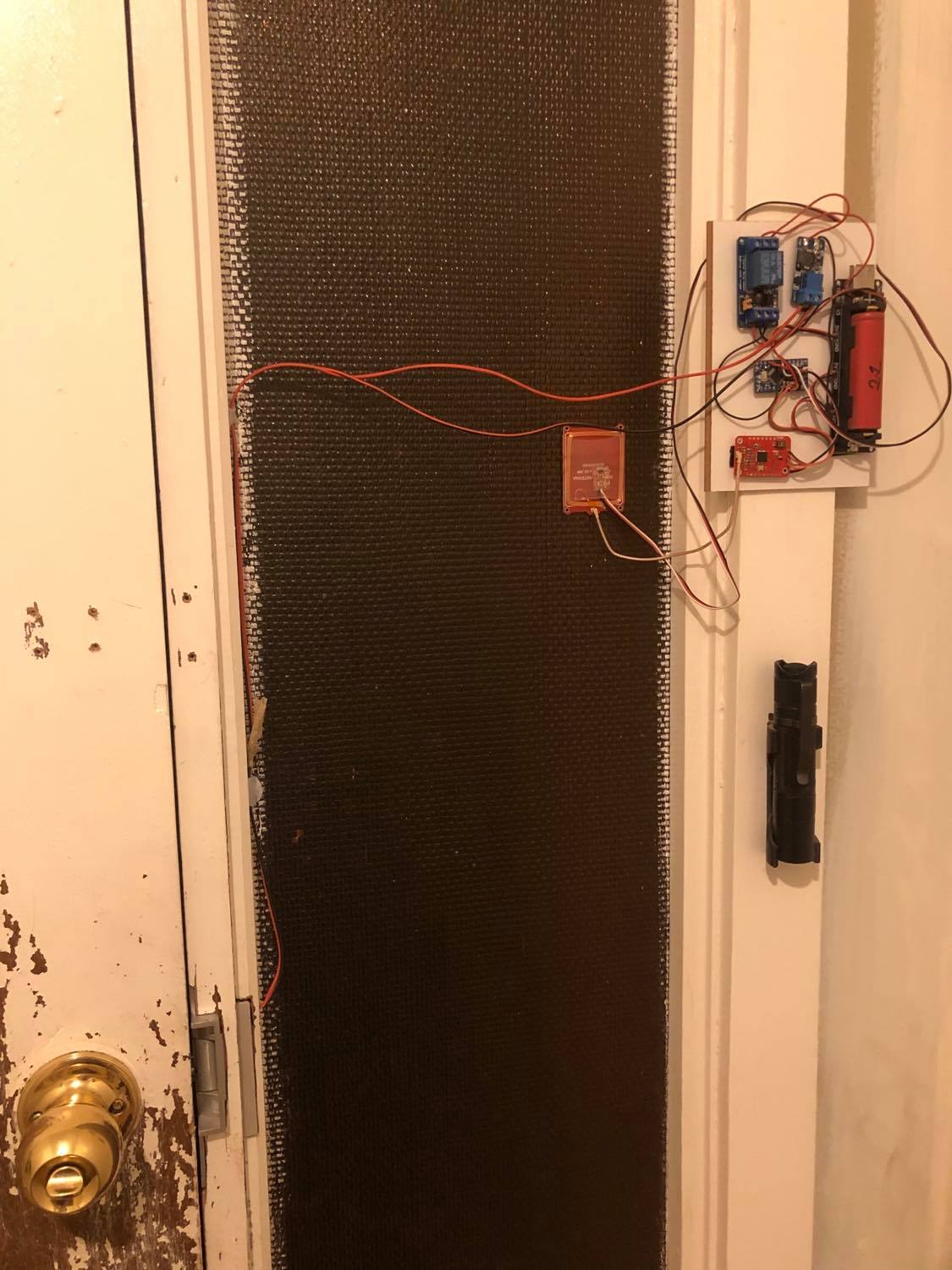

This is my door lock I’ve being using for the last few years. I intended to integrate it and get custom printed circuit boards made but never got around to it.

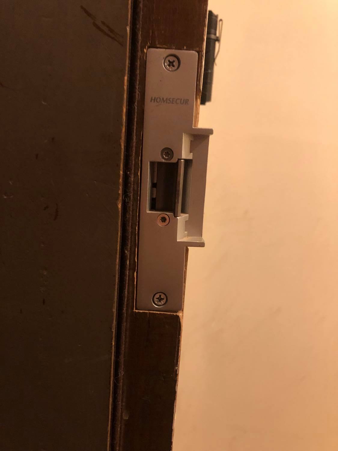

The reader works through the window, unlocking a electric striker.

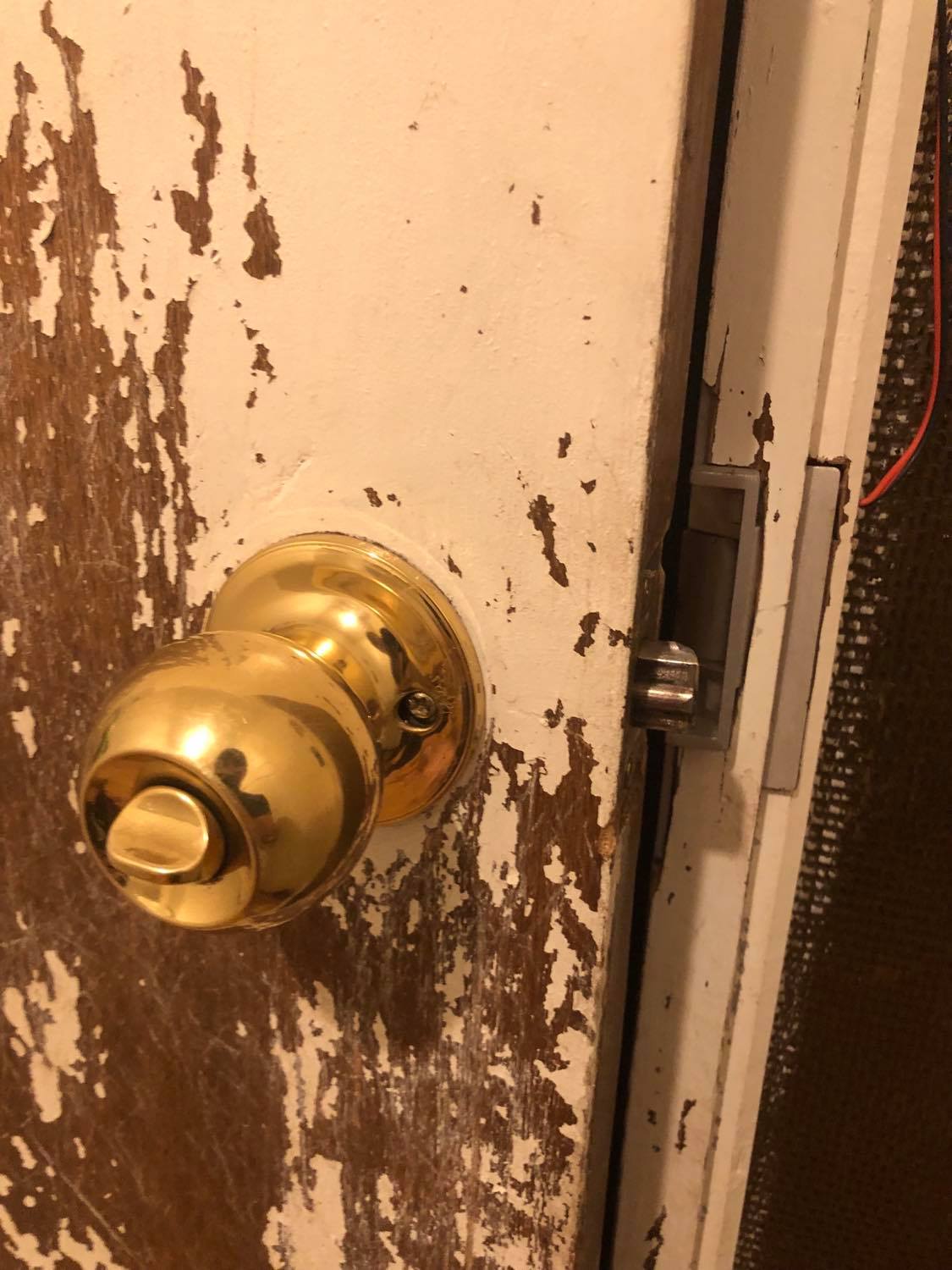

The original door lock and key all function the same
It is great, i can push the door open if i am carrying things like groceries without having to turn the handle.
It runs off a single 18650 (battery) for 3-4 months before i can tell the battery needs to be changed. It still opens but i can tell solenoid in the electric striker is getting weaker when the battery is low. Would be easy to add a low voltage buzzer.
