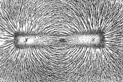

Are there potential MR complications from depositing said metal into fleshy bits?
Not likely. The particles would be extremely small. Technically there would be an effect on them but the total amount is so tiny the amount of force exerted on each particle is pretty miniscule. The alignment of magnetic moments cumulates along the entire vector of mass affected by the lines for flux, so the smaller thr mass the less force.
If you lived in an active MRI machine, over time they would make their way into alignment, kinda like iron shavings on paper.
I don’t know what this is–is this within the vocab of bodymod folks?
