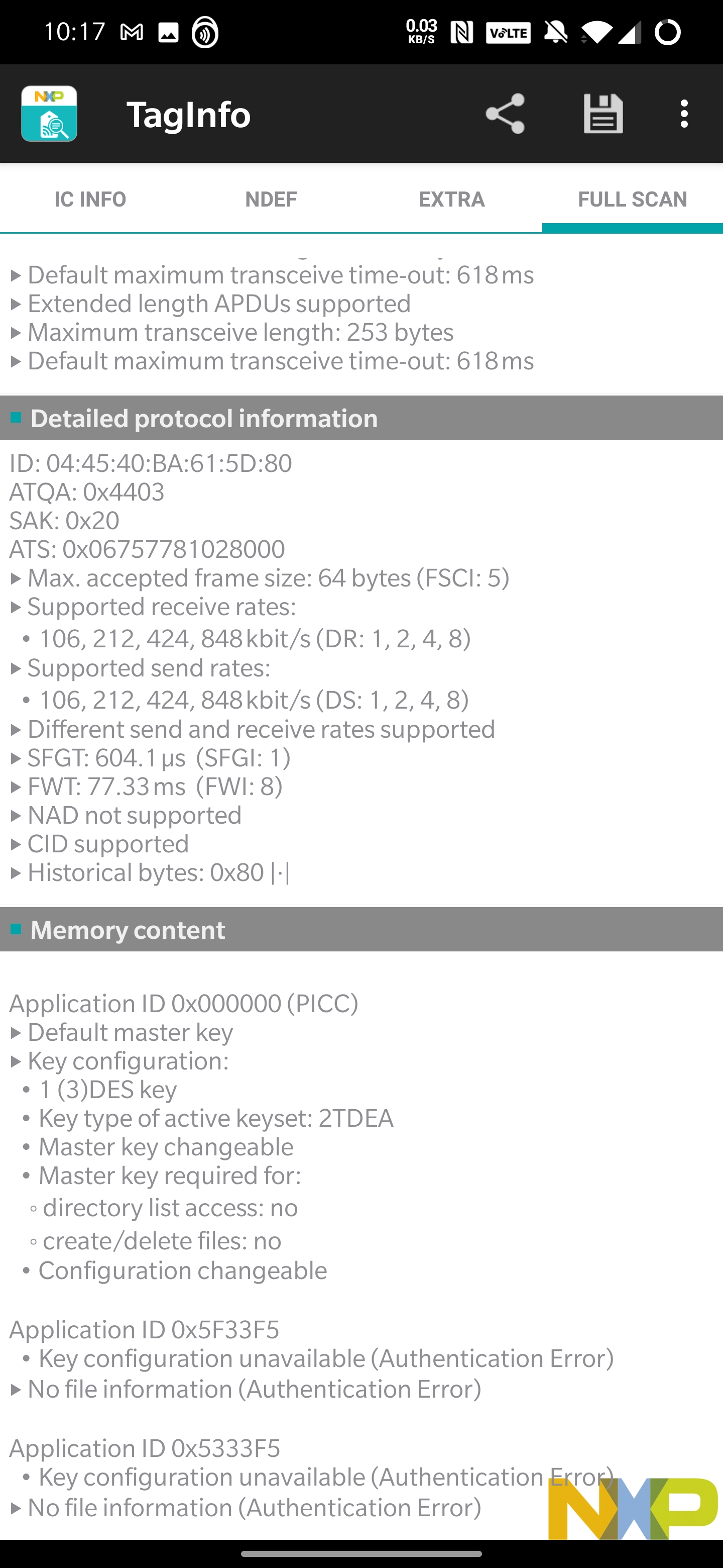

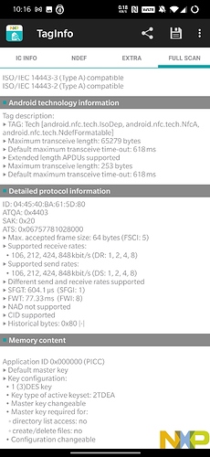

Hi all, long period of silence. Life has been busy. I will forward some of the remarks given above about security to Dom and ask what they have to say about it. Just a quick post for now. It appears if you use data on card (new feature) that the eniq app writes desfire apps to the card. The UID in the screenshot is from a cheap card, not my hand. :wink:
One is without desfire apps (before) and after adding card in app it does have them. I don’t know anything about how they implemented it of course. But I will ask.

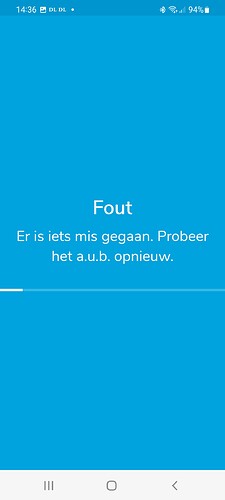

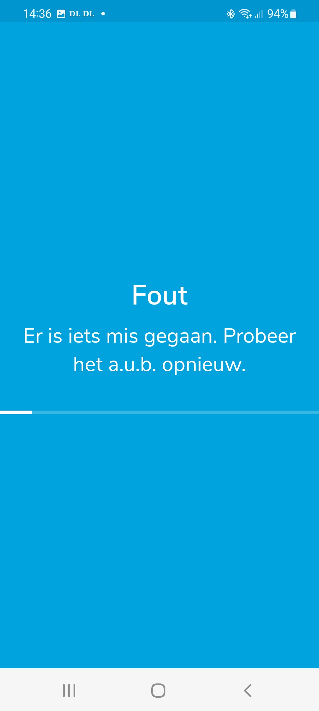

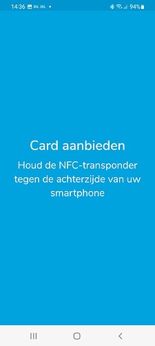

I installed the DOM Tapkey Pro at home, but when i want to add the NExT in the Domkey App as a NFC tag i got error.
I there a other way to program it to use with NExT ?
Hey Hello,

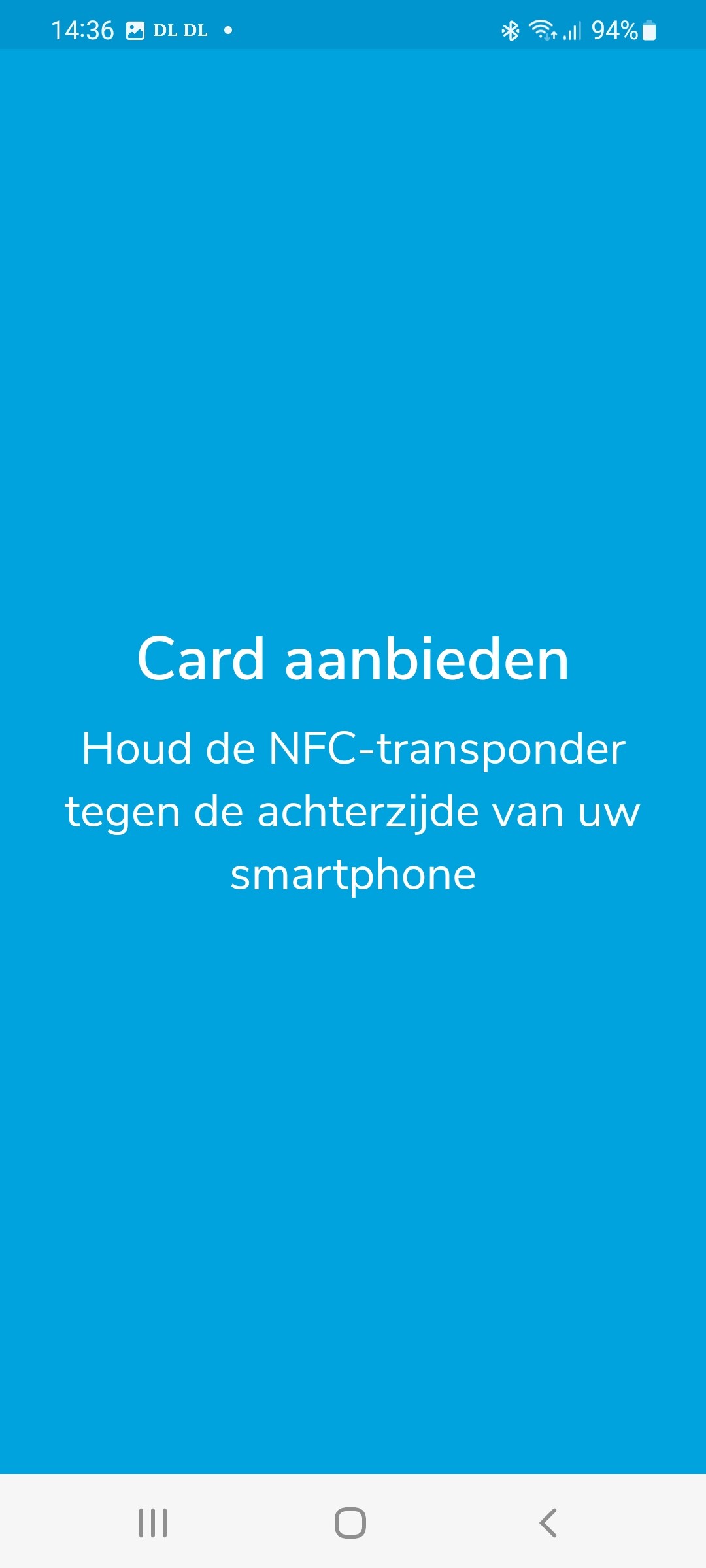

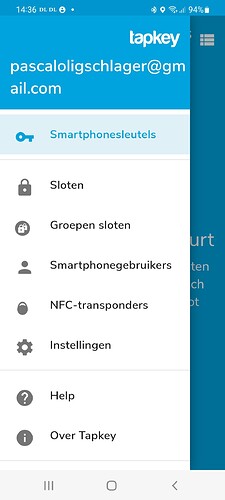

I have bought the DOM Tapkey Pro but cannot add it in the phone application.
I tried to add it under NFC-transponders.
I have an NExT implant but when reading it gives error.
Do you know how to program the NExT with the DOM Tapkey Pro ?
What’s the error?
Its in dutch but says: Something went wrong, try again.

Where did you find this info ? Where can i add a non DOM tag ?
I have contacted DOM and they told me that with the DOM Key it is not possible to use a external NFC Transponder.
It only works with Tapkey transponder and BLE.
Only the ENiQ-systeem of TAP works with external transponder.
So i choose the wrong product …DAMN
