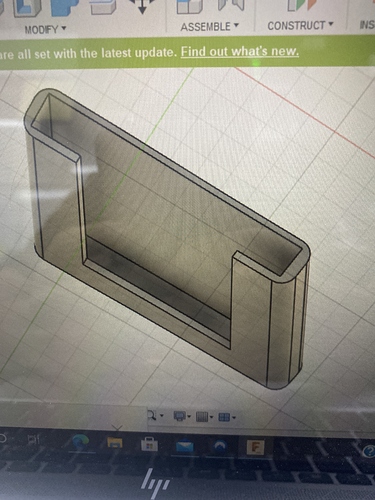

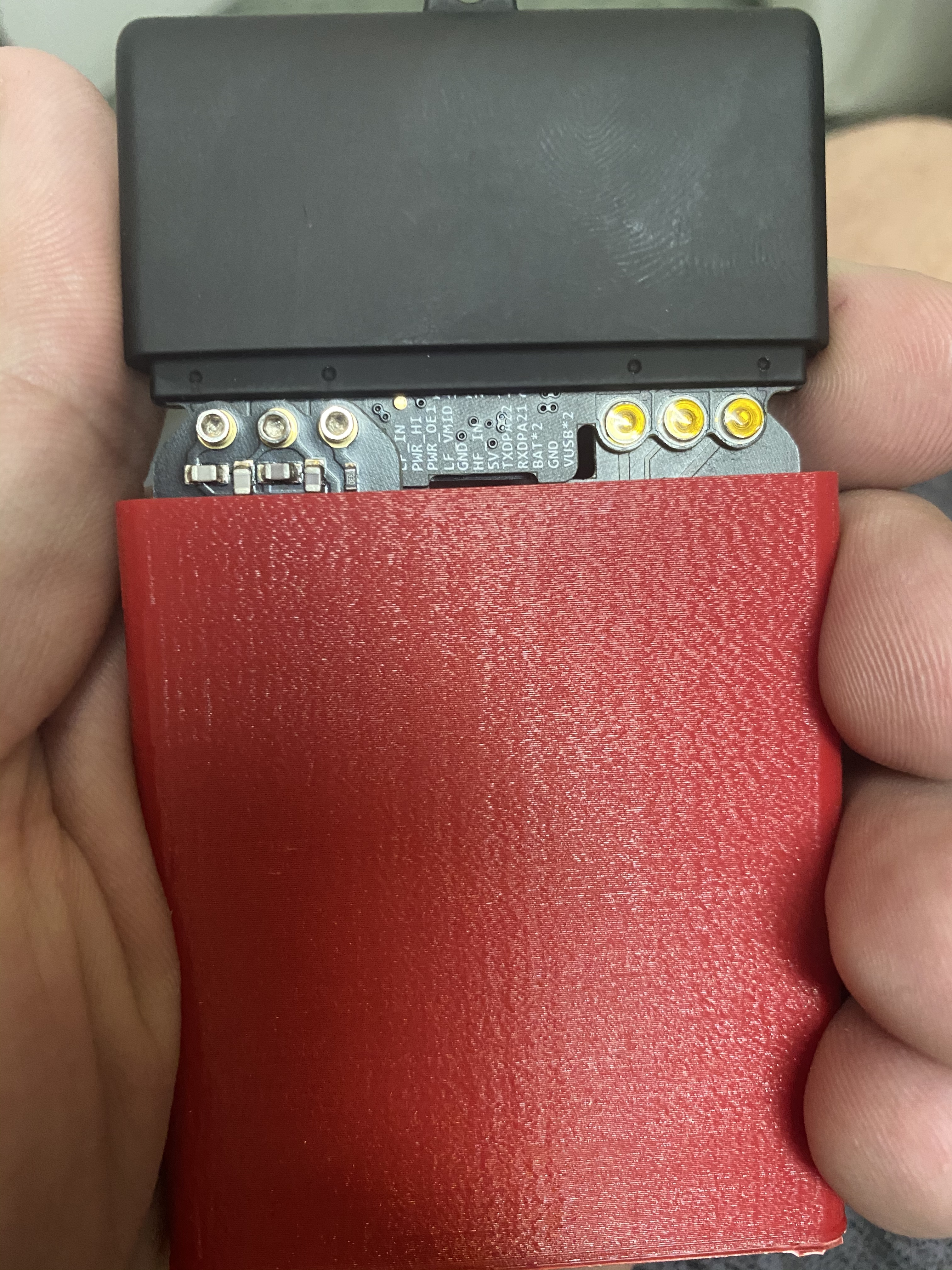

Dual antenna HF + ProxLF mod for the Proxmark3
let me know how well it fits and clicks on, I love the cad file to mess around with designs if you don’t mind
Sure it’ll
Have to get transferred over email the forum only allows certain file types
zip it… should work… also I will add .stl and .zip file support if it’s not there already.
Ok updated

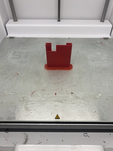

First fit will go in about 30 minutes
If it’s good I’ll post and then design coil cover/center piece

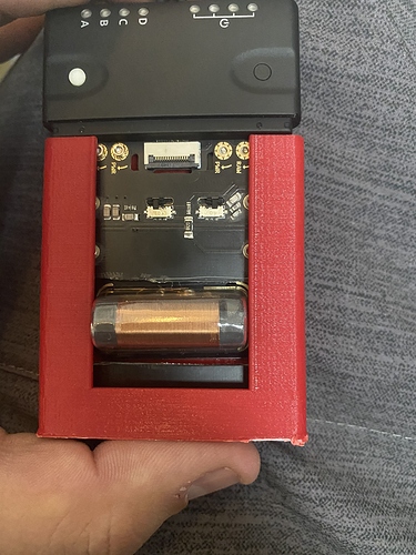

Fit was off Bc I reversed bottom screws
Slot has been made re printing

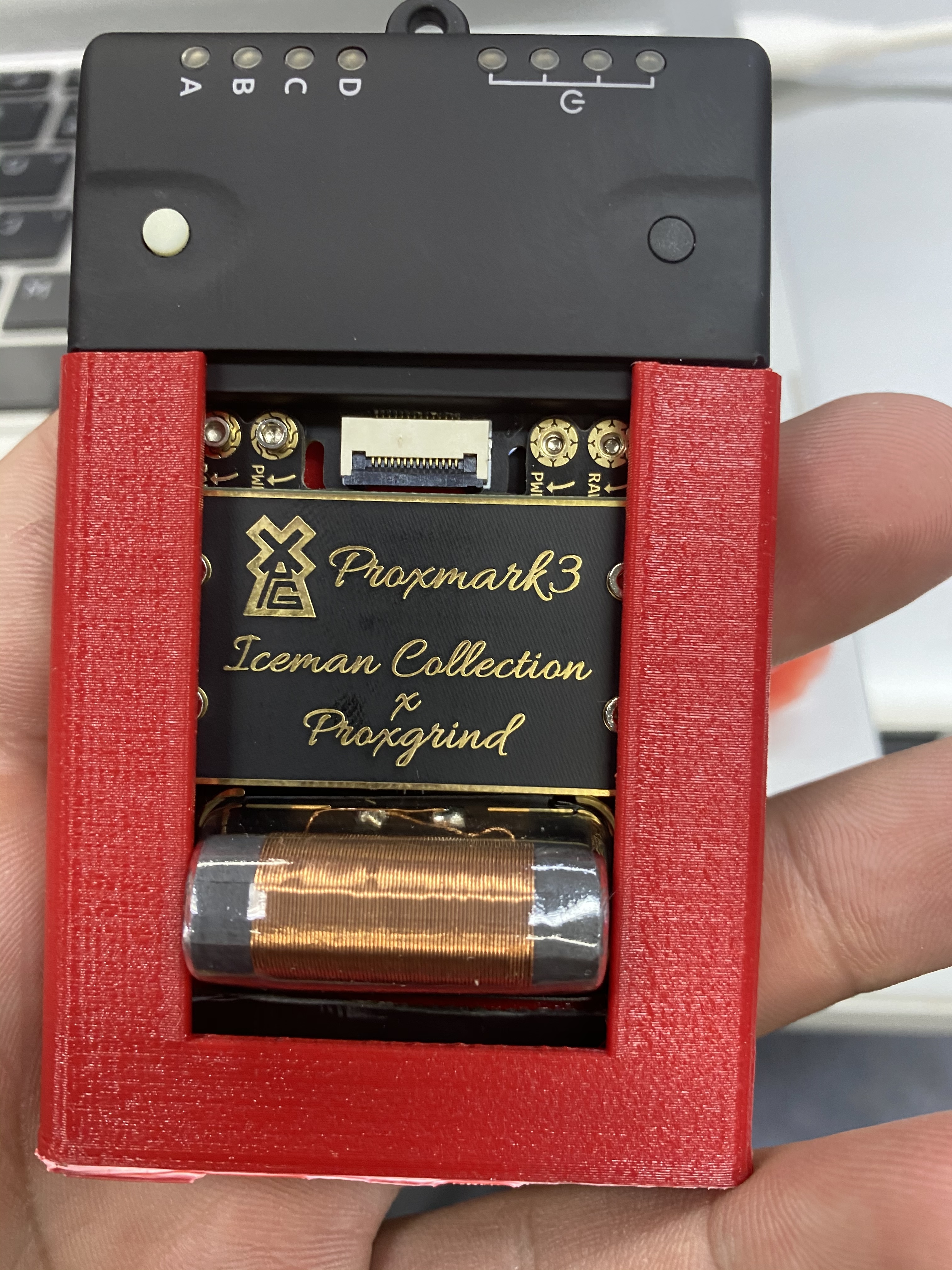

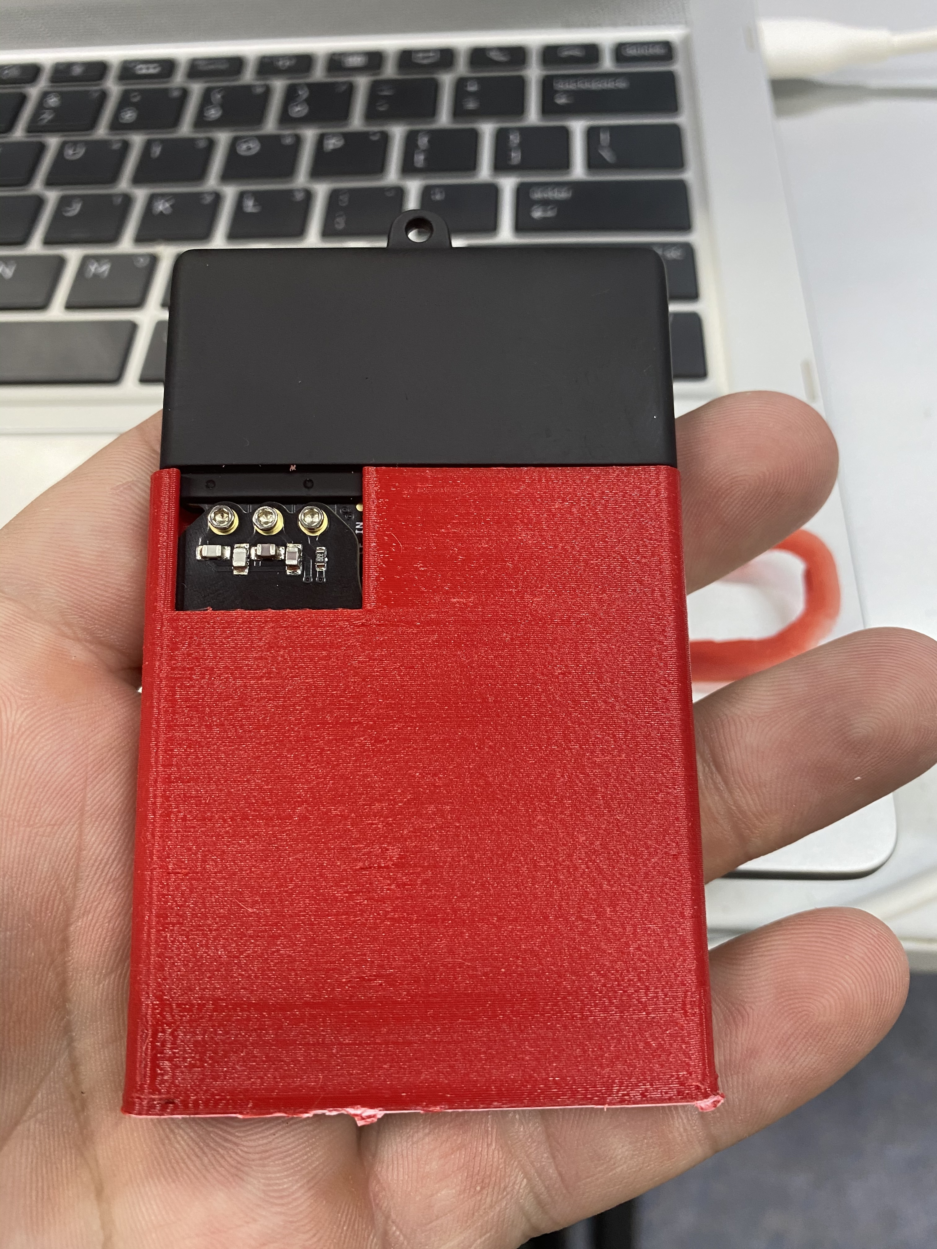

Also I was getting a LF antenna unusable notification with that setup.
I wonder it it was because it bypasses the switches on the back or what???
@vampire_blue
That looks really good!

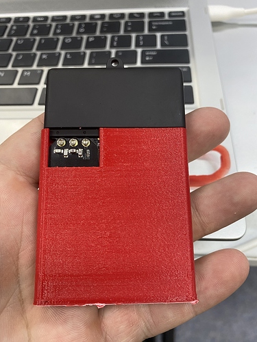

This antenna mod idea worked amazingly. I used the longer screws suggested, but didn’t end up using any spacers. I ultimately created my own case design to work with the BT module. Here are the files if anyone else wants to do the same. STL, Step, and F3D files are in the zip. I printed in PETG-GF with 0.20mm layer height and no supports needed when the opening is at the bottom. Note, I think the SLT is tilted about 1.25 deg off from flat on the base plate, you will need to tilt it or lay it on that face.
PM3 RDV4 Cover.zip (603.6 KB)
