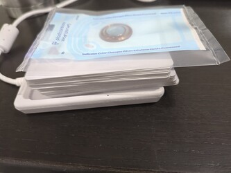

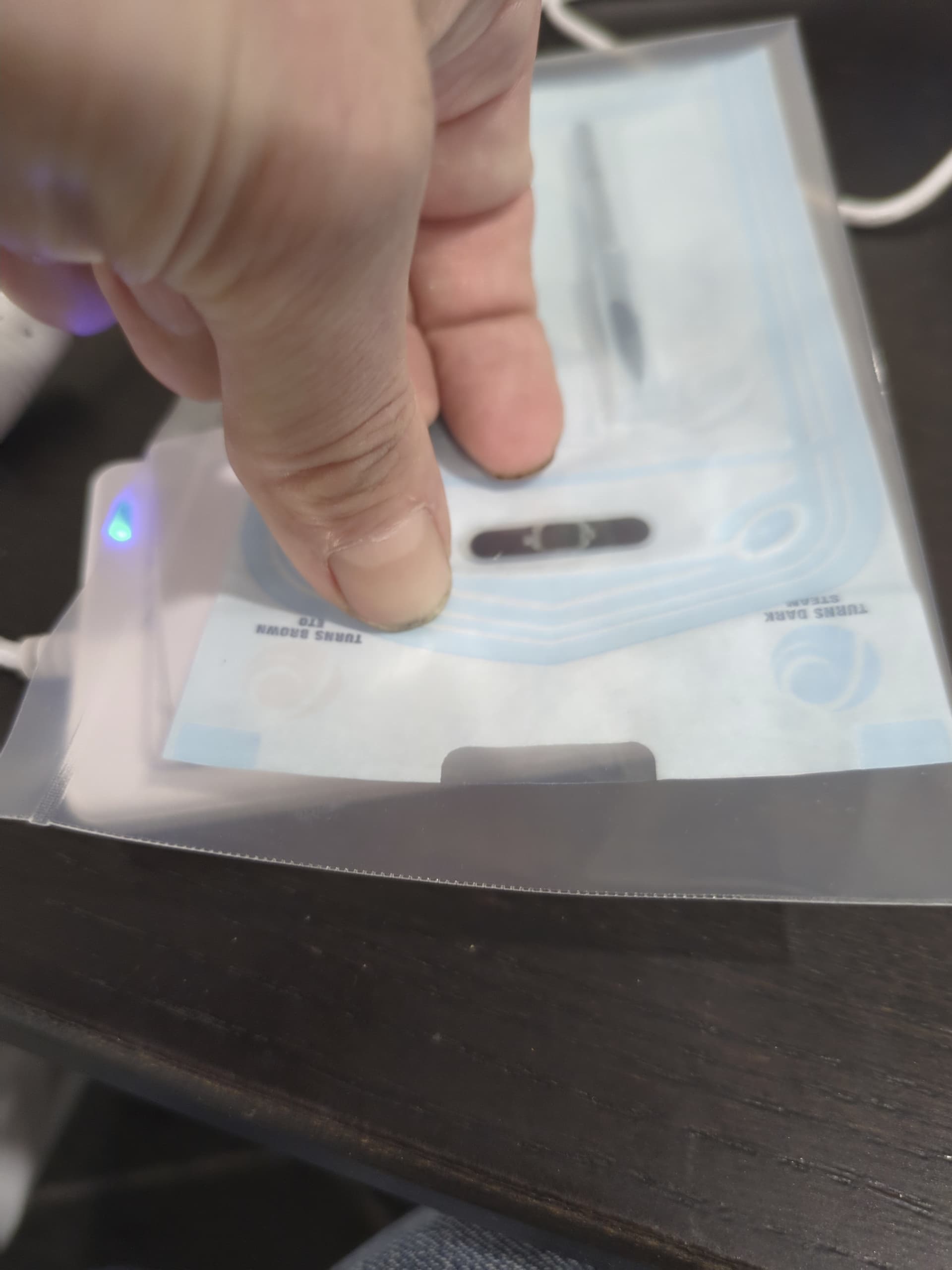

Range is about the same, maybe a bit shorter than the flexUG4, @amal?
Ah, Amal put his money on the dUG4T (which for whatever reason I pronounce “doo-gawt”). And I was waaaay off.
Test shows:

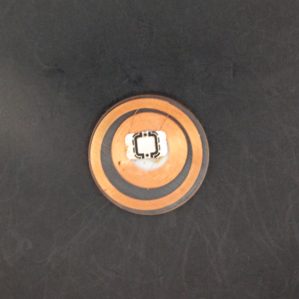

But the bigger kicker is that the dUG4T’s circular antenna can just be scanned. It doesn’t have to be presented just-so (the narrow antenna is still way less particular than an x-Series).
