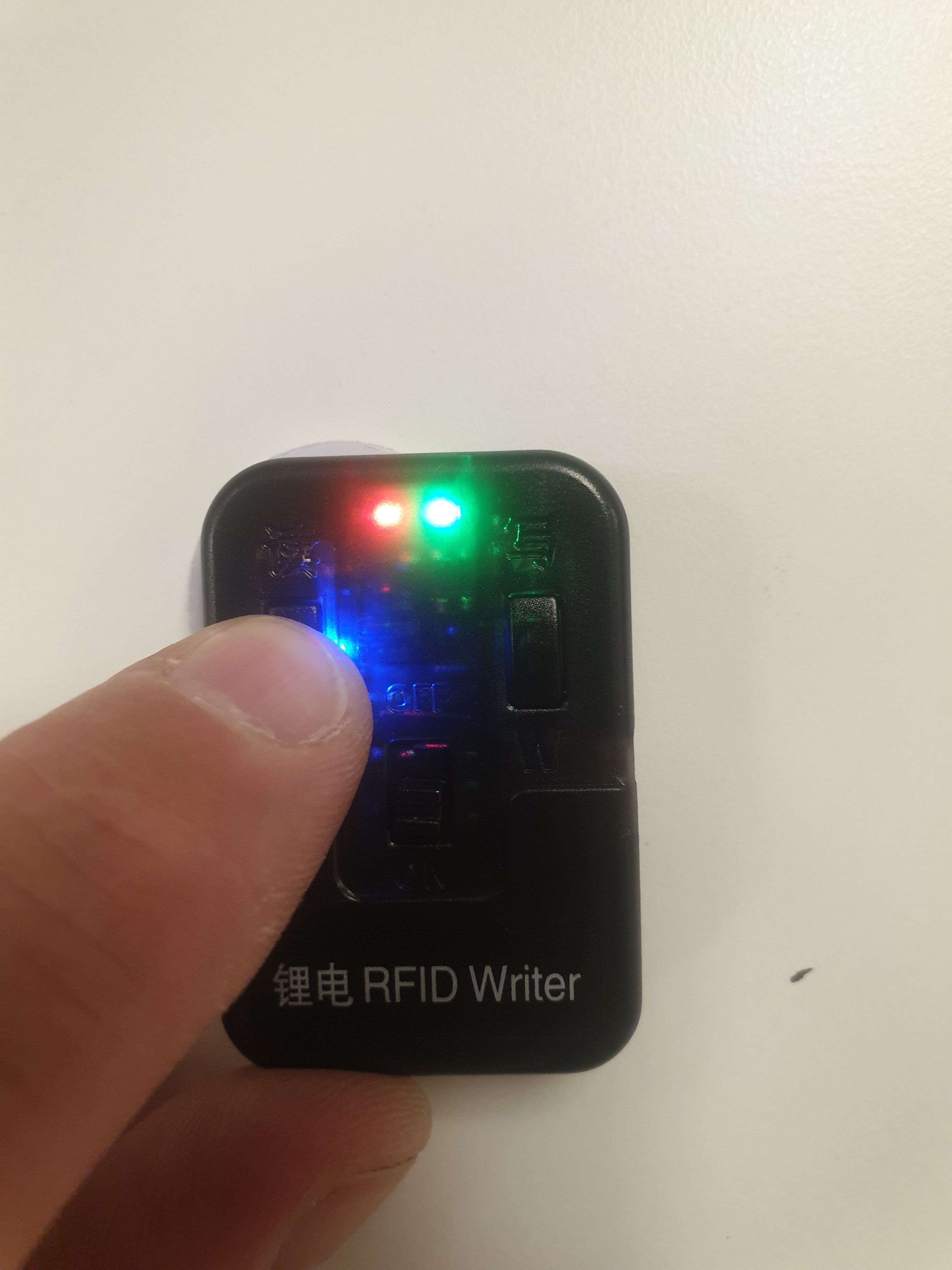

(***) EM MARIN Writer for T5577
This writer is only for T5577 cards and EM Marin system (ID)
45mm x 30mm
SOURCE
Sneak Technology
CAPABILITY
Reads and writes T5577 chips in EM Mode*
*EM 410x was the only card/tag/fob/ “FlexEM” ( Aliexpress Analogue ) I read and wrote to.
Reading
Stored data, waiting to write
To be aware of:-
This will write the “standard” 51243648 password
Remove the Fucken 51243648 password

PROs
• Very small
• Works reliably
• Rechargeable ( Micro USB)

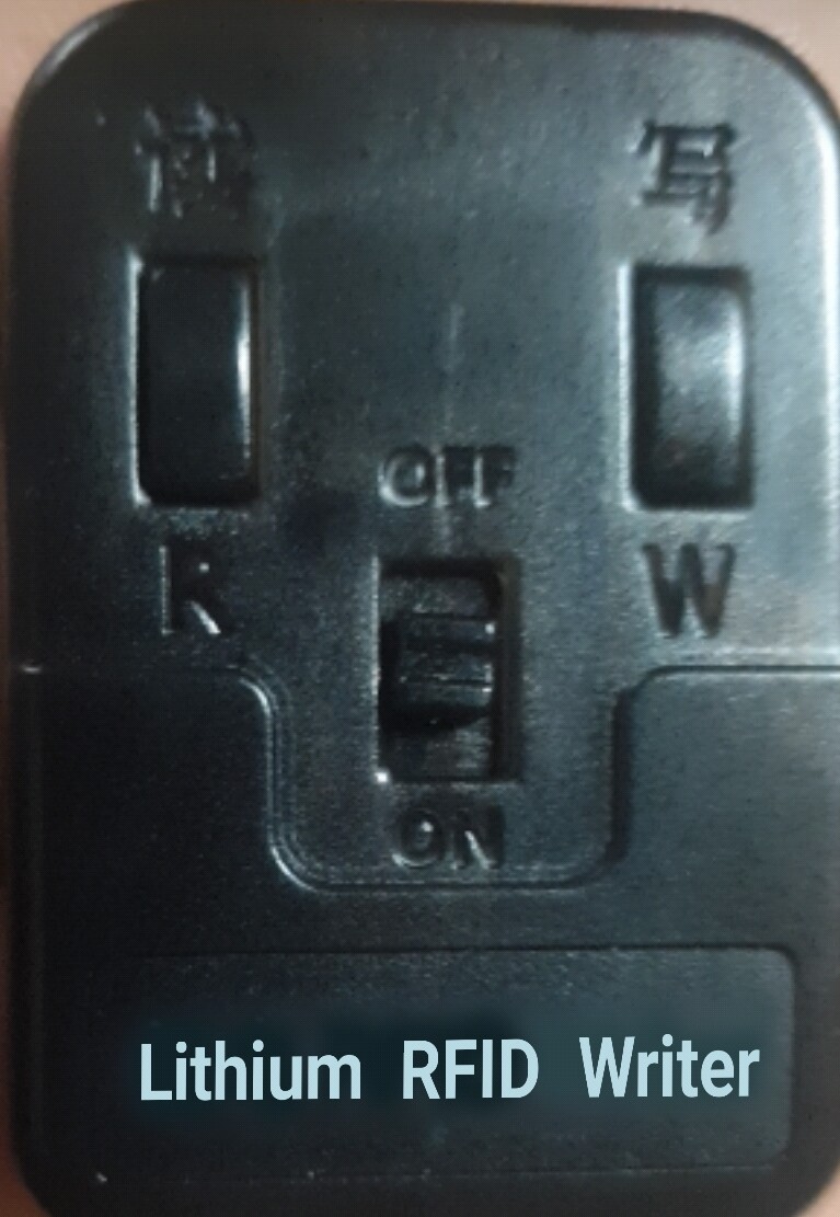

• Extremely simple to use ( 2 buttons - Read Write, 1 switch - On Off )
• Cheap
CONs
• Forces on a password
• Switch not protected ( Easily bumped )
• Limited mode options
PRICE
$10
Summary:
Does what it says and does it well.
Tested on “FlexEM” ( Analogue, Not implanted ) and it read and wrote SURPRISINGLY easily.
I didn’t want to risk it on installed xSeries and I have no spare xEM or NExT to test it on.
Normally I would have presumed there was no chance it would work on an xSeries, but the ease with which it wrote to the “FlexEM” it MAY have a chance :interrobang:

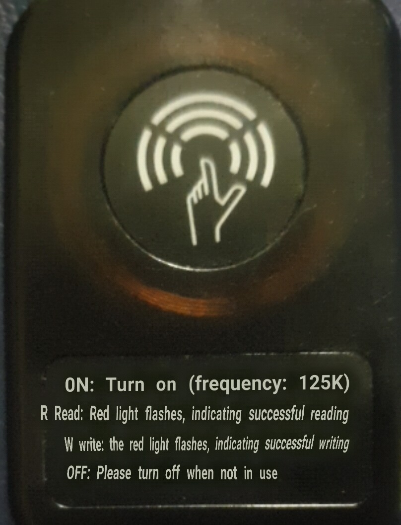

Feedback is visual rather and audible.
Remembering of course you don’t need to remove the password when you are reading and writing with it, its only when you want to change modes or wipe back to T5577.
In fact, I didnt try, but you SHOULD also be able to interchange reading / writing with the Blue cloner in EM mode.
The case is translucent and you can see the antenna, and it has a :point_up_2: place here symbol on it.
