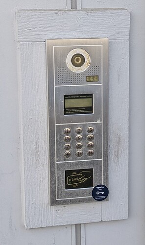

Here’s a photo of the outdoor panel,
After researching, I discovered this is the BEC MT-D5S but the spec sheet and key fobs have no RFID details. So I scanned my key fob with an iCopy-X and found this:
