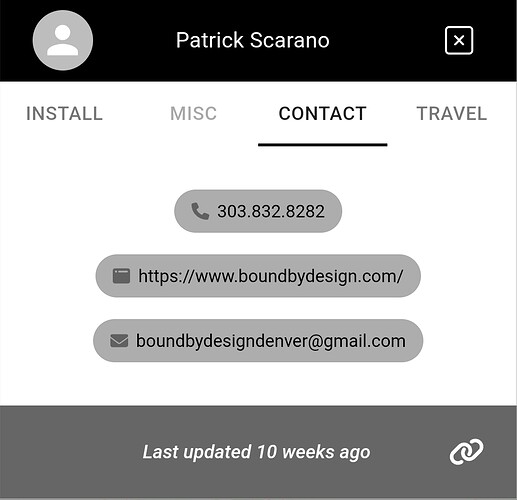

I’m in Colorado, I saw there’s an installer in Denver i think?
