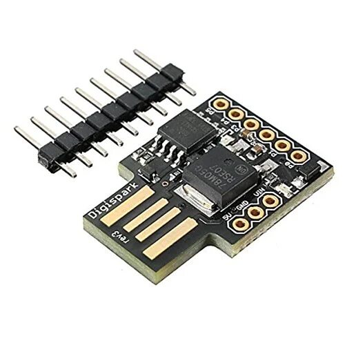

what are some of the use cases of the supermini? i still have a few 8266’s i need to go through but i dont think im familiar with a digistump
the digistump is a dev board based on the ATTiny85:
I likes it for its size and price
The use case of the supermini is to be smaller than comparable boards with quite a bit of precessing power and built in BT and Wifi … its just a supped up 8266 with a few less ports :grin:
