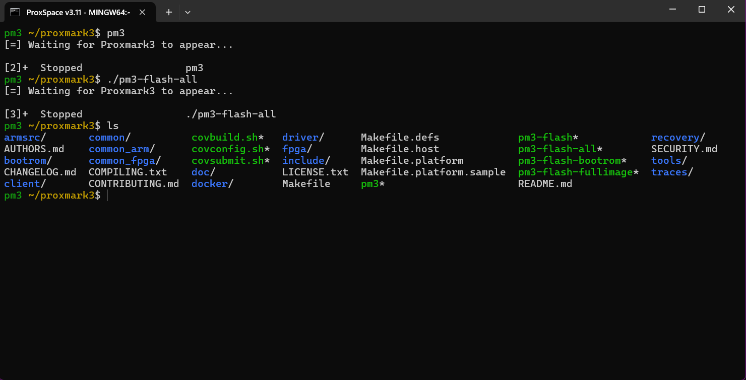

Im having difficulty getting it to flash. Ive followed the guide and the videos and have no problems right up to having to do the command ./pm3-flash-bootrom
It just sits at “waiting for proxmark 3 to appear…”

This screenshot is just a example but no matter if its flash all, flash bootrom. what ever its not doing anything.

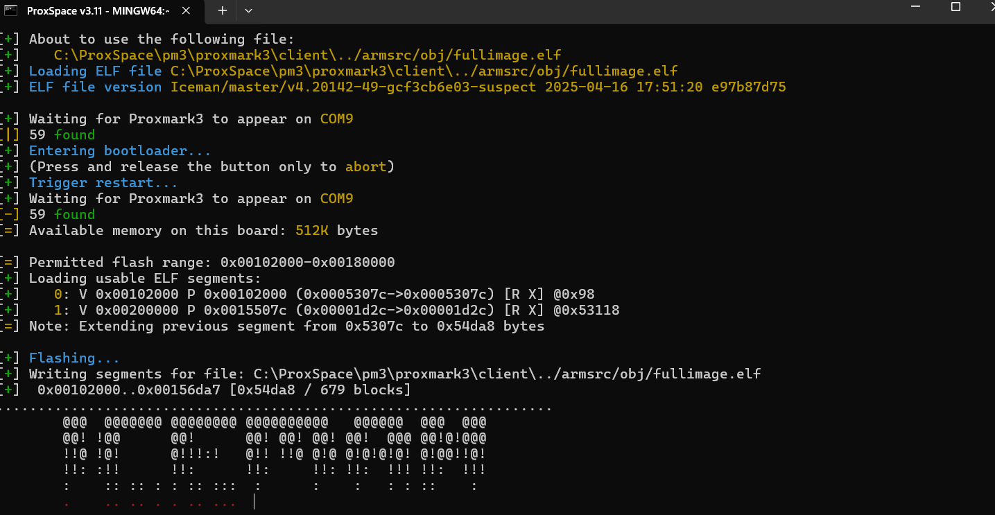

Have you tried manually setting the port with something like: ./pm3-flash-fullimage -p COM3 ?
Windows 11 has been having some issues with the automatic port detection for those scripts it seems…
That worked!!!

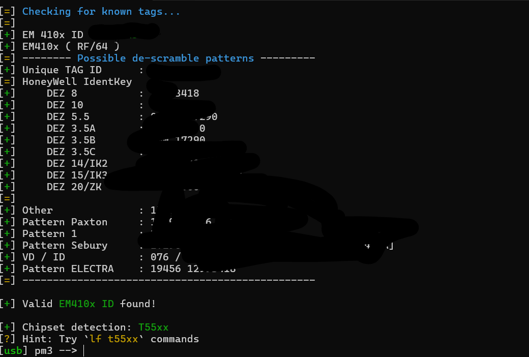

successfully wrote my works RFID tag to my next implant in my hand!
