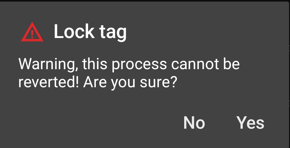

I will admit that my knowledge in the subject is limited however if I am not mistaken, you should be able to use something like an NTAG216 to write the web address too and then lock it to read only after. Don’t quote me.

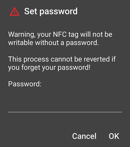

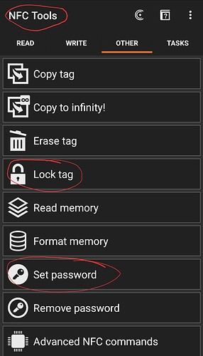

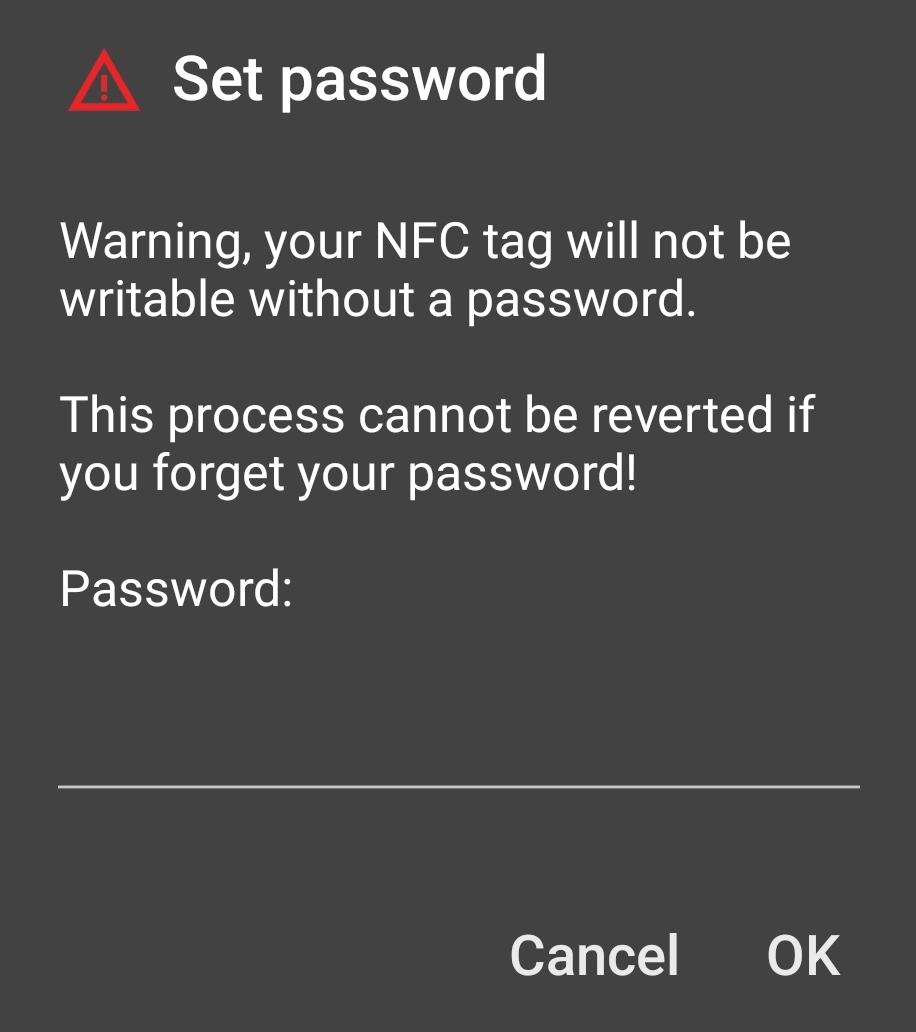

If you have a spare I would write the web address to the tag and then with NFC tools, lock the tag once you verify that it is working as you wish. After that try to crack it
