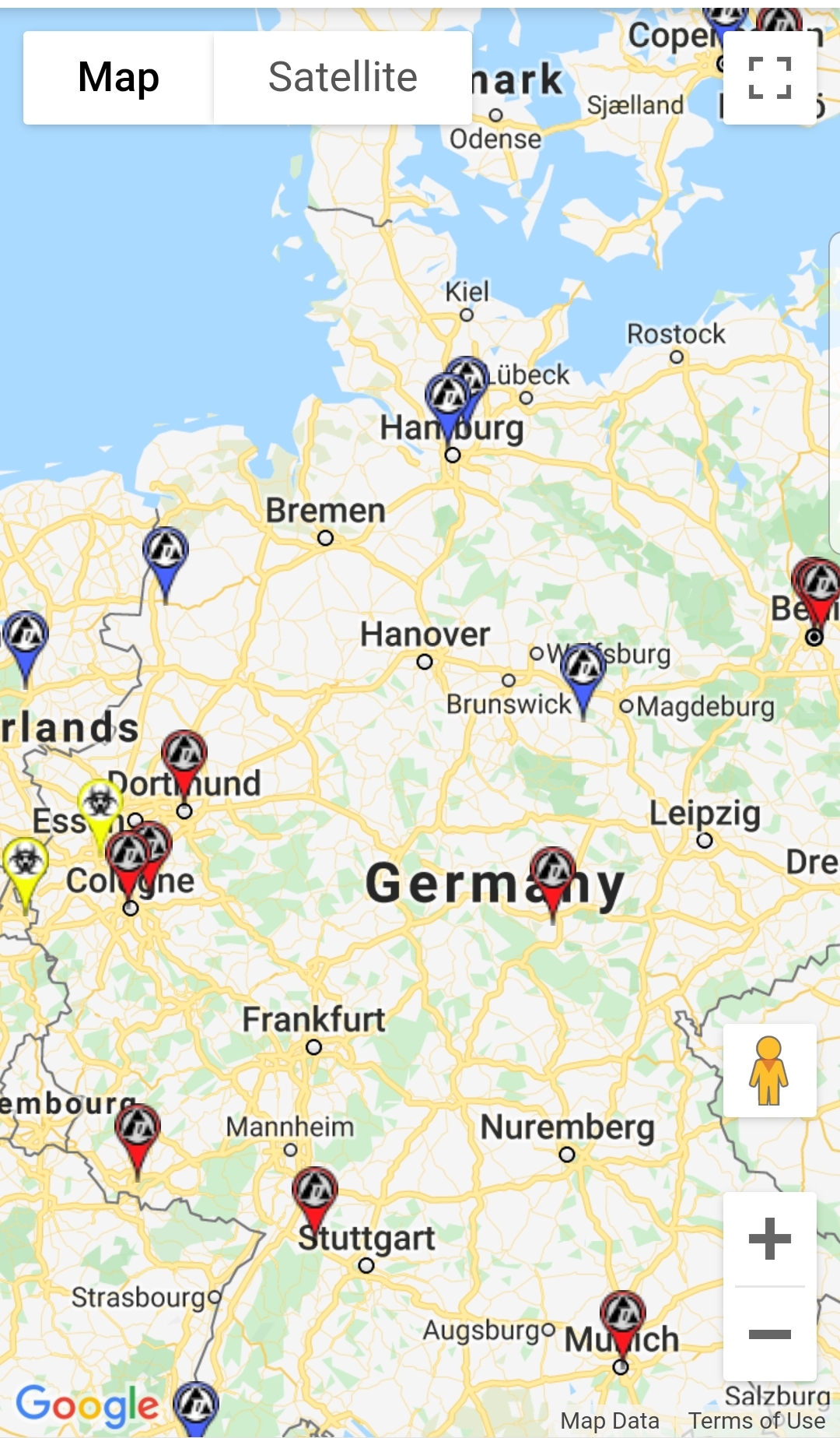

Have you looked at getting yourselves on the Partners map
I see you are in Hanover but not listed
No we are not listed on this list yet.
We are already listed on the Digiwell website.
