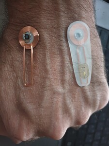

No way you will get 2 flexEMs on one hand.
I should have worded it differently. Yeah they would fit. But I bet you would have problems getting a read.
It would definitely need testing before installing
If they were installed as per the photo above, rotating the wrist about the central axis, there would be around 30° difference when presenting flat to a reader
the other option could be to spin one around 180° with the FlexEM at the knuckle.
All theoretical at the moment.
I have 2 xems about that far, and if I didn’t have a 90° bend it might be problematic
That’s just asking for interference
Nope, I think it will come down to the reader, and then how you approach it.
I just did a test with my proxmark, and it was easy as to get separate reads consistently
The proxmark is a bit anemic though, a more powerful reader might light up both
I have to press my hand into the proxmark to get a read, and I get 2” with the xACv2
The Proxmark was all I had easily available.
I think the approach will be the key
to it.
I will test it on an xAC tomorrow.
Put it this way, I am pretty confident it will work

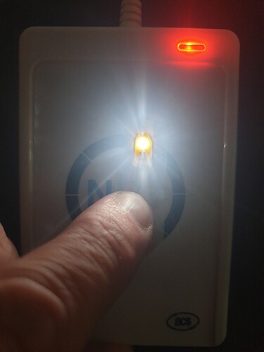

On a decent reader (ACR122U), the NFC nail LED
lying inline/ parallel with the HF antenna is BRIGHT ![]()
Yeah, The camera doesn’t really show the difference very well.
It is a lot brighter

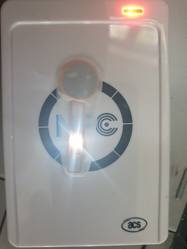

Standby, I’ll do a photo in lower light…

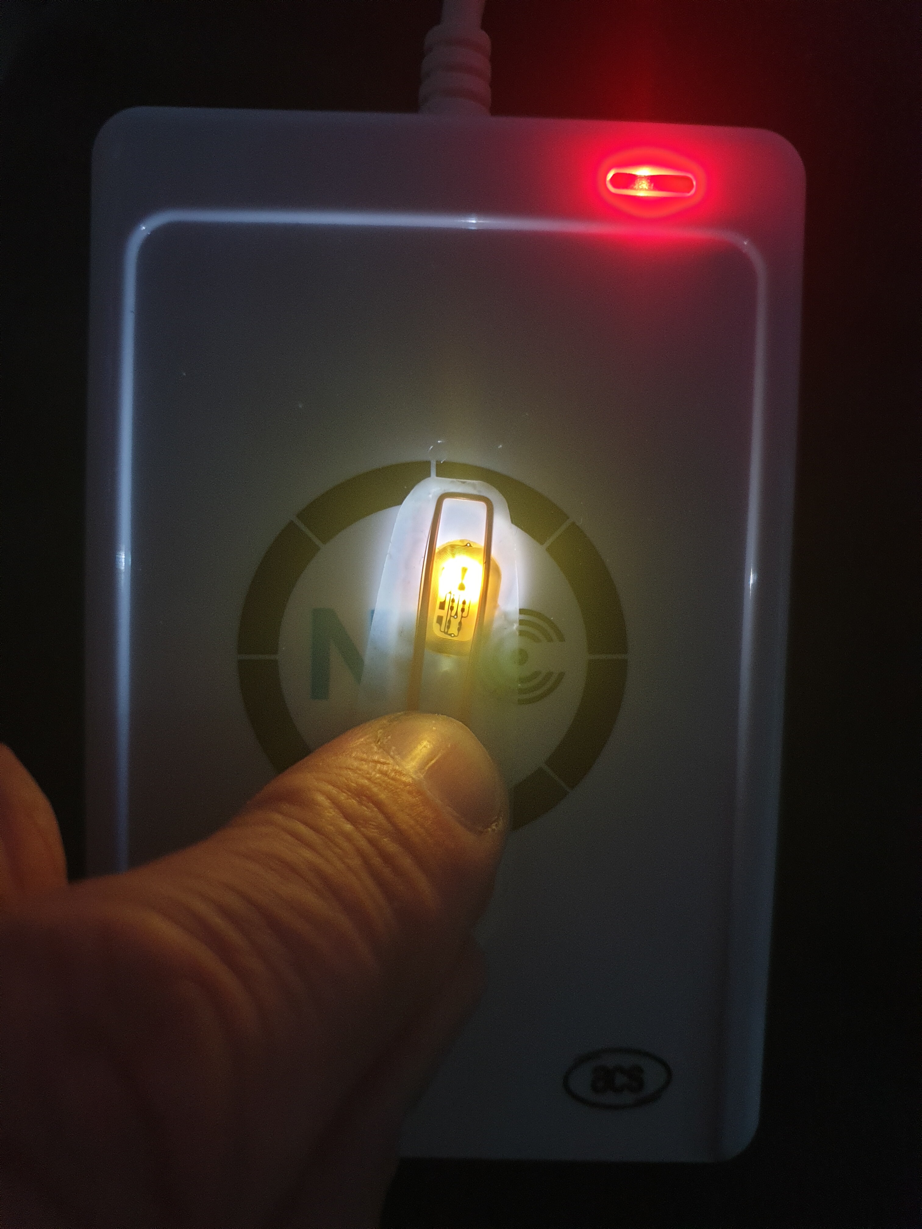

And a diffused view, With the LED down

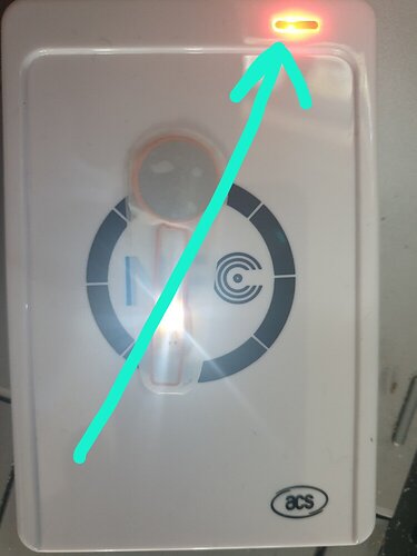

If you’re referring to the LED being red, not green, I think it depends on what driver is being used, on what OS. On my linux install with my current driver, it doesn’t light up at all, even when reading, and when I’ve switched the driver I’m using, I’ve had it stay red. On windows, it turns red when plugged in, and green when activated by software.
Apparently you can send the ACR122U commands to set the 2-color LED to whatever you want.
Boom, @darthdomo you nailed it
Yeah, I just plugged it in, No software running
The HF Chip is the SLIX ISO15693, so it won’t read on the ACR122U, I am using it just to light up the NFC Nail LED
Ah yeah, forgot you mentioned it was an ISO15693 chip, that clarifies better than my answer.
