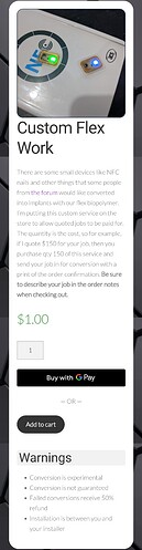

AFAIK the official statement is: blinkies will fail.
If you still order themin a custom service knowing that and explicitly make amal do it gainst his will he’ll prolly include LEDs.
Also the “Warnings” at the bottom of the image below are of relevance.
