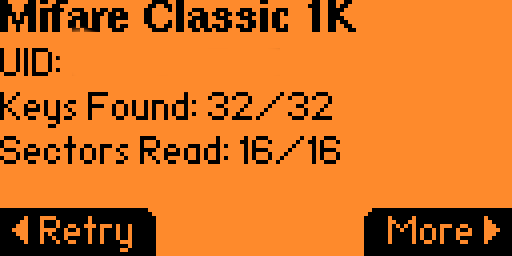

I have a Mifare Classic 1K that I use at work and I’m trying to get the FlipperZero to scan it. It only seems to scan part of the card.
I tried scanning one of the cards I got with the ProxMark3 Easy and it read totally fine.
Looks like there are some keys that are not default keys and thus, the sector will not be readable.
I believe that flipper cannot crack keys itself, but if you have a Proxmark3, you can do hf mf autopwn on it to try and coax the keys out of it.
I don’t have a flippery myself (yet!), but I assume that once you have the keys from the autopwn, you could input them into the flipper and get a full read. (Again, just a hypothesis.)
the flipper can crack the keys you just have to use an alternate method GitHub - equipter/mfkey32v2: Mifare Classic Key Calculator v2

Yoooo that was totally it. Why didnt I think of that?
I used the PM3 and got the missing keys. Added em to my FZ and then boom! Full read.

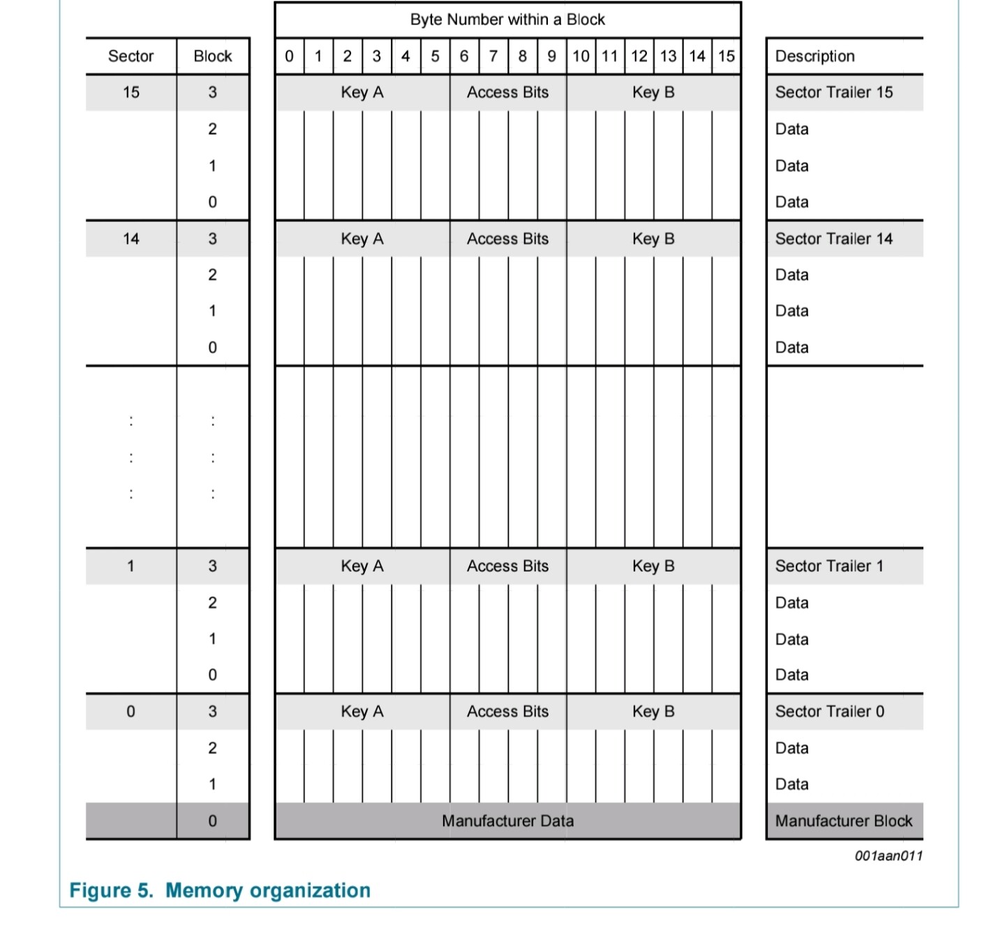

mifare classic comes in many sizes some of which change the format of the datastructure but for this we will be covering mifare classic 1k

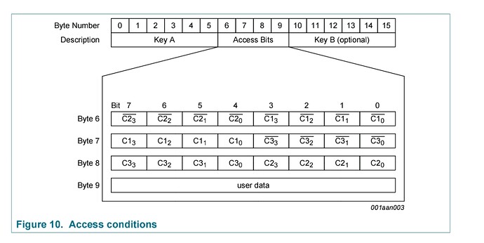

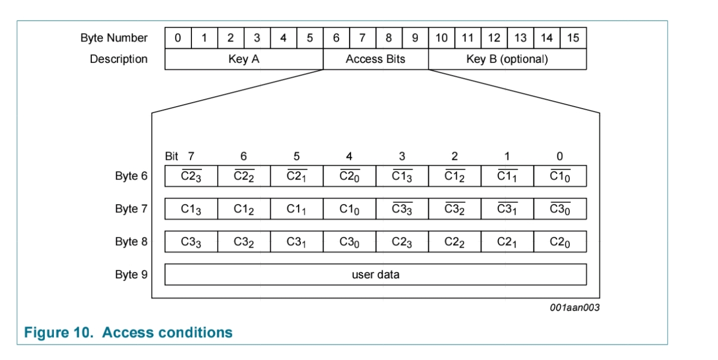

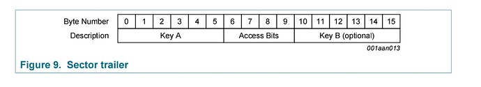

each M1K is split into 64 blocks contained to 16 sectors which are protected by 2 keys (keyA and keyB respectively) and a 3 byte access bits in the middle of the keys.
each sector is 4 blocks big, the first three are data and can be used however the client needs
the final block is those two keys and their access bits.

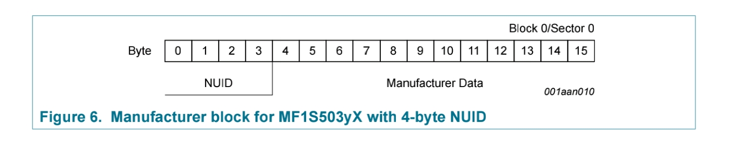

the first block of a mifare classic card is block 0 and contains the uid, ask and atqa and optional manufacture info. this block usually cannot be edited.
there is two keys for every sector for a few reasons, the main being that two keys allows for diversified access, you can change the access bits to be read/write/increase/decrease at either or both keys. it allows for better protection when you need 2 keys instead of one to access as it does eliminate some of the known attacks out there.
mifare classic 1ks contain 720 bytes of usable data, the rest is keys, access bits or the block 0 identification block

i recommend not going through and fully understanding access bit structure and doing calc on the fly
