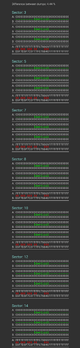

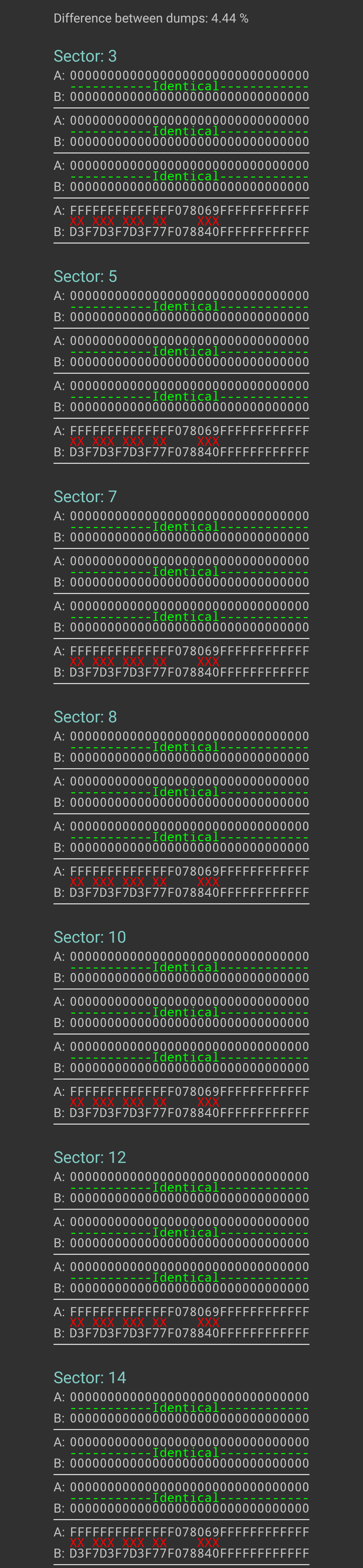

Here’s the MCT results that I had gotten. A belongs to the Magic Gen4 test card I had gotten, the one that works in full. B belongs to the UG4.
My ask is, do you think I can manage around this with the Flipper Zero or is it time to get a Proxmark3 for a resolution? Additionally, I’m not really sure what’s causing this, so I do apologize. :sweat_smile:
I have attempted to wipe the UG4 three times and then did the “Set Default Config” on the Flipper Zero three times as well, no luck. Do you know if I’m limited with the Flipper Zero on this?
By the way, I LOVE my UG4, it’s amazing! I also love the recommendation I requested for in Seattle. :grin:<3

Apologies for the large delay, lots of life happening all at once. Had some time to kinda understand how the Proxmark3 works, but I have some stuff here that doesn’t make sense. Maybe there’s a command to make more sense of it? I would really like some insight please.
For the first two screenshots, I’m using the Magic Gen4 Test Card that I had gotten. It feels natural sending commands and having this card receive them, meaning it will accept commands fully. I am still mostly familiar with the Flipper Zero interface, so used that to wipe both cards and then used the “Set Default Config” setting, which the result is shown in the screenshots. Both cards were sent the following string for Blocks 14 & 16
FFFFFFFFFFFFFF078069FFFFFFFFFFFA
These Two are the Test Card. Nothing seems out of the ordinary except that blocks 14 & 16 were changed with the string I had provided.
These next two are the FlexUG4. Notable differences I found were that 14 & 16 did receive the string, but blocks 15 & 19 ended up changing. I don’t quite understand why since I didn’t send commands to those blocks.
The last confusing one is when I sent a command to block 23, one of the ones that seem a bit odd and nothing changed.

All the blocks with the missing bytes in the middle like 15 and 19 are sector control blocks that contain key A, key B, and access control bits for the sector they are in. Each sector has three blocks of data and one block of access control data which dictate how the data in that sector can be accessed.
Sending data to these blocks to write / change them may require authentication first, depending on the access bit settings for that sector. In other words, you may need to authenticate before you can change authentication data like keys or access bits.
When it comes to magic cards, gen1a cards use a “back door” command to open all blocks in all sectors to write access, regardless of access bit settings. When it comes to Gen2 cards, they emulate Mifare chips pretty well, so if the access bits dictate auth is needed in order to change a block (even itself), then you must auth first using key A or B, depending on which key has write access.
To be fair, I’m not sure how gsetblk works… if it works around these emulation behaviors or not… but I would imagine setting the sector trailer block (the block with keys and access bits) might require something a little different from setting a regular memory storage block.
TL;DR Did a lot of shit and got it to almost work how I want it to. Block 0, Sector 0 is not writing with the Flipper, giving errors on Proxmark since it’s the
manufacturer block.
What you had said definitely helped because I was able to write to the blocks using the keys but in a different way than anticipated.
I will be totally honest with you and state that I really kinda just winged it and used ChatGPT for assistance since I’m still not too familiar with the commands.
