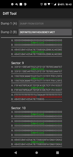

Well, I played around with it again and managed to read my keyfob again. I copied it again and the only differences are on sector 9 block 4 and sector 11 blocks 1 and 2. I’m not too sure why the copy isn’t perfect. Anyway now I get the exact opposite behavior :sweat_smile:
Every time I copy there’s a couple random bytes that do not correspond to the original
I ment sector keys in MCT if you are referring to the last part. Sometimes it maps everything fine and sometimes it doesn’t.
Ok I tried with a brand new sticker and got everything copied fine except for this:
