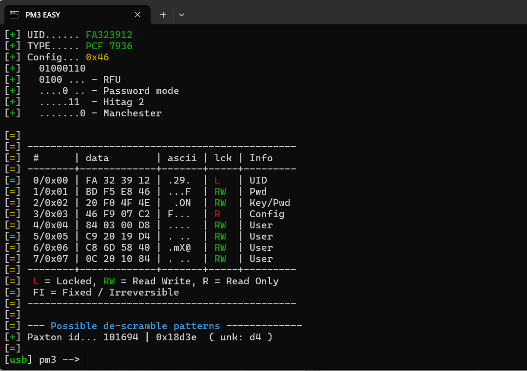

Can anyone share a screenshot of the GDX Indigo reading?
What PCF7936 pages are in use?
lf hitag read --ht2 -k BDF5E846
Something like this:

I don’t know, I don’t understand. Nobody has a GDX fob? Maybe it’s not worth helping?
Seriously, no one has a GDX fob?
I have a decent selection of cards, fobs and implants, but I do not have GDX; which, FYI falls under the PAC umbrella I believe
GDX Indigo uses similar fobs to Paxton. Bullets fobs with PCF7936.
