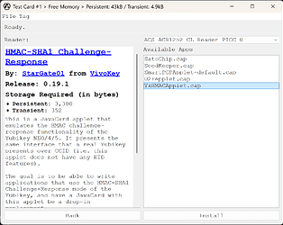

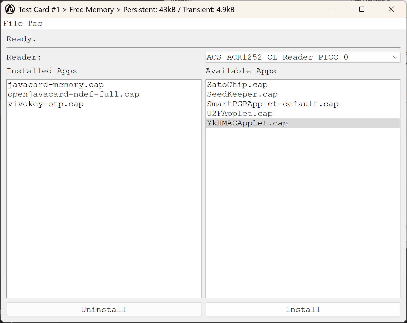

The flexSecure is a lot of work. What apps are available? What the heck is even installed on it? How much space do I have? And it goes on. So I made a thing.
It comes with all the usual warnings: use at your own risk etc. It’s still pretty early in development so it may crash on your–sorry. Next phase is a maintainability refactor. But first, it would be good to see if people think it’s useful or have any input about it as it stands.
Features:
  • Lists the (supported) available apps in the latest release
  • Can install (it will download, install, then remove the cap file) and uninstall
  • Can create initial records for the NDEF app
  • Allows you to name transponders (this is stored locally)
  • Allows you to change the master key (this is stored locally)
  • Tracks whether tags are known (to keep you from sending default keys to those without one)
  • Supports adding other resources as ‘plugins’ (ie, other repos with cap files or even just to decode names)
Anything remotely serious is encrypted. Key management is handled by keyring. If you have GPG installed, you can use the smartpgp applet to wrap the secure storage instead. I am tempted to add SeedKeeper support as well.
Want to give it a go? Windows binary
Github Repo

I got my 2 new DT Java cards today, and rather than my previous rigmorale of set up, I simply plugged in my ACR122U, Ran the Global platform GUI
I was done in minutes.
