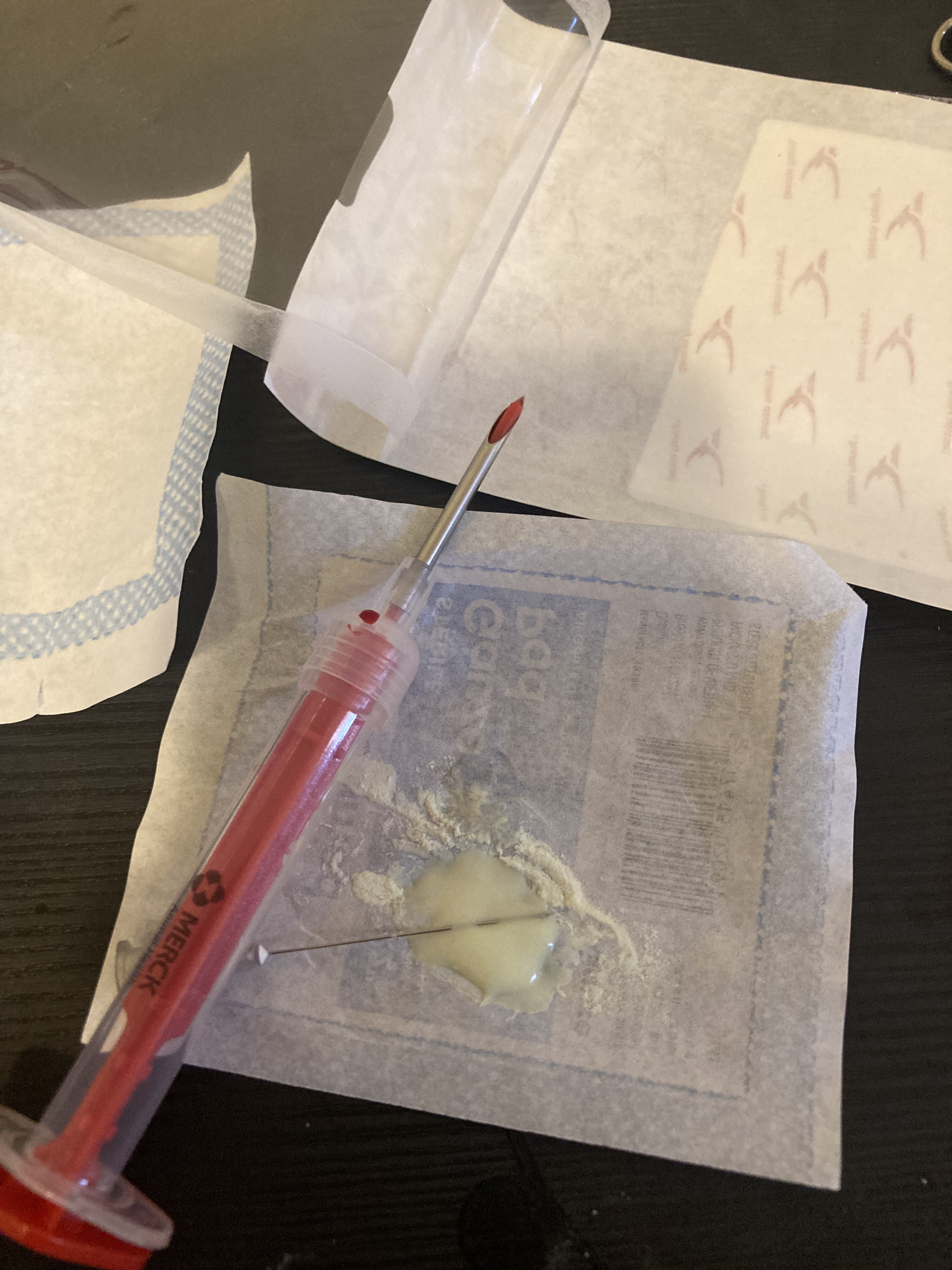

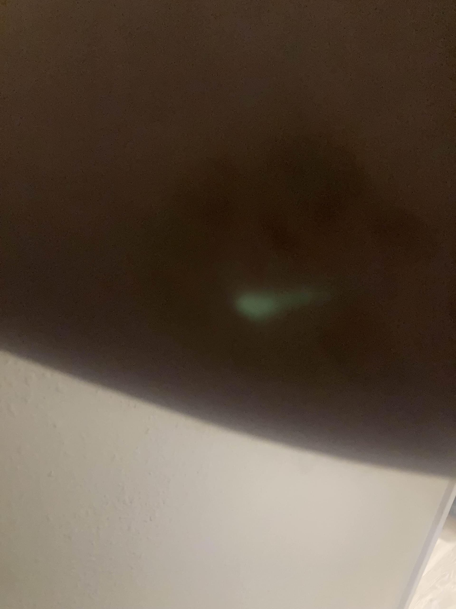

This was me! For anyone curious, I used a mixture of glow powder and sterile lube, scooped into the end of the injector with a spare needle before implanting. I didn’t take any pictures until afterward, but this shows the glow powder mixture.
Okay that’s way more involved than my intent. I was going to install the implant, remove the needle, then pack the needle hole with powder before bandaging up.

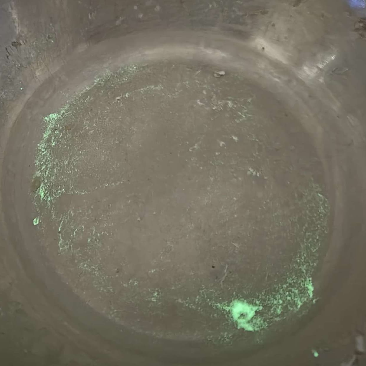

It’s definitely important to wash and filter… there are some intermediate sized particles but a lot more smaller particles than I thought would be the case.
This is one of the intermediate filters…

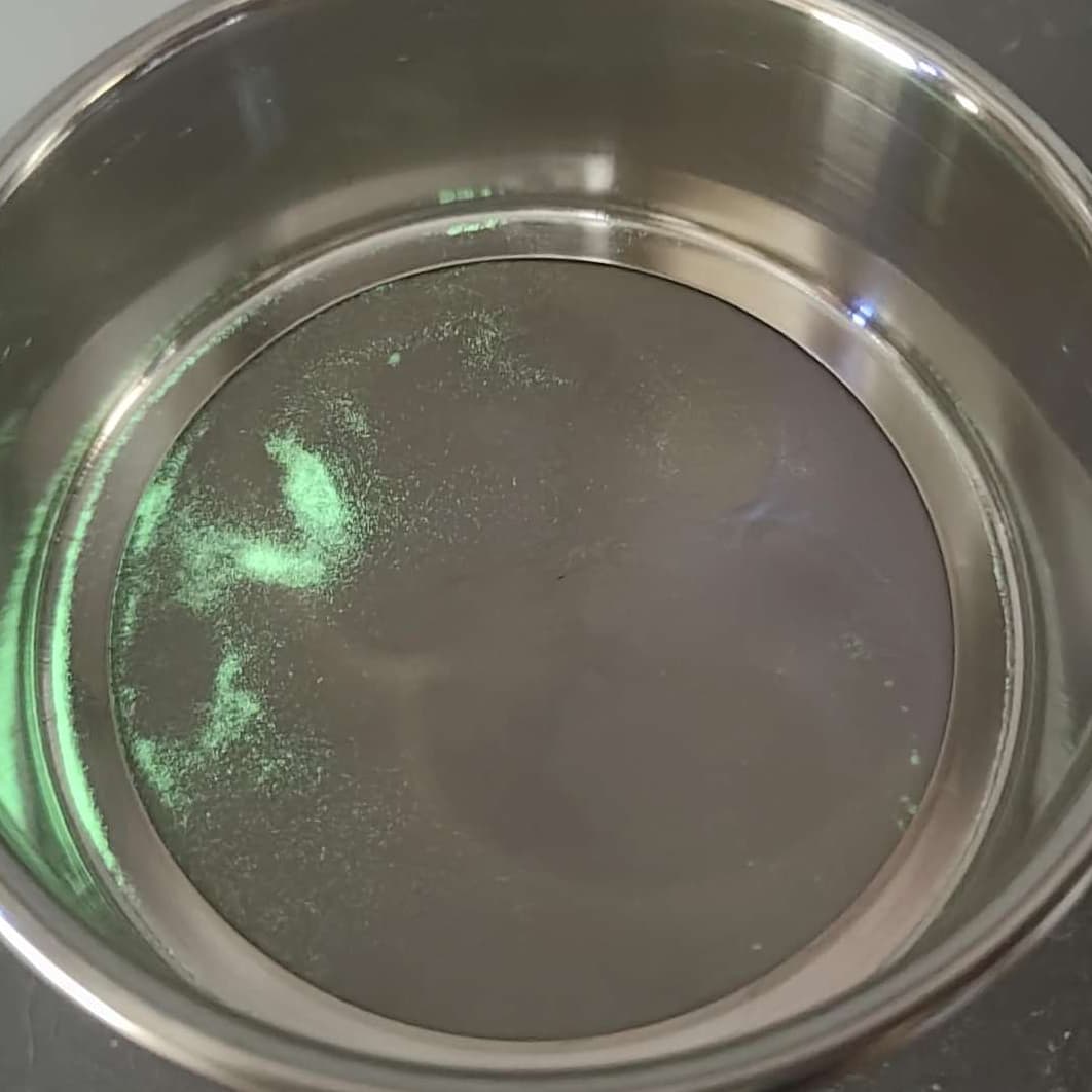

This is the final catch basin after all the filter stages…
The only reason we bothered with intermediate filters is to see the distribution of particle sizes in the manufacturer’s “50 micron” supply. It appears they allow a significant amount of tolerance. This would be fine for their intended application, but not for biohackers.
