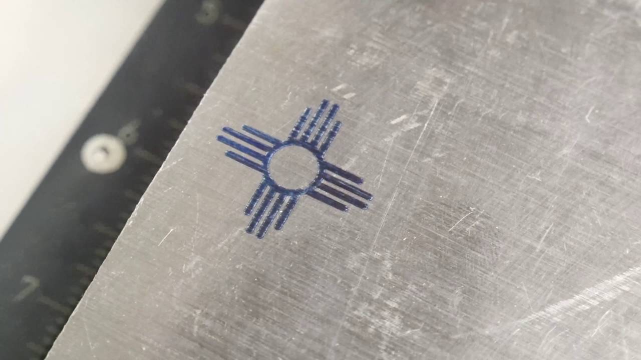

Pretty sure all of the beam just bounces off. Amal calling it an expensive cleaner is probably right, it’s just removing oxidation/dirt/whatever chemicals they cleaned it with. The focal point on a CO2 is huge compared to a fiber laser. Going by the Epilog I use, spot size is 0.003", Glowforge 0.008”. Epilog’s fiber spot size is 0.00034".
Of course the picture with the Titan’s “ablated surface” is confusing the hell out of me. What material was it removing??
Typically yes… except for titanium apparently.

I really wish these laser cutters were better at positioning… I was looking forward to my engraved magnet ![]()
I was looking forward to one also. I would rather it have as much magnetism as possible though also. Looking less possible now, but I am okay with that.
