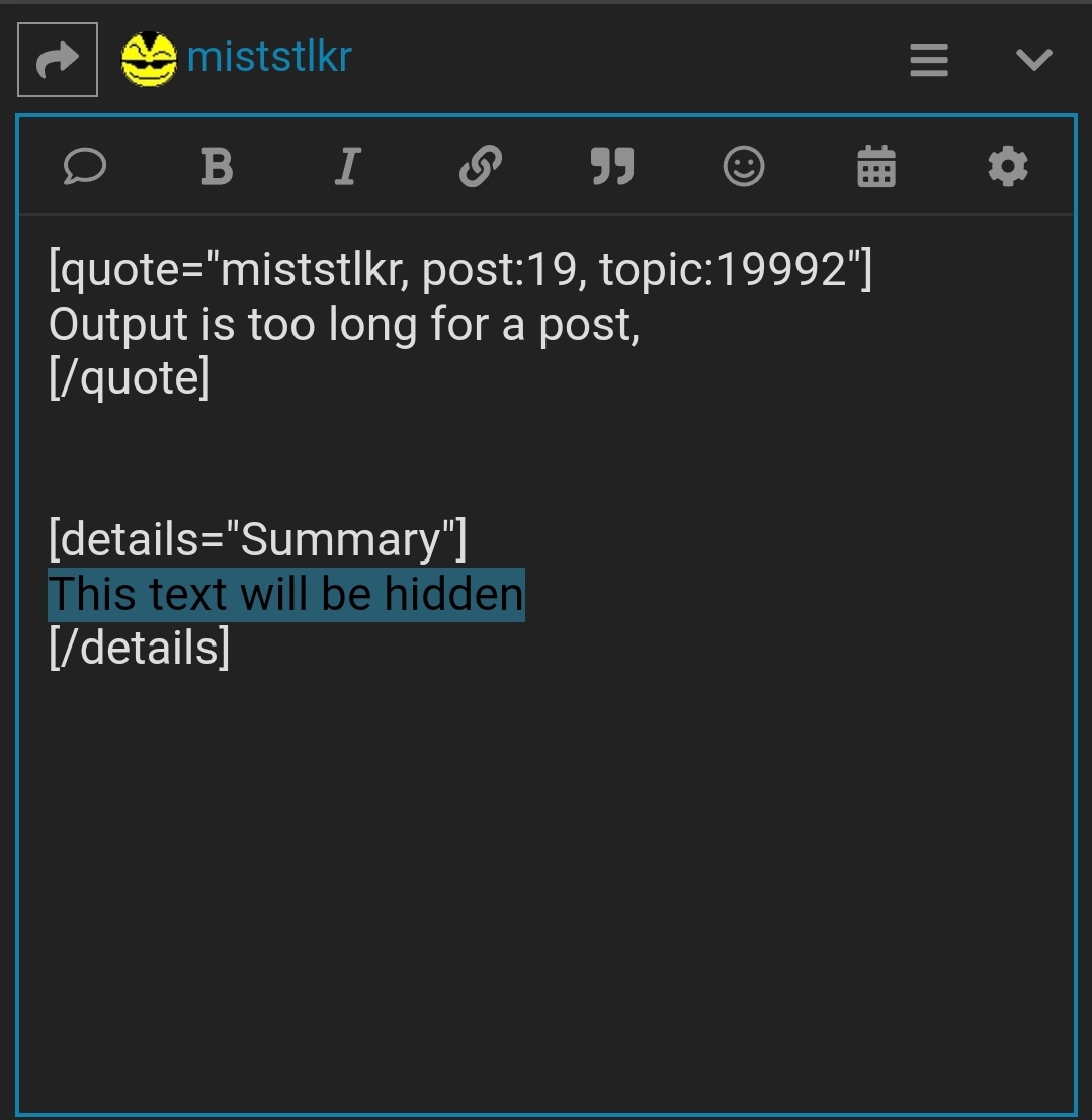

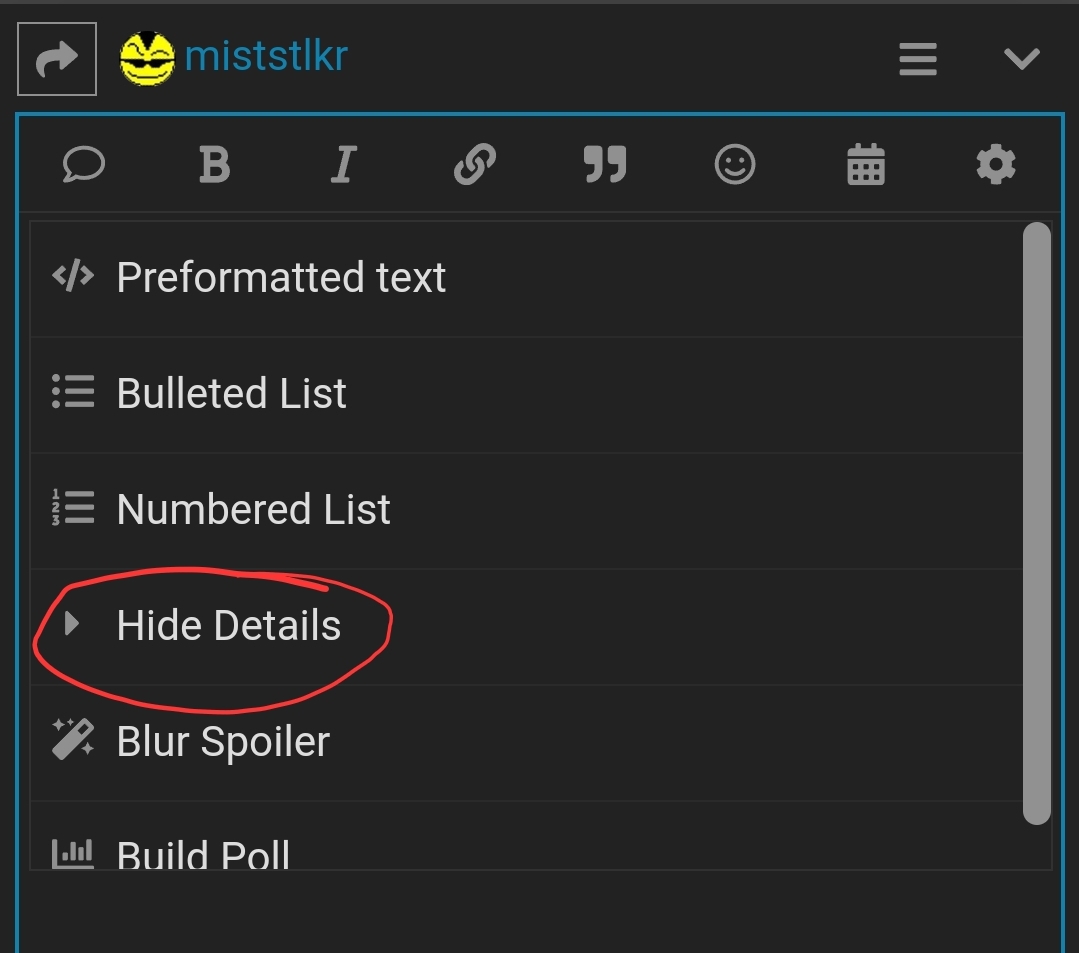

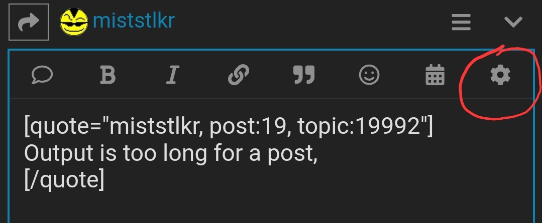

Ah, I got a message that the character limit was exceeded.

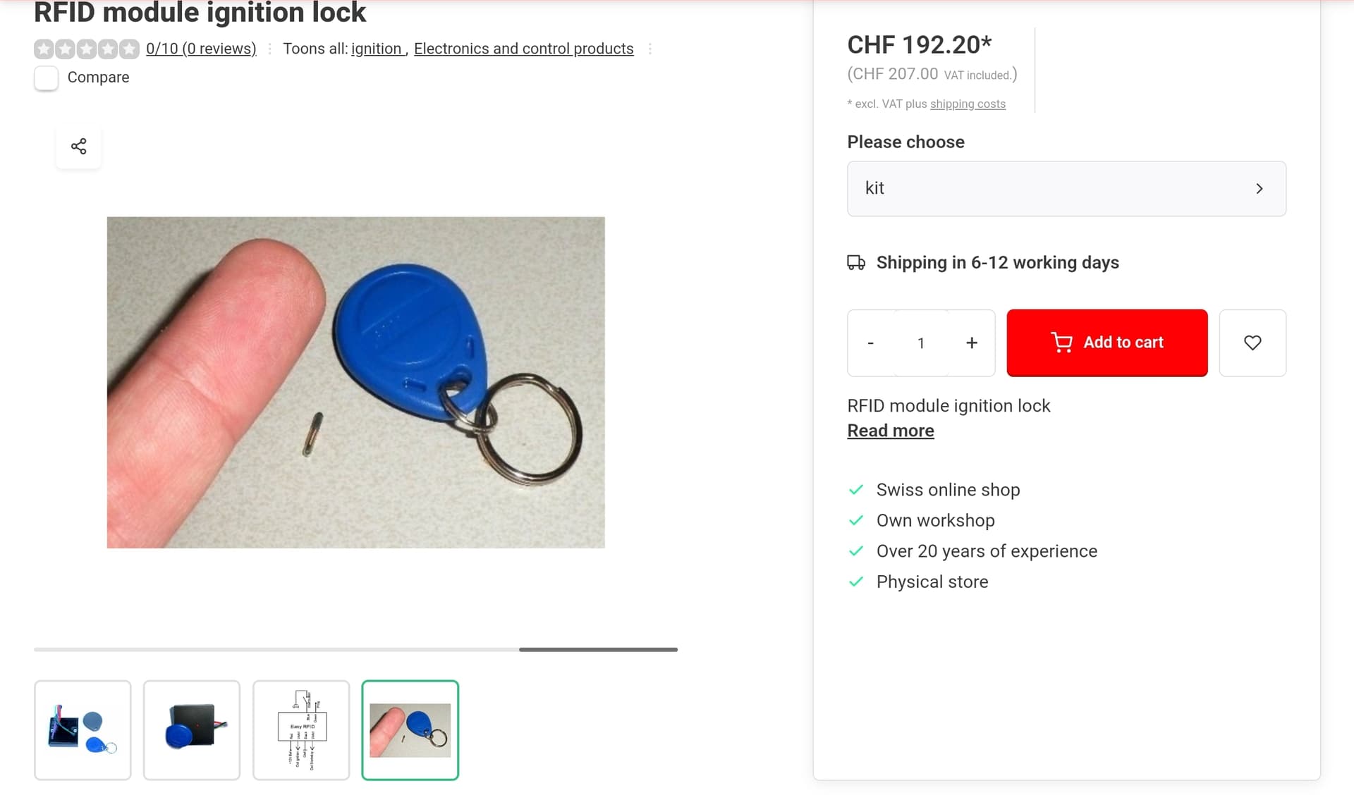

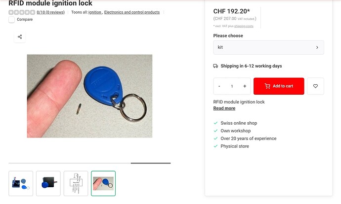

Easyer solution would be to use something like this
Yeah, until someone cracks the molock validation algorithm, it’s not something we can clone (yet?)
Do you have one of these modules?
Also, Interesting product image
Have one ordered should arrive next week, i give feedback.
