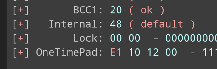

[usb] pm3 --> hf mfu info
[=] --- Tag Information --------------------------
[+]       TYPE: NTAG 213 144bytes (NT2H1311G0DU)
[+]        UID: 04 DC 63 1A BA 10 90
[+]     UID[0]: 04, NXP Semiconductors Germany
[+]       BCC0: 33 ( ok )
[+]       BCC1: 20 ( ok )
[+]   Internal: 48 ( default )
[+]       Lock: 00 00  - 0000000000000000
[+] OneTimePad: E1 10 12 00  - 11100001000100000001001000000000
[=] --- NDEF Message
[+] Capability Container: E1 10 12 00
[+]   E1: NDEF Magic Number
[+]   10: version 0.1 supported by tag
[+]        : Read access granted without any security / Write access granted without any security
[+]   12: Physical Memory Size: 144 bytes
[+]   12: NDEF Memory Size: 144 bytes
[+]   00: Additional feature information
[+]   00000000
[+]   xxx..... - 00: RFU ( ok )
[+]   ...x.... - 00: don't support special frame
[+]   ....x... - 00: don't support lock block
[+]   .....xx. - 00: RFU ( ok )
[+]   .......x - 00: IC don't support multiple block reads

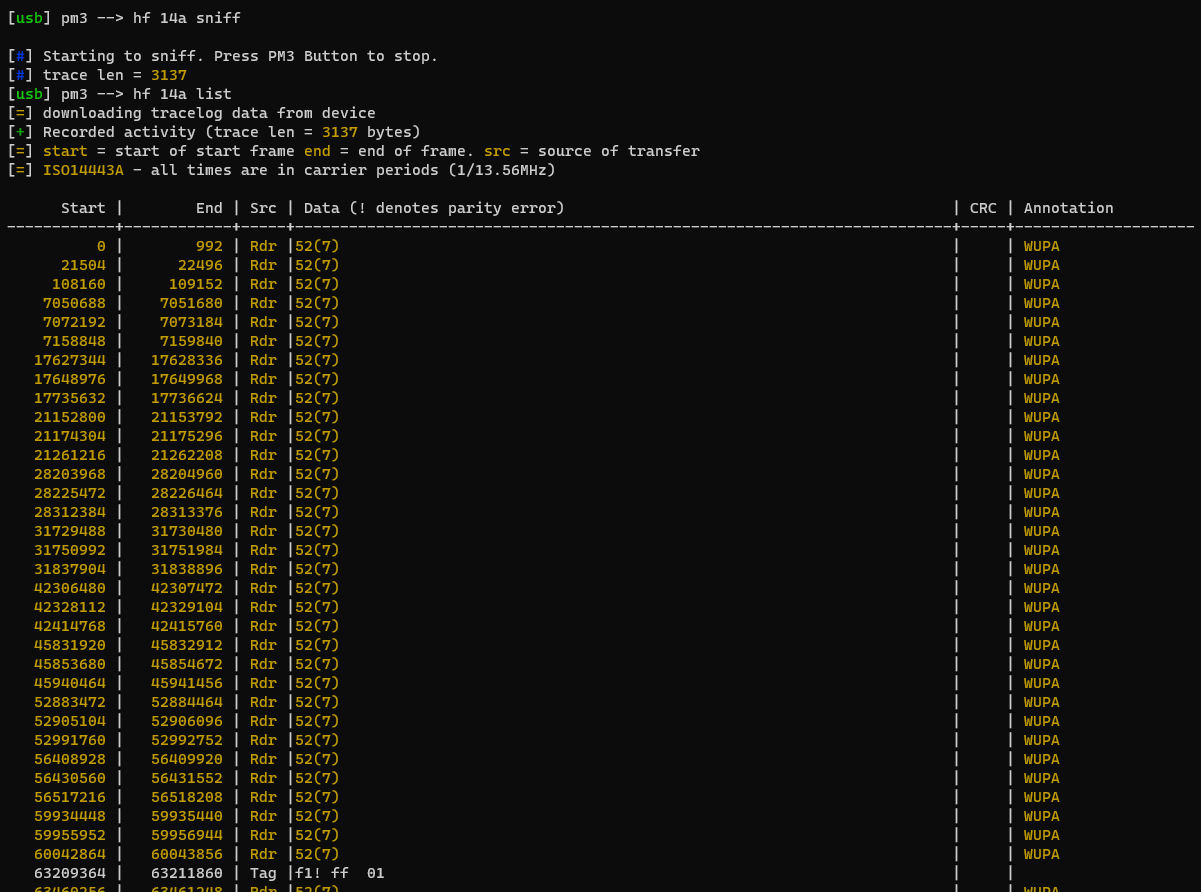

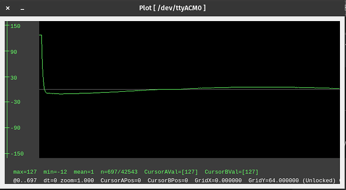

Sniffing isn’t something I have much experience with, but here’s the data from an hf sniff when I tap the device on:
ah… sorry you want the ISO14443A sniff;
hf 14a sniff

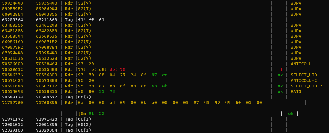

I was wondering what you could possibly see in that data that I didn’t, but figured you’re the king… LOL I’ll get that for you this afternoon.
two on/off cycles (four taps)

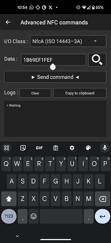

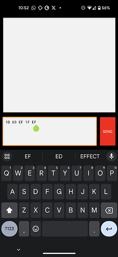

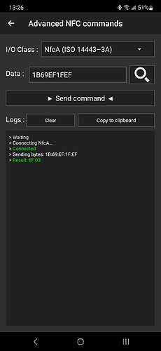

Looks like it’s checking for a password, I think?
I really hope you solve this. I got my bike back yesterday after the crash repairs and an nfc ignition is way up at the top of my wish list. I want to be a cyborg centaur!
Yeah it looks like password checks… but I don’t see any tag data. How are you sniffing? The proxmark3 hf antenna should be right up against the reader and the tag should be right up against the proxmark3. You could tape the tag to the pm3 and present the whole thing to the reader at the same time while sniffing.
So… the question is… did they use the same password for every fob or did they use a derivation system based on the UID… if they used the derivation system you would get a different password for a different tag.

ON:
[usb] pm3 --> hf 14a list
[=] downloading tracelog data from device
[+] Recorded activity (trace len = 560 bytes)
[=] start = start of start frame end = end of frame. src = source of transfer
[=] ISO14443A - all times are in carrier periods (1/13.56MHz)
      Start |        End | Src | Data (! denotes parity error)                                           | CRC | Annotation
          0 |       1056 | Rdr |26(7)                                                                    |     | REQA
       2228 |       4596 | Tag |44  00                                                                   |     |
      30768 |      35536 | Rdr |50  00  57  cd                                                           |  ok | HALT
     202656 |     203648 | Rdr |52(7)                                                                    |     | WUPA
     204884 |     207252 | Tag |44  00                                                                   |     |
     243264 |     245728 | Rdr |93  20                                                                   |     | ANTICOLL
     246916 |     252740 | Tag |88  04  dc  63  33                                                       |     |
     297968 |     308432 | Rdr |93  70  88  04  dc  63  33  8c  1d                                       |  ok | SELECT_UID
     309684 |     313204 | Tag |04  da  17                                                               |  ok |
     346080 |     348544 | Rdr |95  20                                                                   |     | ANTICOLL-2
     349716 |     355604 | Tag |1a  ba  10  90  20                                                       |     |
     400784 |     411312 | Rdr |95  70  1a  ba  10  90  20  41  79                                       |  ok | SELECT_UID-2
     412500 |     416084 | Tag |00  fe  51                                                               |  ok |
     490016 |     494784 | Rdr |30  00  02  a8                                                           |  ok | READBLOCK(0)
     553300 |     574100 | Tag |04  dc  63  33  1a  ba  10  90  20  48  00  00  e1  10  12  00  89  5c   |  ok |
     607600 |     612304 | Rdr |30  04  26  ee                                                           |  ok | READBLOCK(4)
     613540 |     634404 | Tag |6d  6f  74  6f  67  61  64  67  65  74  2d  6b  65  79  30  30  6a  04   |  ok |
     663808 |     672032 | Rdr |1b  fb  78  7d  d0  ef  94                                               |  ok | PWD-AUTH KEY: 0xFB787DD0
     673204 |     677876 | Tag |4c  02  74  d2                                                           |  ok |
    6205216 |    6206272 | Rdr |26(7)                                                                    |     | REQA
    6207444 |    6209812 | Tag |44  00                                                                   |     |
    6236000 |    6240768 | Rdr |50  00  57  cd                                                           |  ok | HALT
    6407632 |    6408624 | Rdr |52(7)                                                                    |     | WUPA
    6409860 |    6412228 | Tag |44  00                                                                   |     |
    6448112 |    6450576 | Rdr |93  20                                                                   |     | ANTICOLL
    6451764 |    6457588 | Tag |88  04  dc  63  33                                                       |     |
    6502688 |    6513152 | Rdr |93  70  88  04  dc  63  33  8c  1d                                       |  ok | SELECT_UID
    6514388 |    6517908 | Tag |04  da  17                                                               |  ok |
    6550624 |    6553088 | Rdr |95  20                                                                   |     | ANTICOLL-2
    6554276 |    6560164 | Tag |1a  ba  10  90  20                                                       |     |
    6605200 |    6615728 | Rdr |95  70  1a  ba  10  90  20  41  79                                       |  ok | SELECT_UID-2
    6616900 |    6620484 | Tag |00  fe  51                                                               |  ok |
    6693872 |    6698640 | Rdr |30  00  02  a8                                                           |  ok | READBLOCK(0)
    6757172 |    6777972 | Tag |04  dc  63  33  1a  ba  10  90  20  48  00  00  e1  10  12  00  89  5c   |  ok |
    6811376 |    6816080 | Rdr |30  04  26  ee                                                           |  ok | READBLOCK(4)
    6817332 |    6838196 | Tag |6d  6f  74  6f  67  61  64  67  65  74  2d  6b  65  79  30  30  6a  04   |  ok |
    6867600 |    6875824 | Rdr |1b  fb  78  7d  d0  ef  94                                               |  ok | PWD-AUTH KEY: 0xFB787DD0
    6876996 |    6881668 | Tag |4c  02  74  d2                                                           |  ok |
OFF:
[+] Recorded activity (trace len = 280 bytes)
       2244 |       4612 | Tag |44  00                                                                   |     |
      30752 |      35520 | Rdr |50  00  57  cd                                                           |  ok | HALT
     202880 |     203872 | Rdr |52(7)                                                                    |     | WUPA
     205124 |     207492 | Tag |44  00                                                                   |     |
     243376 |     245840 | Rdr |93  20                                                                   |     | ANTICOLL
     247028 |     252852 | Tag |88  04  dc  63  33                                                       |     |
     297936 |     308400 | Rdr |93  70  88  04  dc  63  33  8c  1d                                       |  ok | SELECT_UID
     309652 |     313172 | Tag |04  da  17                                                               |  ok |
     345888 |     348352 | Rdr |95  20                                                                   |     | ANTICOLL-2
     349540 |     355428 | Tag |1a  ba  10  90  20                                                       |     |
     400448 |     410976 | Rdr |95  70  1a  ba  10  90  20  41  79                                       |  ok | SELECT_UID-2
     412164 |     415748 | Tag |00  fe  51                                                               |  ok |
     489152 |     493920 | Rdr |30  00  02  a8                                                           |  ok | READBLOCK(0)
     552436 |     573236 | Tag |04  dc  63  33  1a  ba  10  90  20  48  00  00  e1  10  12  00  89  5c   |  ok |
     606656 |     611360 | Rdr |30  04  26  ee                                                           |  ok | READBLOCK(4)
     612612 |     633476 | Tag |6d  6f  74  6f  67  61  64  67  65  74  2d  6b  65  79  30  30  6a  04   |  ok |
     662864 |     671088 | Rdr |1b  fb  78  7d  d0  ef  94                                               |  ok | PWD-AUTH KEY: 0xFB787DD0
     672276 |     676948 | Tag |4c  02  74  d2                                                           |  ok |
and here is Tag 2:
[usb] pm3 --> hf search
 🕓  Searching for ISO14443-A tag...
[+]  UID: 04 5D EA 6A BA 10 90
[+] ATQA: 00 44
[+]  SAK: 00 [2]
[+] MANUFACTURER: NXP Semiconductors Germany
[+] Possible types:
[+]    MIFARE Ultralight
[+]    MIFARE Ultralight C
[+]    MIFARE Ultralight EV1
[+]    MIFARE Ultralight Nano
[+]    MIFARE Hospitality
[+]    NTAG 2xx
[=] proprietary non iso14443-4 card found, RATS not supported
[?] Hint: try `hf mfu info`
[+] Valid ISO 14443-A tag found
ON:
     202448 |     203440 | Rdr |52(7)                                                                    |     | WUPA
     204676 |     207044 | Tag |44  00                                                                   |     |
     243040 |     245504 | Rdr |93  20                                                                   |     | ANTICOLL
     246692 |     252580 | Tag |88  04  5d  ea  3b                                                       |     |
     297712 |     308176 | Rdr |93  70  88  04  5d  ea  3b  20  9c                                       |  ok | SELECT_UID
     309412 |     312932 | Tag |04  da  17                                                               |  ok |
     345760 |     348224 | Rdr |95  20                                                                   |     | ANTICOLL-2
     349396 |     355220 | Tag |6a  ba  10  90  50                                                       |     |
     400400 |     410928 | Rdr |95  70  6a  ba  10  90  50  35  1f                                       |  ok | SELECT_UID-2
     412116 |     415700 | Tag |00  fe  51                                                               |  ok |
     489488 |     494256 | Rdr |30  00  02  a8                                                           |  ok | READBLOCK(0)
     552788 |     573588 | Tag |04  5d  ea  3b  6a  ba  10  90  50  48  00  00  e1  10  12  00  98  f0   |  ok |
     606928 |     611632 | Rdr |30  04  26  ee                                                           |  ok | READBLOCK(4)
     612884 |     633748 | Tag |6d  6f  74  6f  67  61  64  67  65  74  2d  6b  65  79  30  30  6a  04   |  ok |
     663088 |     671312 | Rdr |1b  69  ef  1f  ef  bb  d9                                               |  ok | PWD-AUTH KEY: 0x69EF1FEF
     672484 |     677156 | Tag |6f  03  a6  ca                                                           |  ok |
    6190256 |    6191312 | Rdr |26(7)                                                                    |     | REQA
    6192484 |    6194852 | Tag |44  00                                                                   |     |
    6220992 |    6225760 | Rdr |50  00  57  cd                                                           |  ok | HALT
    6393056 |    6394048 | Rdr |52(7)                                                                    |     | WUPA
    6395300 |    6397668 | Tag |44  00                                                                   |     |
    6433536 |    6436000 | Rdr |93  20                                                                   |     | ANTICOLL
    6437188 |    6443076 | Tag |88  04  5d  ea  3b                                                       |     |
    6488080 |    6498544 | Rdr |93  70  88  04  5d  ea  3b  20  9c                                       |  ok | SELECT_UID
    6499796 |    6503316 | Tag |04  da  17                                                               |  ok |
    6536000 |    6538464 | Rdr |95  20                                                                   |     | ANTICOLL-2
    6539652 |    6545476 | Tag |6a  ba  10  90  50                                                       |     |
    6590544 |    6601072 | Rdr |95  70  6a  ba  10  90  50  35  1f                                       |  ok | SELECT_UID-2
    6602244 |    6605828 | Tag |00  fe  51                                                               |  ok |
    6679184 |    6683952 | Rdr |30  00  02  a8                                                           |  ok | READBLOCK(0)
    6742468 |    6763268 | Tag |04  5d  ea  3b  6a  ba  10  90  50  48  00  00  e1  10  12  00  98  f0   |  ok |
    6796656 |    6801360 | Rdr |30  04  26  ee                                                           |  ok | READBLOCK(4)
    6802612 |    6823476 | Tag |6d  6f  74  6f  67  61  64  67  65  74  2d  6b  65  79  30  30  6a  04   |  ok |
    6852816 |    6861040 | Rdr |1b  69  ef  1f  ef  bb  d9                                               |  ok | PWD-AUTH KEY: 0x69EF1FEF
    6862212 |    6866884 | Tag |6f  03  a6  ca                                                           |  ok |
OFF:
      30784 |      35552 | Rdr |50  00  57  cd                                                           |  ok | HALT
     202272 |     203264 | Rdr |52(7)                                                                    |     | WUPA
     204516 |     206884 | Tag |44  00                                                                   |     |
     242720 |     245184 | Rdr |93  20                                                                   |     | ANTICOLL
     246356 |     252244 | Tag |88  04  5d  ea  3b                                                       |     |
     297264 |     307728 | Rdr |93  70  88  04  5d  ea  3b  20  9c                                       |  ok | SELECT_UID
     308964 |     312484 | Tag |04  da  17                                                               |  ok |
     345136 |     347600 | Rdr |95  20                                                                   |     | ANTICOLL-2
     348772 |     354596 | Tag |6a  ba  10  90  50                                                       |     |
     399680 |     410208 | Rdr |95  70  6a  ba  10  90  50  35  1f                                       |  ok | SELECT_UID-2
     411380 |     414964 | Tag |00  fe  51                                                               |  ok |
     488304 |     493072 | Rdr |30  00  02  a8                                                           |  ok | READBLOCK(0)
     551588 |     572388 | Tag |04  5d  ea  3b  6a  ba  10  90  50  48  00  00  e1  10  12  00  98  f0   |  ok |
     605712 |     610416 | Rdr |30  04  26  ee                                                           |  ok | READBLOCK(4)
     611652 |     632516 | Tag |6d  6f  74  6f  67  61  64  67  65  74  2d  6b  65  79  30  30  6a  04   |  ok |
     661888 |     670112 | Rdr |1b  69  ef  1f  ef  bb  d9                                               |  ok | PWD-AUTH KEY: 0x69EF1FEF
     671284 |     675956 | Tag |6f  03  a6  ca                                                           |  ok |
The range on these fobs is really surprising.
So not a fixed pwd. If it’s generated based on the UID, I’m thinking we’d need more than two samples to reverse engineer it… Hopefully you see something I don’t :wink:
Yes it appears to be a derived password. But, don’t think we need to reverse engineer the password. The reader should give us the password during registration of a new chip. This is because it’s clear the registration process is checking for the password during registration, and because the protocol between chip and reader is not encrypted, we get to sniff that password.
However, there is another factor here which is the password acknowledgement passed back on successful password authentication. That appears to be different for each as well. This may be somewhat difficult to derive because it’s what the tag sends back and the reader will not reveal this… and it does appear that each good tag does have a unique ack. The ack is only two bytes though so it may be easy enough to brute force that with a lua script and continuous registration attempts.
To confirm the pwd-ack let’s test fob 2 with NFC shell or NFC tools advanced. Send the command 1B and then the password 69 EF 1F EF
According to the sniff data you should get back an ack value of 6F 03.
Confirmed
Yeah so now the fun starts… either the method for calculating the pwd ack needs to be reverse engineered, or it needs to be brute forced.
To brute force it you may need to create a script that is quite involved. My guess is the script will need to be able to control tag emulation (turn it on and off) and you’ll need to probably screen record as the proxmark3 is running through the registration process and emulating different pwd ack responses (assuming it can do this). At the same time you’ll need to probably have a video feed on the lock to detect different LED patterns for successful registration vs invalid registration… and record audio to hear the tone differences as well.
We’re now stepping firmly outside my comfort zone unfortunately. I’ve never actually made a lua script and I’m not even sure the current proxmark3 firmware can do what’s necessary.
For a one-time thing, I should be able to “just” write a script that can send the ack bytes in sequence until one works, right? All the rest is just to make it automated and repeatable for the future? Let’s say I find the needed ack bytes, how would I teach the NeXT to respond with it?
I have a HuskyLens (computer vision module) currently hooked up to a raspberry Pi… I think I can rig it to watch for a blue light and take a photograph when it detects it… So if the script tried each combo and output it to a display, I could capture the successful bytes… But I’m not sure how I would broadcast the my next ID and bytes.
It’s two bytes… That’s only 10,000 possible combinations give or take two :rofl:. If I manually do one every 10 seconds thats… Erm… two bottles of scotch? 28 hours of active work time… That’s dumb brute force, but… It’s a thing… I guess…
Yeah maybe… I’m not sure if there is a max failure counter in the registration process or not. If not then yeah just go to town on it.
If you can do blue light detection great but I was thinking more simply like obs to record your screen and a webcam zoomed way in on the blue light so it takes up nearly all the screen and put the webcam on your obs scene really big so you can capture the script output and the led status in one video.
Could possibly use post processing to detect when the blue light shows or there may also be some other software like a color picker thing that can do the same detection on the computer and screen cap when it goes blueish. Dunno.
If your pi cam solution can capture the screen output as well in the same photo so you can read which ack worked, that’s fine too
