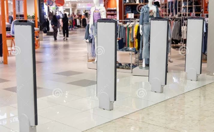

These anti theft gates at the entrance/exits of stores.
I feel like these should be fine, but I’m not sure about the power on those.

I believe most of those are either UHF, or those weird magnetic metal strip things, and neither should impact your implants and definitely haven’t blown up my RDC
I don’t think they use a whole lot of power for those, just the fact that they’re big body-sized antennas
Definitely safe otherwise everyone walking through with an access card in their pocket would have a “fun” surprise :sweat_smile:
