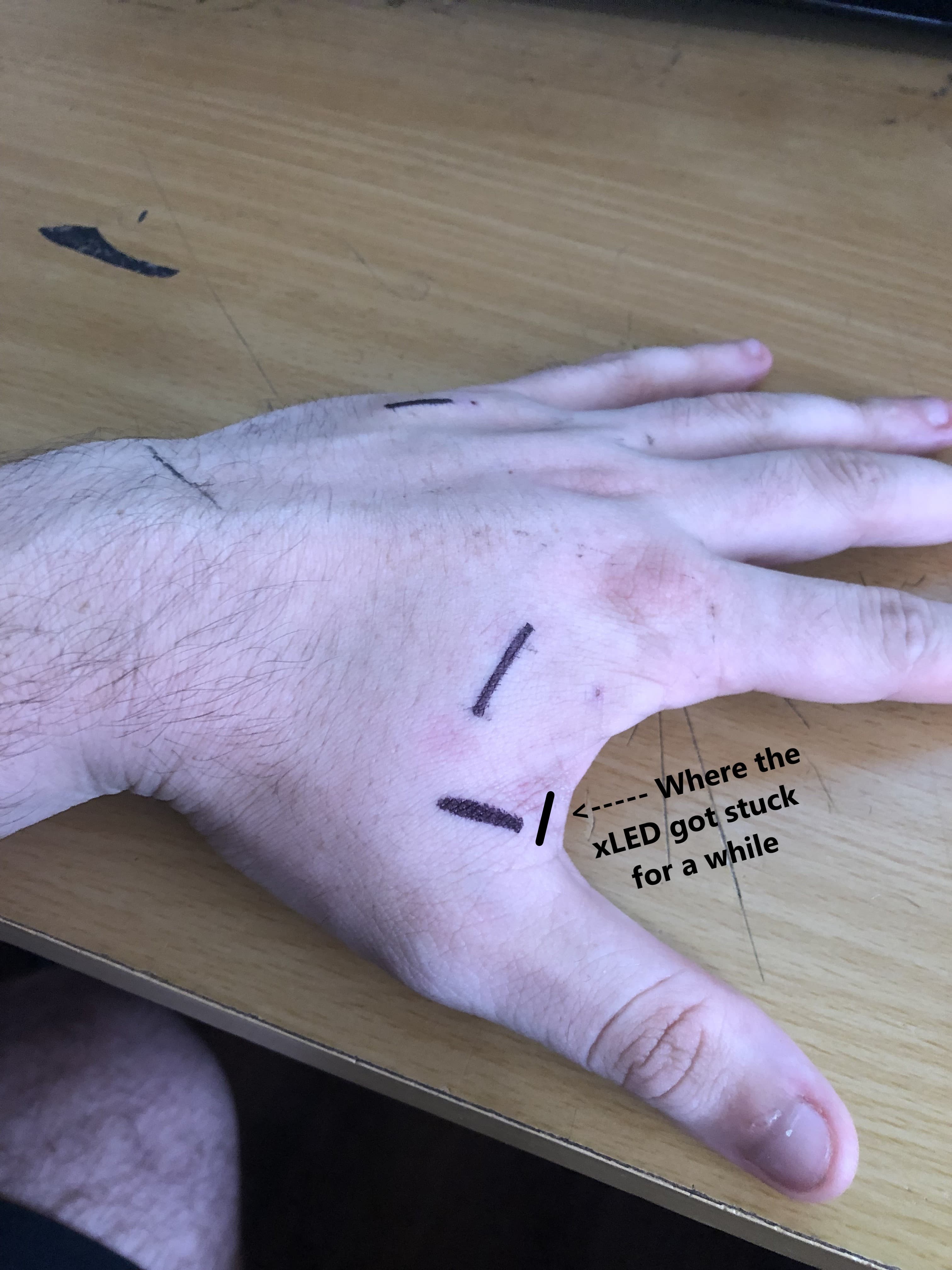

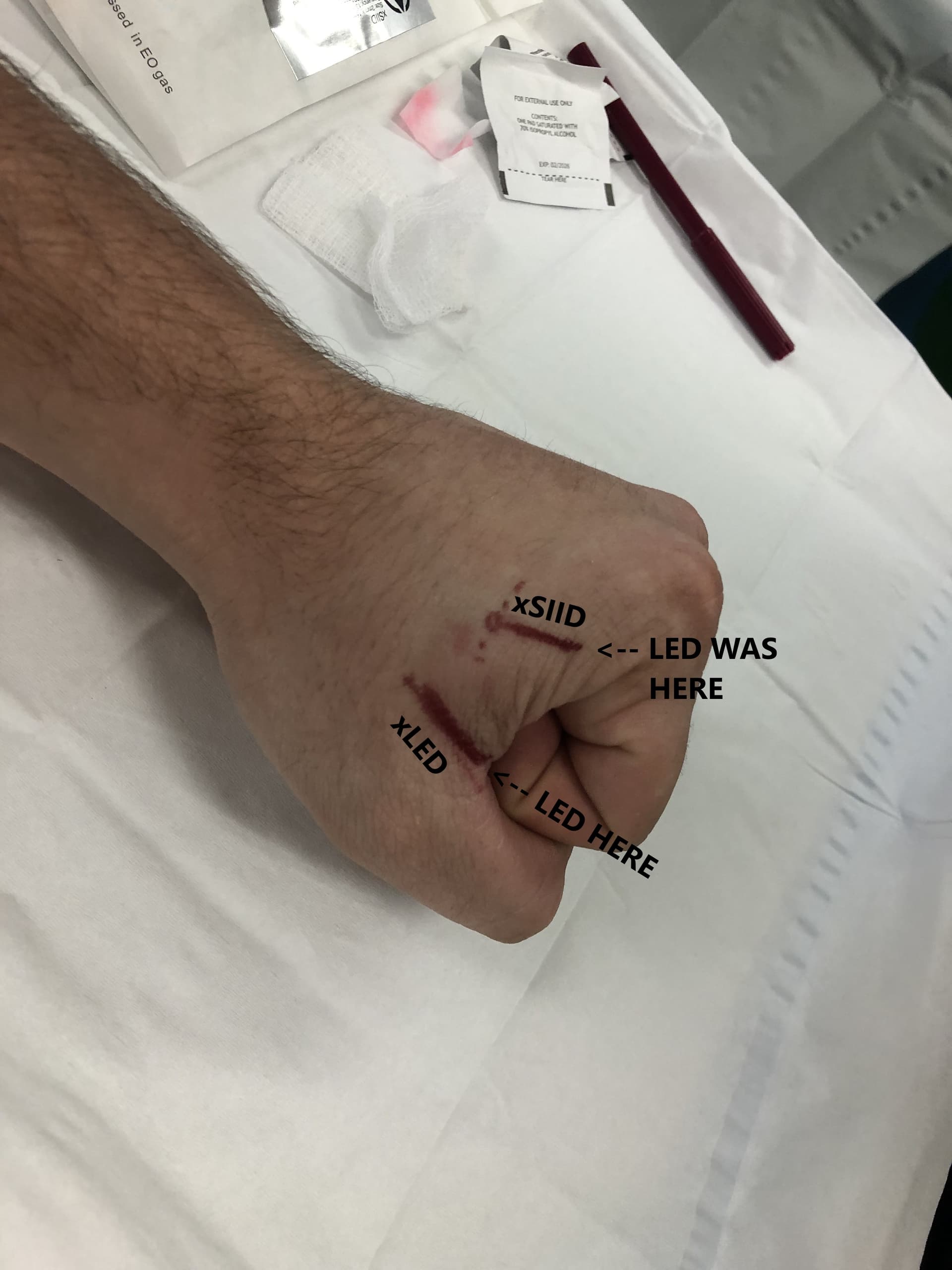

Sooooo! I really don’t want to get them yanked out and replaced/reinstalled so last night I thought fuck it I’m going to try and turn the implants 180° then the LEDs would be in the spot I wanted.
it kinda worked… after about 4 hours of manipulating the implant I managed to turn my xSIID about 100° clockwise, not sure why but I couldn’t get it to turn any further(The swelling made it a lot harder to feel and move the implant) and the led is in a spot I’m quite happy with plus it is brighter in this new spot! it is a slightly odd read angle but sitting comfortably (might try and move it more when the swelling goes down but have not decided yet).
The xLED didn’t go so well tho… the xLED is quite close to my thumb and after trying to rotate it I only got it to move 90° anticlockwise… it was in a worse spot than originally and one end of the implant was kinda pinching against my thumb metacarpal…
I kept at it tho and it was stuck in this new position for a long time and just wouldn’t budge (starting to get a bit nervous at this point) and the swelling started to make the implant very hard to see and feel but after a few hours of pushing and putting ice on it to reduce swelling and tighten the skin, I managed to pop it back to its original position which was a huge relief! (maybe a little closer to my thumb metacarpal now tho…) But again if I could get this thing to do a 180 and move back up my hand a bit then I would be very happy with its position.

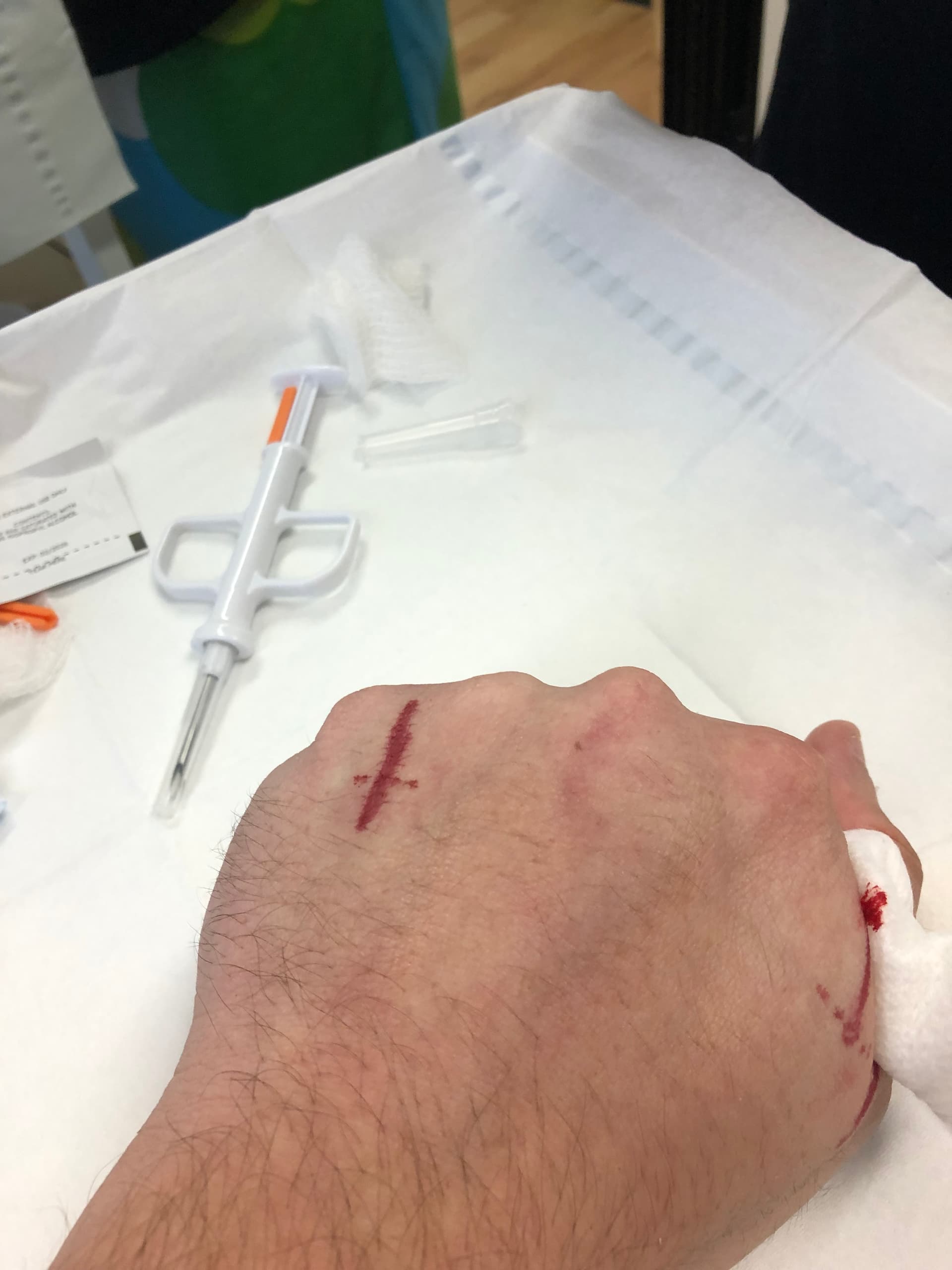

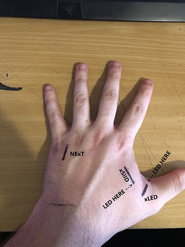

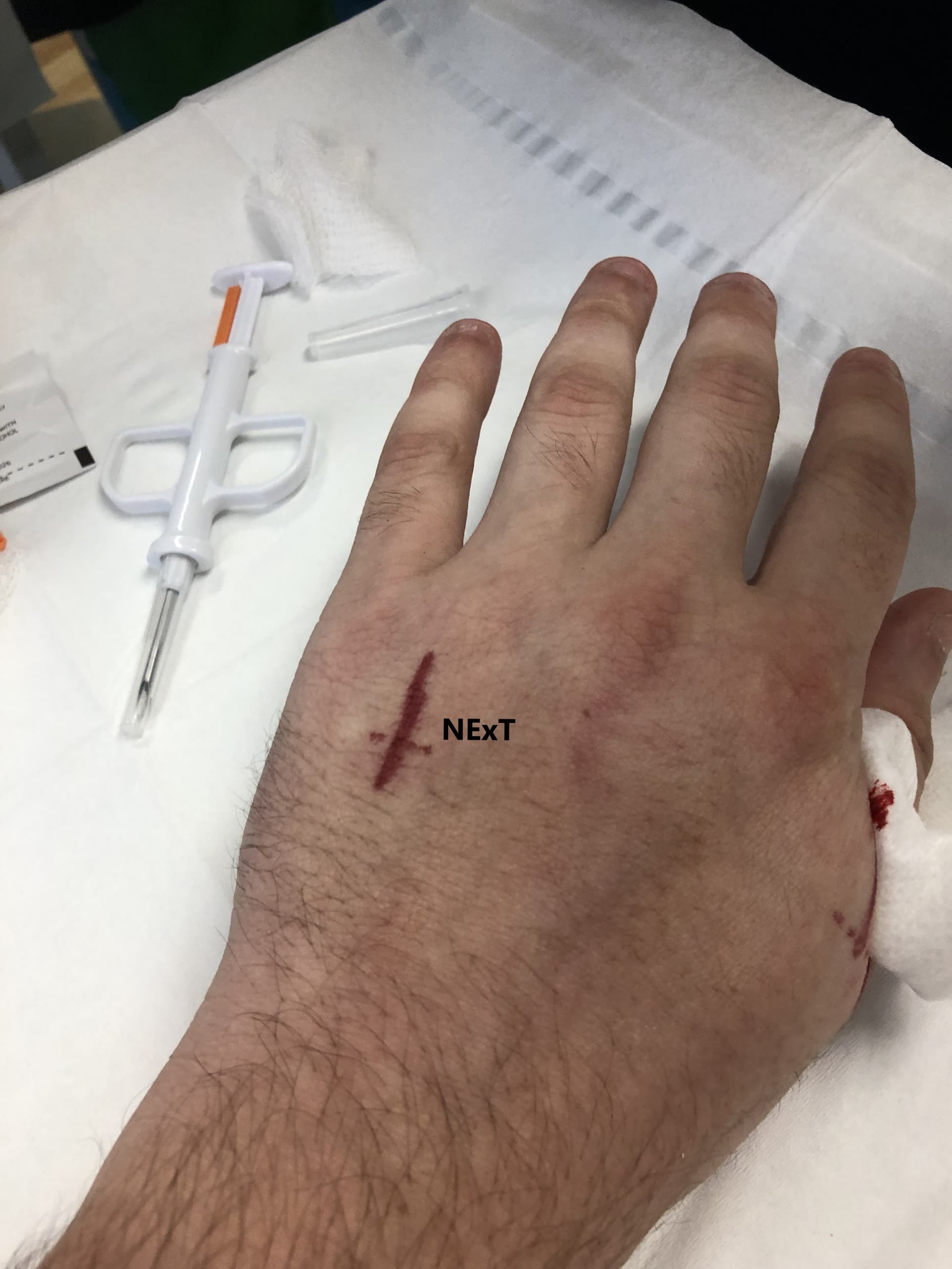

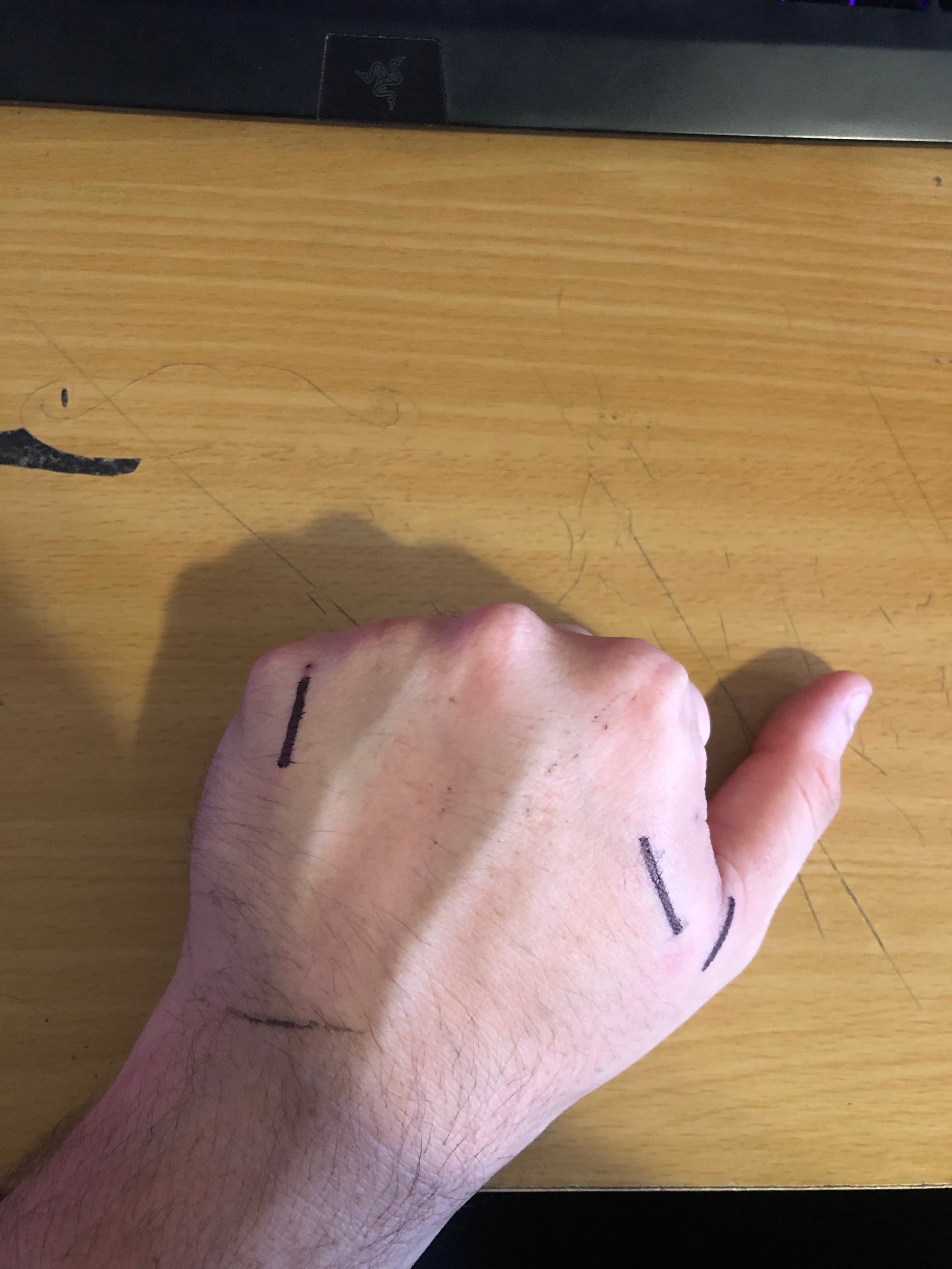

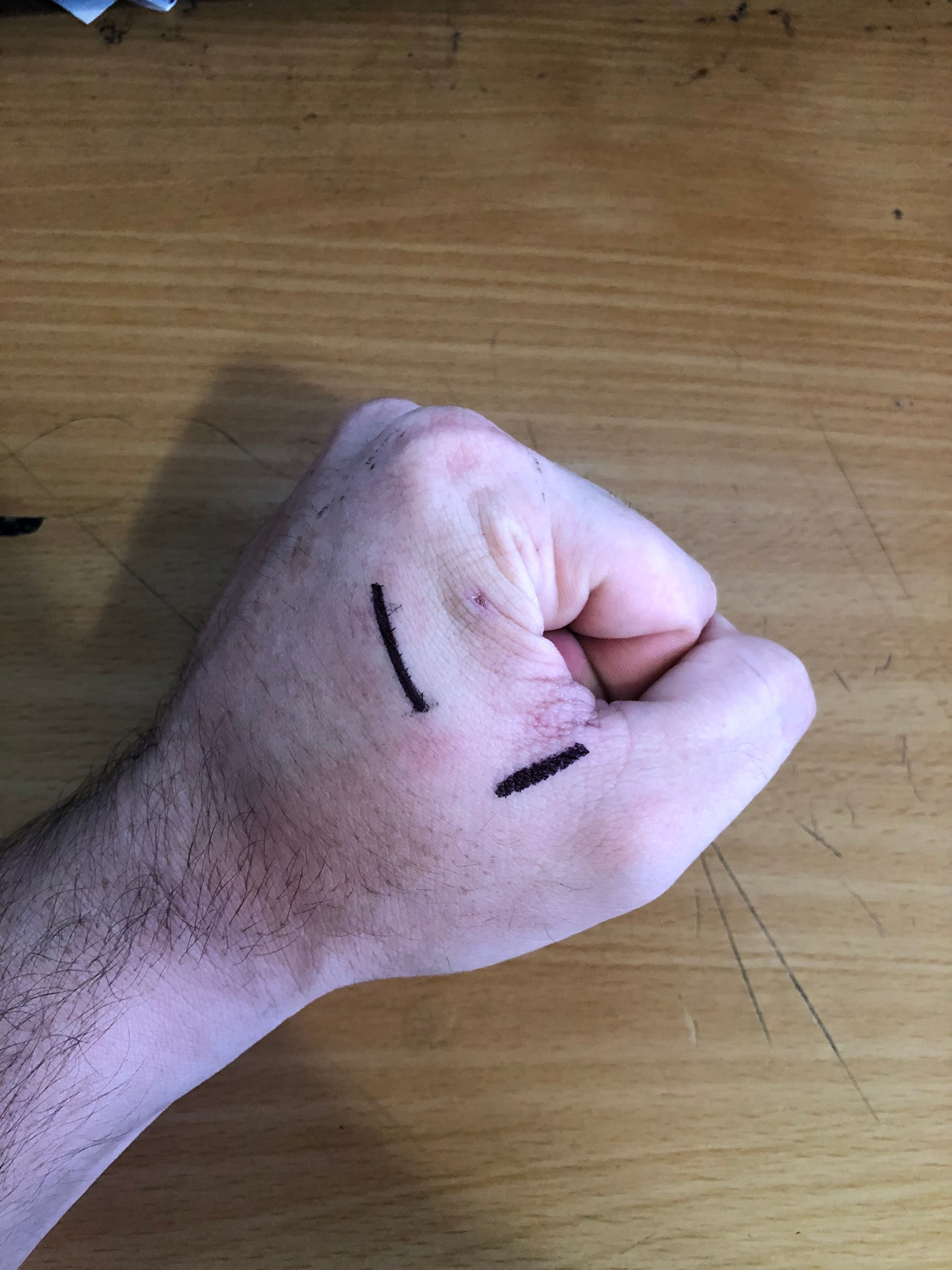

(Below is photos of its planned position when getting the install done. and photos of where they are now after 6 days of healing and me moving them around last night)
Marking on install
Where they are now
Question 2: My NExT is still a bit tender to the touch but healing well. Once again it’s been migrating back towards the injection site and I just wanted to get some opinions on whether or not the implant is too close to my knuckles or do you think the positioning is all good??

I can’t tell if one of your implants is 90° to your thumb currently, but that’s probably not advised, it’s likely going to be uncomfortable in the long run, best case scenario, worst case it’s more vulnerable to damage or damaging you
As far as your NExT, a lot of time the implants will decide where they wanna be, and there’s not a lot you can do to change their mind, they will find their most stable posistion… lowest energy stage if you will
My advice, if it’s not where you want, yank it, heal and go again… I pulled a magnet recently and it’s really not that big of a deal
Yeaaah, that mark 90° to my thumb is to show where the xLED got stuck in my attempt to make it do a 180° turn. it is now back to its original position. so it is now where the marking parallel to my thumb is.
as soon as it got stuck at that 90° mark I knew it wasn’t good. but it is back to normal now. I still would like it to be flipped so the led is facing towards my wrist tho. I’m tempted to give it another go
