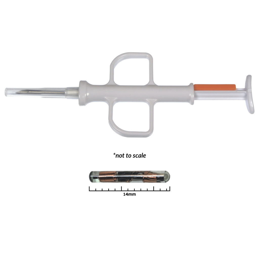

You said this was installed at defcon, are you positive or have any verification that it was a NExT and not just a xNT?
(Assuming defcon had those on hand, and you didn’t BYOI)
Crazier things have happened :man_shrugging:t2:, and I can imagine DEFCON being chaotic

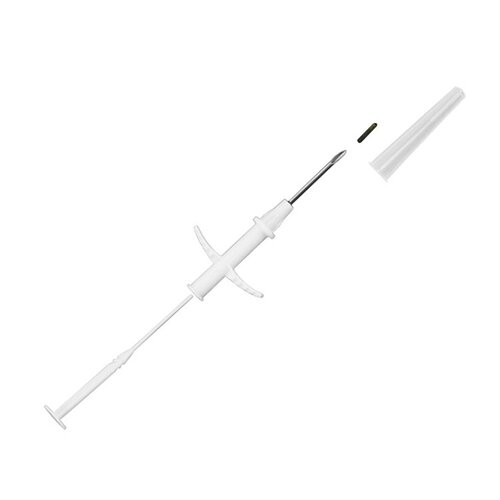

Correct me if I’m wrong, but I believe the next and the xNT injector are physically different so maybe if you have a video of the install? edit yep these are the 2 styles
…I think the url link says which is which also, assuming you haven’t reformatted it
You could get an x-ray or try to mesure the length of the implant with a ruler but the skin will probably get in the way of the second method. Maybe if you have another glassie to compare it to?
It was the bottom needle. No video of the insertion. And the LF side was active for a short time and was readable. It stopped being readable shortly afterward.
I had actually wanted a different model, but they specifically said that NeXT was all they had on site.
It appears to be about 18mm long. I guess that squares with the 14mm stated above; I probably measured some skin on either side.
Ok well that’s the nail in the coffin for my spit ball
