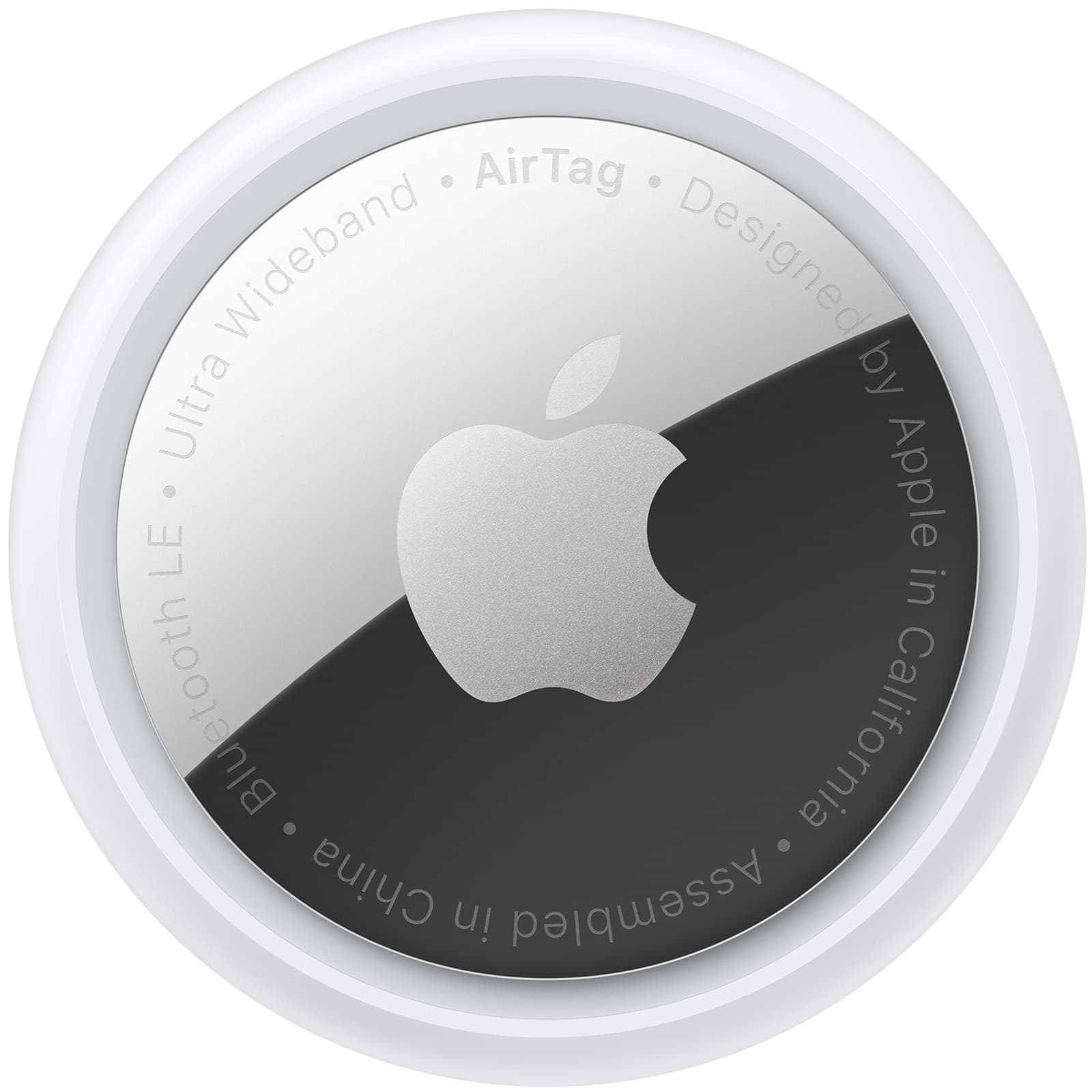

Hiding an apple airtag or similar into something he always takes with him, favourite toy, jacket, backpack (A pity he doesnt always wear shoes, that would be easy)

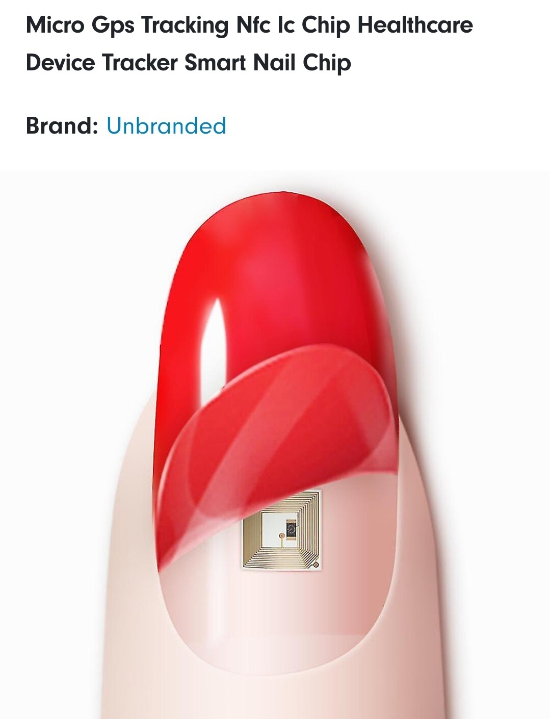

During your search, you may find somethings like this
This does not do what it says it does.

I would look into possibly sewing in pockets for an AirTag into pants, possibly at the bottom of hems or what not
Not someone who does much sewing, but should only need to be a 1 - 1.5 “ solid patch and then a slit down the middle of it, like the old squeeze style coin pouches…
Then just move the AirTags from clothing article to clothing article as the days change
Bonus it would function as a basic geotag, you’d get an alert when they left Bluetooth range, and supposedly new IOS lets you share access to air tags now

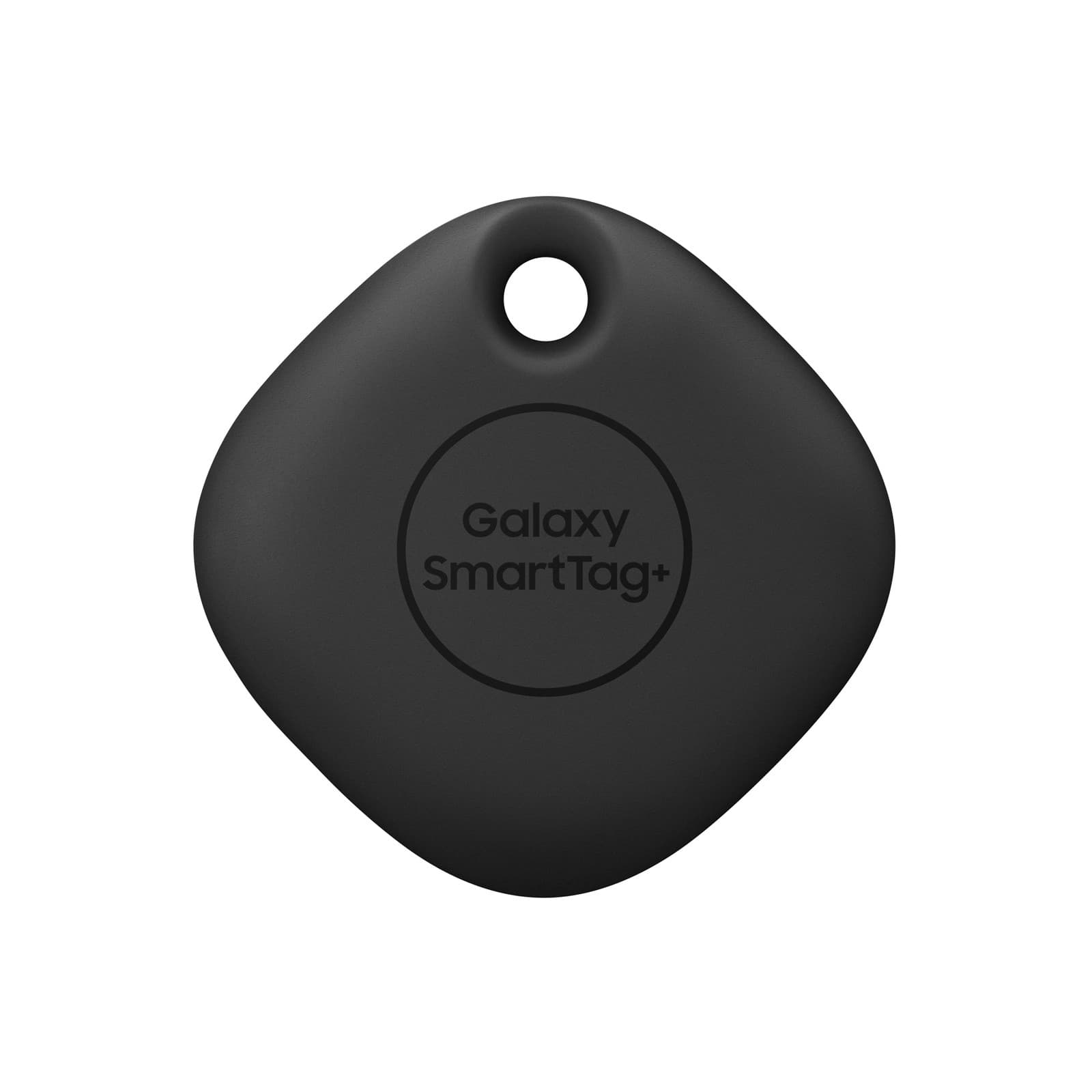

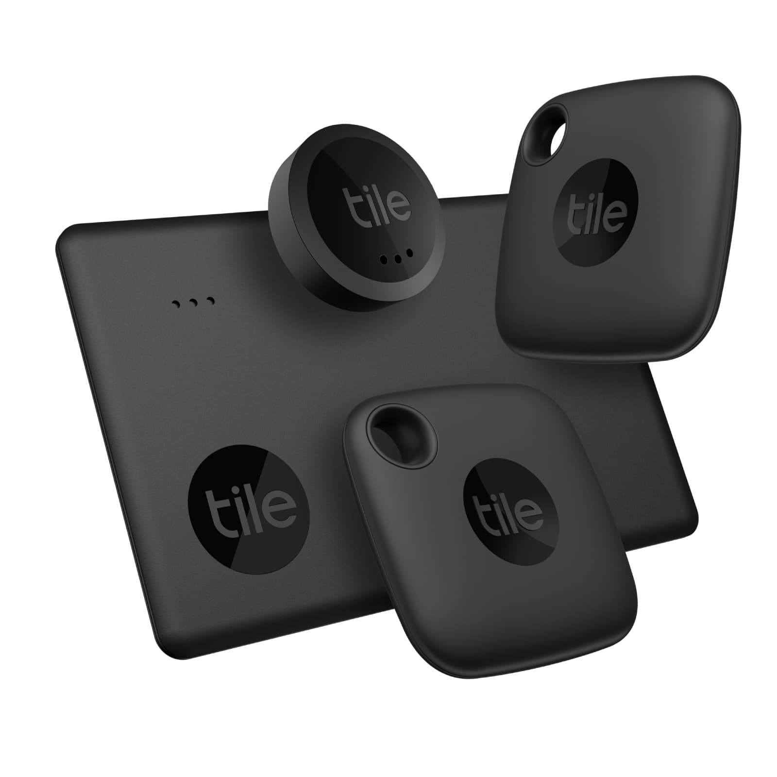

I should say, incase you are not in the Apple ecosystem, or want an alternative, Samsung Smart Tags are very similar, and Tile have a few differnet form factors

Also, I just remembered that the apple ones now beep, and probably the other ones too because criminals have been using them to track things they want to steal, or to stalk people. This is important because if your child is anything like I am, any sudden, unexpected noise, especially one with an unknown source that can’t be escaped, may cause panic, and upset. So if the noise is a problem, there are ways to remove/disable the sound making part of them, so that you have a functional tag without the sound.
Pilgrimsmaster’s first reply is spot on and the Apple Airtag is the best way to go if you can’t go full on GPS (like a pet tracker). However, when the AirTag leaves your home environment it will only be able to display its position in real time if it is near other people’s apple devices (they passively pass on the position of tags to the cloud and your devices can then see them with apple’s “FindMy” app).

That said, if Samsung’s tags work on the same passive relay system with all Android phones (ie not just Samsung ones) that would probably be a better bet, given that Android has a much bigger share of the market.
I have also tested Tile tags but their market is so much smaller so they are only really useful for things that stay put (ie keys, wallets, parked cars)
