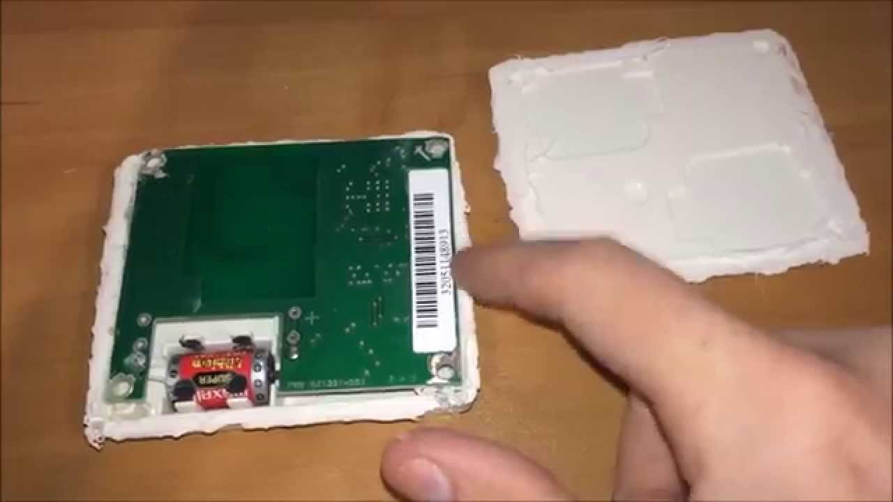

Has anyone ever torn apart an Toll booth pass?
I know that most are active antennas, but it would be neat to try to get it working.

interesting… looks active to me… at least the one on the left does anyway…
I decided to look it up for my state
I’m not sure if this is active UHF RFID but I think it is
Yes it is
If I were you, I’d obscure the UID in your video, if you don’t want any Tom, Dick and Harry programming a clone and charging your account.
It was mentioned the device was from the trash. Hopefully not still linked to an account.
Dam it, why’d you’ll them :rofl:
Seriously though I’m sure they said it was trash, plus look at that battery surly the things long dead (not linked) one would hope so.
Ah sorry, must’ve missed that bit.
Nevermind then :slight_smile:
Btw that is an old transponder which they stopped making in around 2014. There’s still some being used currently though (if they aren’t expired yet). I’m going to guess the one in the video was expired and therefore not linked to an account anymore. They said it was discarded in the trash. But hopefully the barcode on the PCB isn’t the UID and isn’t what the transponder transmits.
