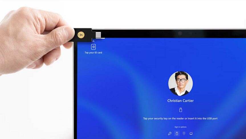

Surface pro 10/11 for business both support NFC auth (the reader is in the upper left hand corner of the screen)
https://www.microsoft.com/en-us/d/surface-pro-10-for-business/8v73d6qwrss1#tab-tech-specs
The price retail is outrageous but if you hunt on ebay a bit you can find a good used deal.
That’s pretty cool actually.. would love to test this out with an Apex.
I’m getting one on Monday, I’ll be happy to post results with windows and linux :crossed_fingers:
Update on Windows Surface Pro 10 for Business Model: 2079
Windows 11:
NFC reader works for Flex implants via web browser. Have not tested Entra joined NFC login yet. Will update if I test it.
Tested working implants on SP10 model 2079 running win11:
xSIID, ApexFlex, ApexSpectrum, flexUG4, xMagic, spark2
Manjaro Linux:
pcsc_scan detects reader but reader does not detect yubikey or flex spectrum. Assuming this is a driver issue for now as the NFC reader does not recognize with a serial number in ixni, modprobe, hw-probe, or any other known method.
intel-npu-compiler and intel-npu-driver both compiled with no issues (for AI offloading)
Gave up on linux for now as it seems that the reader will need a deeper dive on the windows side.
