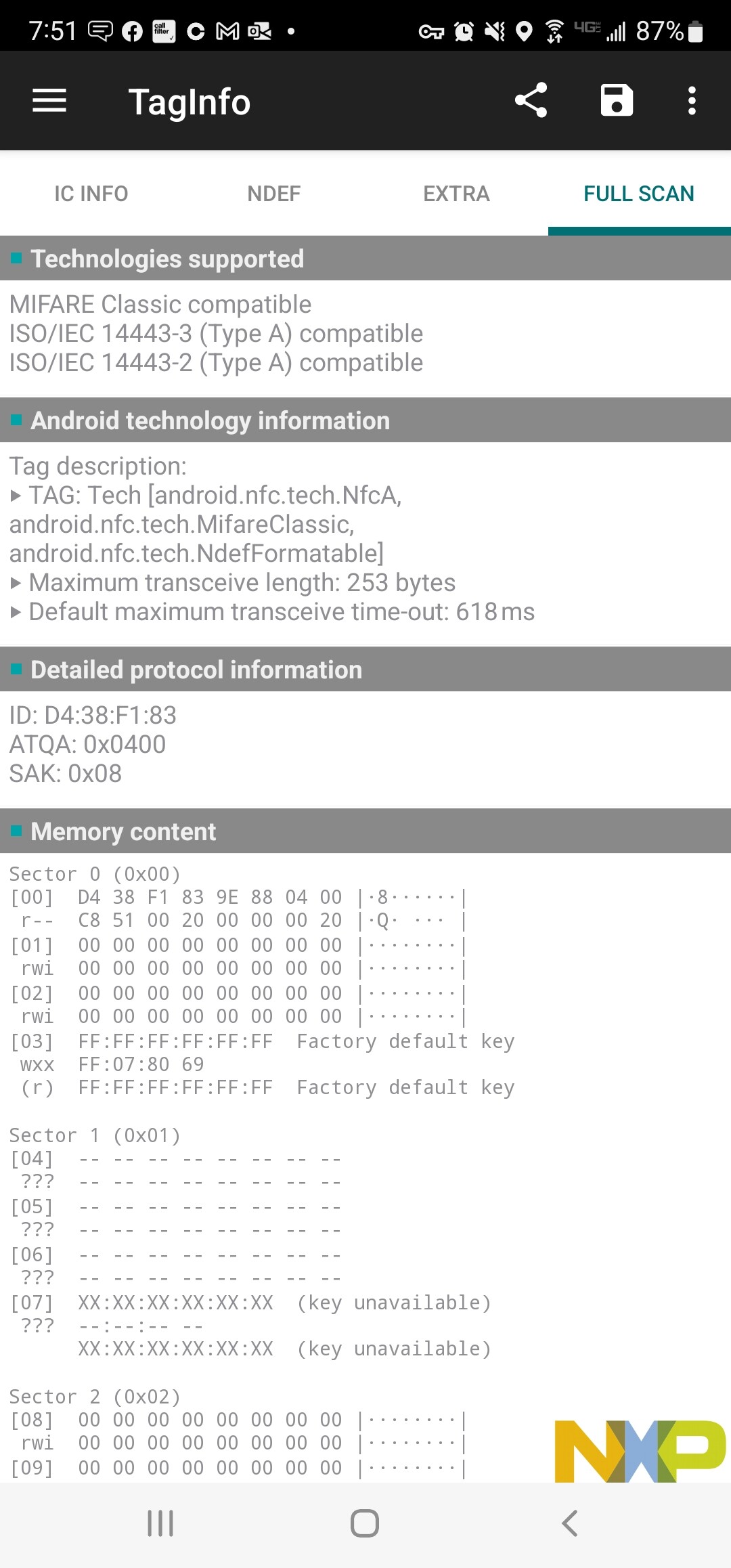

Used hf mf autopwn, and got the file. Copied it to my xM1, but the SAK is not matching. Hotel card says 0x08, and my xM1 says 0x88.

Below is pic of the other card.
This covers SAK changes
http://proxmark.io/www.proxmark.org/forum/viewtopic.php%3Fid=6156.html
