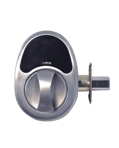

The QuickBolt looks uncannily VERY similar to the QuickLock which also uses ISO15693
https://www.thequicklock.com/cart/category-doorlock?product_id=118
QUICKLOCK
QUICKBOLT
