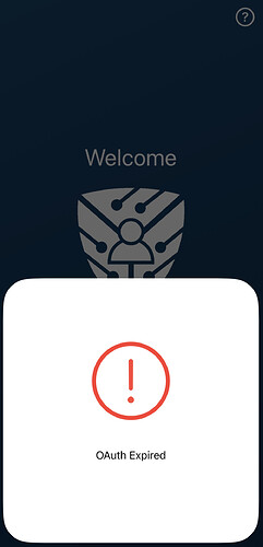

I got an Apex flex installed roughly a week and a half ago, which has been really exciting for me, but I’m having trouble getting into the Vivokey app.
I mainly use an iPhone, but I keep an old Android phone around since it tends to play a lot nicer with NFC. Still, regardless of which one I use, I can’t seem to login to the Vivokey app. On Android, every time I scan it, it says “NFC Error”. On iPhone, it says “OAuth Expired”.
Funny enough it doesn’t work with the vivokey app. You use fidesmo to do all the applet installs and things.
