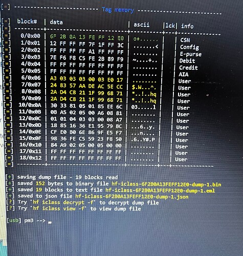

after running the command line
hf ic dump --ki 0 this is what showed up .
hopefully i get a little closer to actually copying this card . fingers crossed
Now we’re getting somewhere!
This is what you’re looking for. Blocks 6-9 are what you want to copy to your new card
is the link that @Pilgrimsmaster sent earlier, and it spells it out pretty straight forward for you.
hf ic wrbl -b 6 -d A30303030003E017 --ki 0
for block 6 and duplicate for 7-9 with the appropriate data, all caps, no spaces.
after writing blocks 6-9 manually, do the dump again to verify the cloned card matches the original and give it a try!

i duplicated blocks 6-9 like u mentioned and added the appropriate data. i did the ic dump info and as u can see in the new card blocks 6- 9 are the same . the only number i noticed isn’t the same is block 0 my original data numbers are different then the copy card. is that normal or did i miss something?

a picture of the hf ic dump info on new card. let me know if i did it write from the original card ?
is my card really copied ? crossing my fingers
i cant try it out till i get back to work but from what u see do you think i did it correct?
You can’t change the UID but I believe from other people’s comments that it is more concerned about the content of the card itself.
I assume that it uses some form of challenge/response with the card, but I have not looked into it.
If everything except block 0 is identical then you should be good. As you can’t modify parts of block 0 (maybe all) then this shouldn’t be a problem.
blocks 6- 9 are identical
block 2,3,10,11,12,13,14,15,16, are not exact copy.
is that normal ? i was only told to copy blocks 6-9 from above. was i suppose to copy every
block or just from 6-9?
maybe blocks 6 threw 9 are the only ones necessary to copy and the rest are just fillers . just thinking outside the box
Unfortunately this may be all for naught. Anything past block 7 is going to be SE blocks which aren’t cloneable.

As I understand, SE cards have those extra filled data blocks with data that is encrypted with the UID. Since we can’t change the UID on these cards and we don’t know exactly how these extra blocks are encrypted, we don’t know how to decrypt and clone them to a new card.

The short of it is that you’ll likely not be able to use the cloned card on many readers, depending on how they’re configured. Blocks 6-9 are what you’ll need for any terminals that are not looking for the SE section of your card. If you clone blocks 6-9 and none of the readers are working, it’s more than likely that they’re looking for the SE data. Unfortunately, that data cannot be properly cloned.
