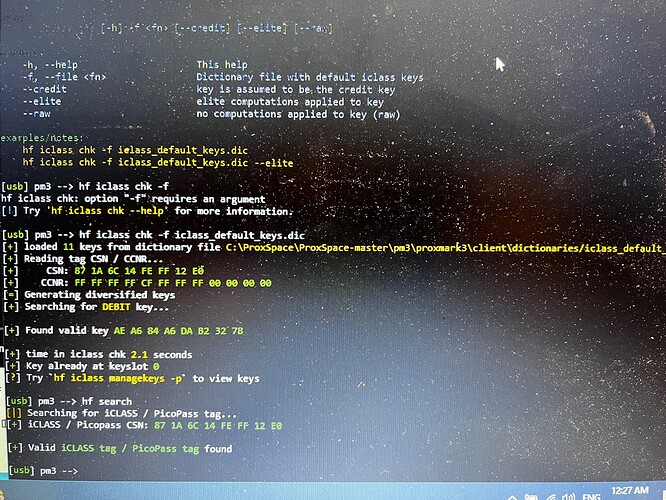

so far im happy to see the proxmark3 was able to read the card to tell me its a picopass 2kcard type. it found valid keys as wel. now i need to purchase the correct blank cards compatible to write on and the same keys.
as soon as i get a blank i try cloning it. it seems the M1 HF cards aren’t combatable unless I’m doing it wrong …

You shouldn’t have to worry about deleting data. Usually issued cards will be locked by the issuer. Can you post the dump file from the source card? hf ic dump ki --0 is the command you’ll need.
this is what shows up when i put in that command line.
whats the next steps to actually coping this card to my blank picopass card .
thx
Can you share the rest of the file output? There should be a column or two of data listed.
here is the info on my original
card that i want to copy onto the blank card
if this is not the info you need then what is the command line to see those columns . I’m not familiar with all the command lines yet
You should get a .bin file output saved in the client folder of the proxmark directory and a display of the data in the terminal. When you give the dump command does it not show the card data below the “Card has at least 2 application areas.” line?
That is the rest of the file output that @philadelphiaChickens is referring to.
should be columns similar to
