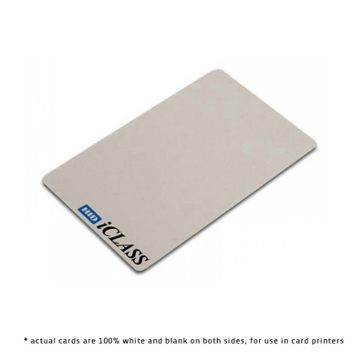

@philidelphiaChickens @Pilgrimsmaster I’ve done a little looking around, and I mean a little as in only a few min, for a fob or card I could order a single of just to test the cloning before getting the flexclass. Haven’t found anything that seems to fit what I need. Any insight?

Hopefully their other products are better than the HID iClass card that I ordered 6 weeks ago and just arrived today…
It still works, but does not fit in my card folio very well
Although I didn’t order a wavy wonky 1/2 melty card, it does work and it is 100% still just a First World problem… I’m sure it happend I transit as I don’t imagine they would ever send out something like that
Ironically, that’s the card that I need :grimacing: so we will see. And, it’s gonna be hard to use an October discount in November :upside_down_face: :crazy_face:
