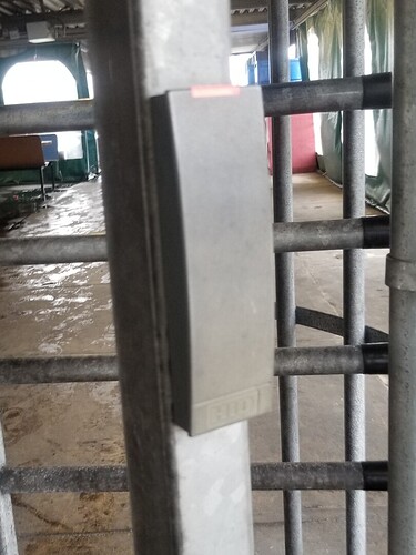

HID cards generally don’t use UID to authenticate, instead using blocks 6-9. It’s possible that your system is using SE readers that are checking for something else. Can you share a photo of the reader you are trying to use the card with?

I can try to snap a picture wednesday on my way in the turnstile. If we have a slow night I might be able to try to get a number off the back without security seeing me.
Someone knocked one of them off the mount bracket the other day and I tried to get a quick peak for a model number or something useful, but with everyone that was around…probably not the best idea.
Trying to do this surreptitiously will look suspicious. Walk up to it and copy numbers whatever with confidence.
If anyone does ask just reply that you are looking for model numbers to determine compatibility. Most likely nobody will ask. If you try to be surreptitious you can guarantee that people will treat you with suspicion.
Noted. I had a brilliant idea and text a buddy on the other shift to snap a pic for me on his was out this evening. It’s not the best quality, but maybe it will shed some light on what I’m missing?
