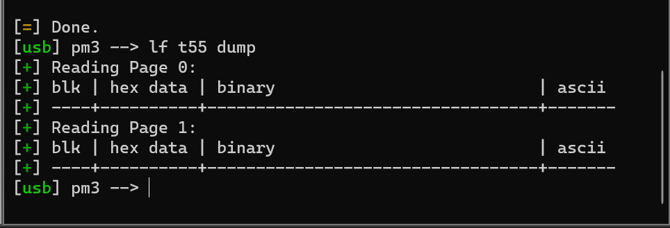

When I perform the lf t55 dump command, it dumps empty lines with no hex characters and no output – I’m not even sure if it is reading the card at all.

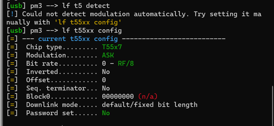

When I try the lf t55 detect, it errors out and asks for me to run a config, which I do. It lists block 0 as 00000000 (n/a) which has been unaffected by all of my efforts to rewrite it.

for lf t55 dump i get nothing
when i try detect and dump

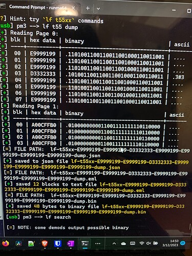

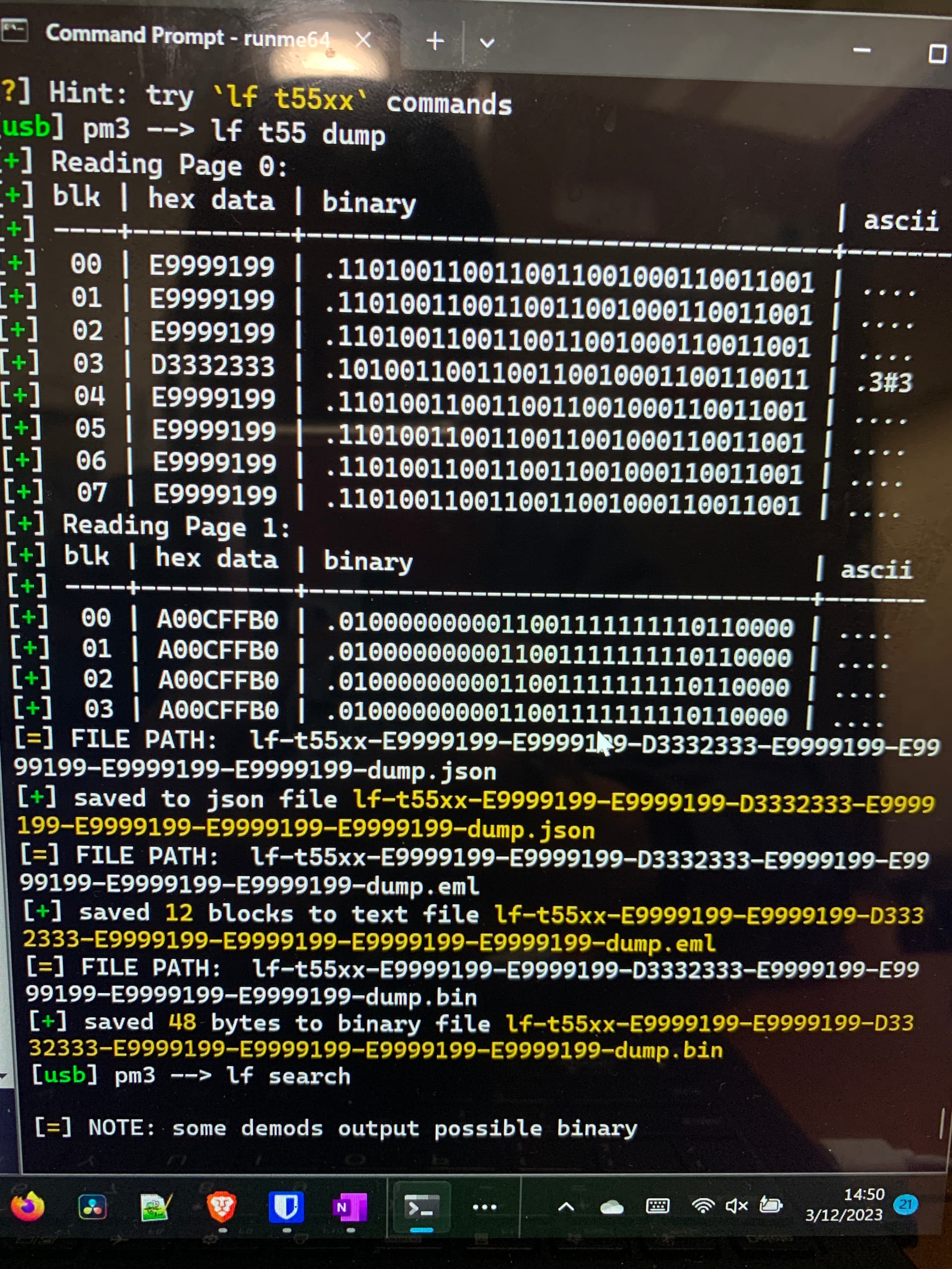

I did have another pm3 question. I have a T55xx card that I tried to write a HID card to, just prox, and it wrote it as an Indala card with an odd number of bits showing on LF search. It does not show as a t55 and I have tried wiping the indala config off it, to no avail. Running LF t55xx config on FSK, ASK and PSK does not seem to affect it. I was trying different modulations to see if the Indala encoding would respond, which it did not. I can dump the data, with block 0 on page 1 showing 7 and a lot of Fs. I’ll snag screenshots when I have my pm3 available. What do you guys make of this.
Chances are the HID did not correctly write and you are just seeing random noise that is being displayed as Indala… you can confirm this by doing multiple consecutive searches and the data being returned is probably changing each time. That means it’s just noise. This is a failure of the Indala encoding mechanism for not having any real way to do error detection.

So I did the steps. It detects it as a t55 in p1, but the funky Indala encoding remains and is not detected with the norma t55 detect
You were right in that it shows as random data sometimes as a Keri tag too.

I will link dump data in another photo
