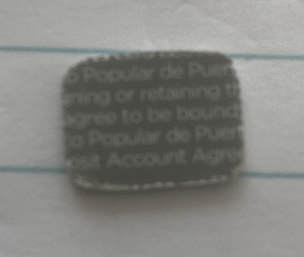

Hello, I need help with this situation for the conversion of the chip for implantation. Do I have to remove the chip or send you the card and you can do it for an additional cost? I’ve already tried to do it twice and the chip on the card works, but if I remove the chip very carefully like in the videos, it seems to no longer work and I don’t know if it’s normal or if I’m doing something wrong. I prefer to pay and have a professional do it and not continue damaging cards.

This is the first chip that I removed from the card and then it stopped working but I removed it very carefully.
Since the first chip didn’t work for me, I got another card and what I did was cut it around the chip with the plastic so I wouldn’t have to take it off since the chip is small and very thin, even with the plastic it’s still very thin and so as not to damage it, but that didn’t work for me either.

Hi, what i told you in the ticket was how they work. It was not a testing methodology. I also mentioned the one’s you extracted almost certainly work and to send them in so we could test them once you pay for a conversion.
Just incase you werent aware, or understood what was meant above ( it’s easy to forget that not everybody understands how things work), when you removed the chip, It doesnt just remove the chip from the plastic, it seperated it from the antenna that you cant see because it is embedded in the plastic.
Similar to this as you can see the antenna running around the perimeter.
You can see for yourself if you get a bright torch/flashlight and shine behind the card.
Basically, they will remove your chip and it will be put back onto an antenna similar to this
