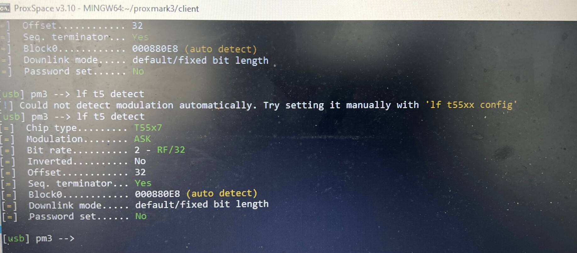

then put it back on the LF antenna ( Top Red coil )
then
lf t5 detect
what does it return?

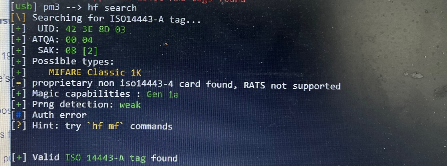

The black one is a HF, so you won’t be able to use that to clone your HID tag.
Can you do a HF search on the blue one as well? It looks like it might also be HF given he results when you did the LF t5 detect command.

This, on the blue tag. It may take a couple of goes to get it to work, so do a LF search after each write attempt. You are looking for the “raw” to be 000000000000002007918ca7. Once that happens, the cloning will have worked.
so u think its cloned after seeing the last photo from the original key?
That suggests it worked.
