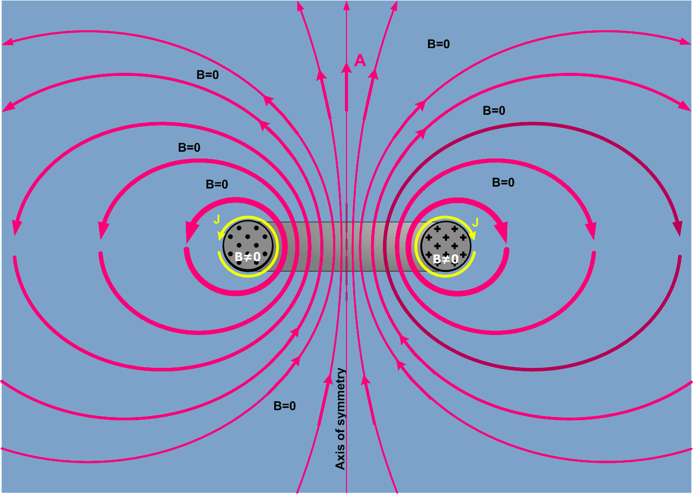

I was thinking that too. also was thinking maybe a torrid coil around the wrist might work (Might require a specific xLED angle though)?
So, I kind of addressed this in Leeborg’s project post:
To elaborate more, the whole point of a “toroid” shaped coil is to contain the magnetic field, so that it does not create leakage current in surrounding metals or produce EMI for other circuit components. It’s designed to do the exact opposite of what we need. See how it’s made, thinking of the right-hand-rule?
If you look at the picture you in your previous post above, it shows “B=0” next to all the field lines. That means they’re confined and have no strength.
I think I have misunderstood the way those coils work entirely or a long time then… OPPS.
I thought it tried to contain it to central part of the disk shape, but from your post I gather the field is contained to where the B line in your posted image is.
I had read that post of yours it the Leeborg’s but that was resting on the skin, I was talking about making the toroidal coil the actual bracelet, like arm through the hole.
Magnetic field physics do my head in.
