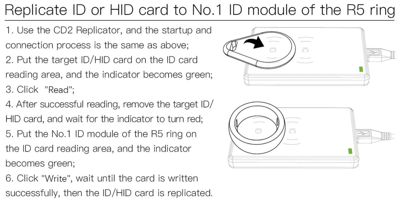

Based on this being the replicator product;

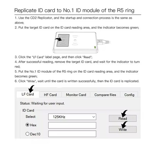

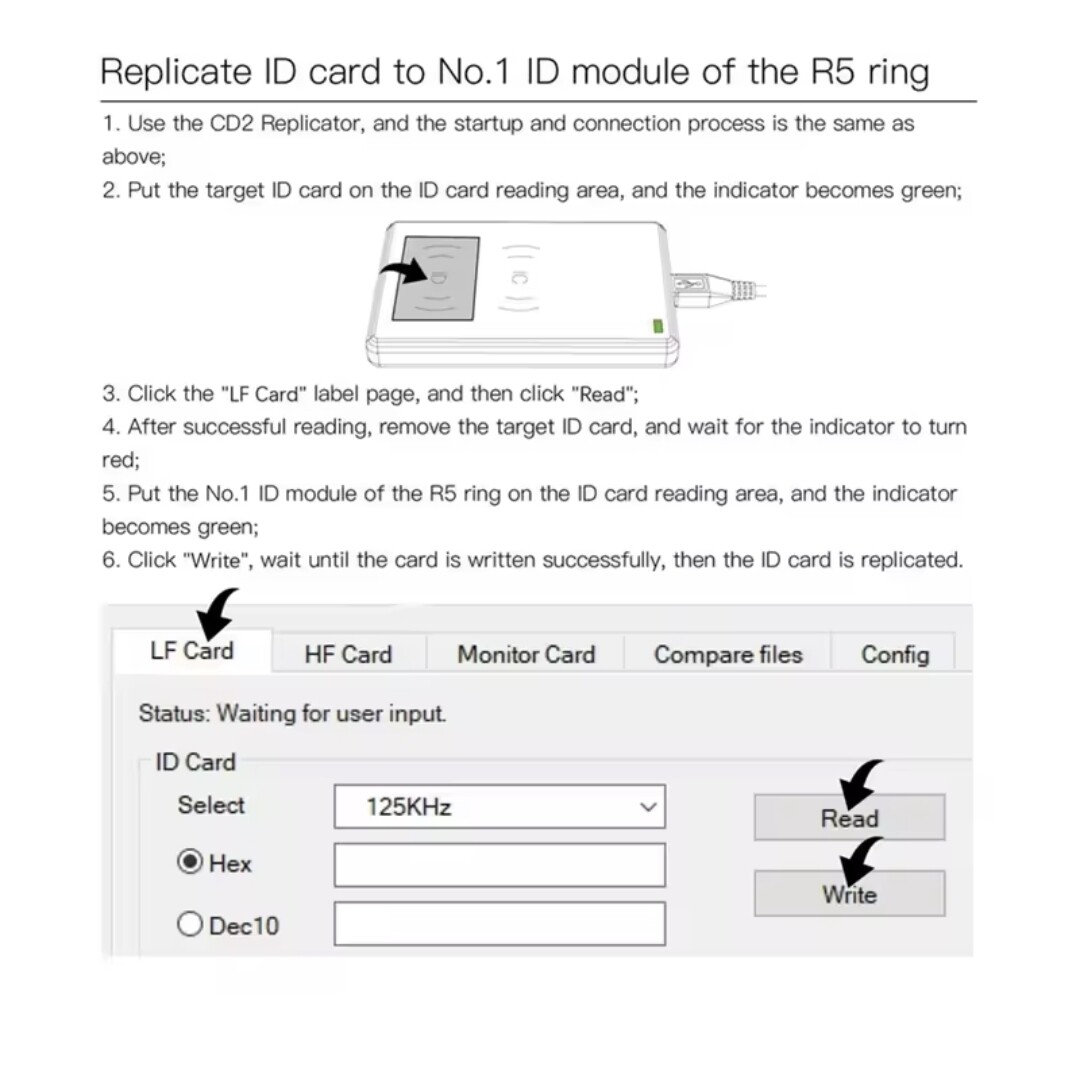

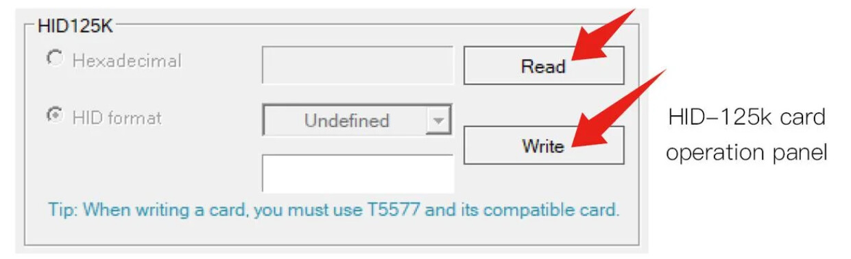

and this being the documentation for it;
Somehow you have to find the HID125k panel not the EMID or generic “125khz” panel… that’s probably what’s going on… either your software is not up to date or you’re using the wrong data panel in the software.

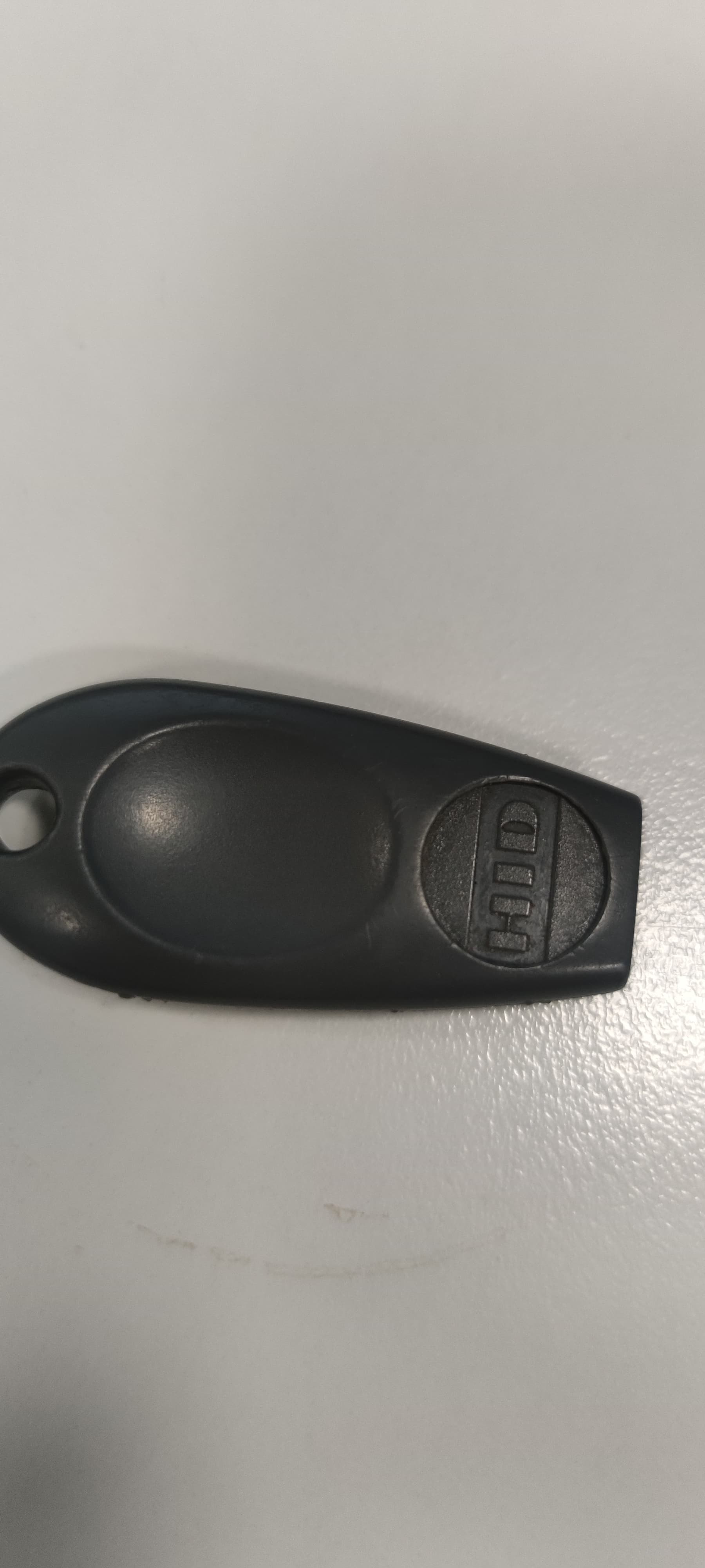

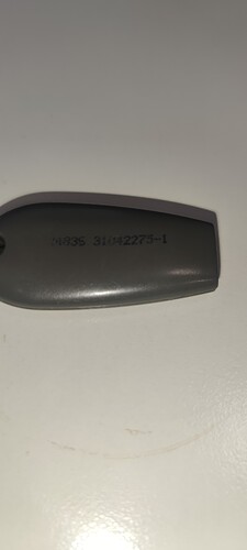

Does the card/ fob say HID Prox?
I upped your user level so you can upload pictures.
Can you share a photo of the card?
good point, are we sure it’s prox and if it is are we sure it’s just prox
(if it isn’t just prox i retract my statement about being confident it can be copied to the ring)

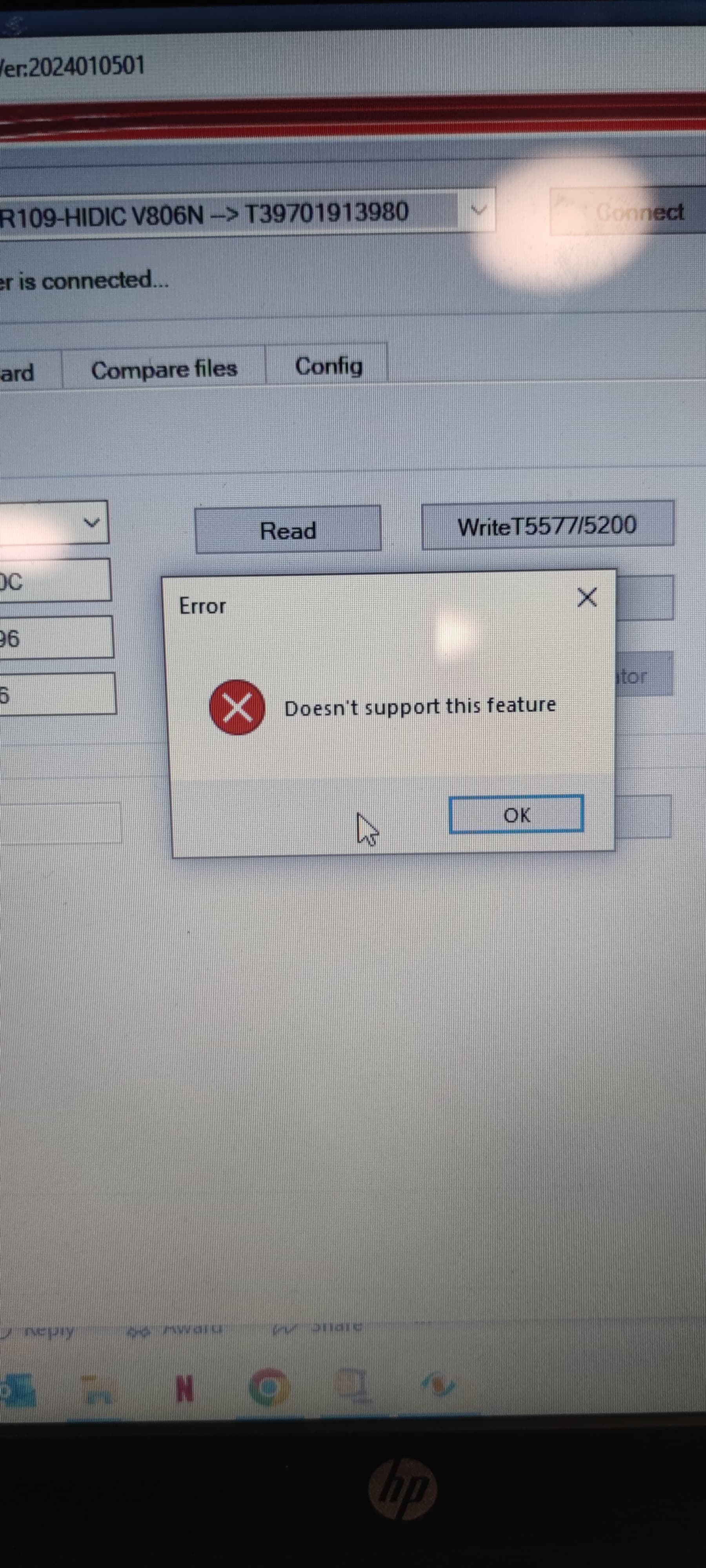

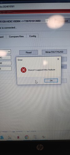

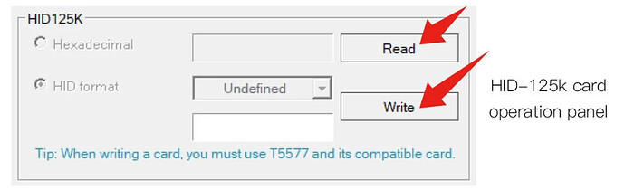

The replicator tool gives me this message
The message is when I press the hid read button
I would ask the vendor you purchased the reader from. If you can believe the software, the reader does not appear to support hid prox

from the pic it’s definitely just hidprox and an official one at that so no issues with clone detection.
