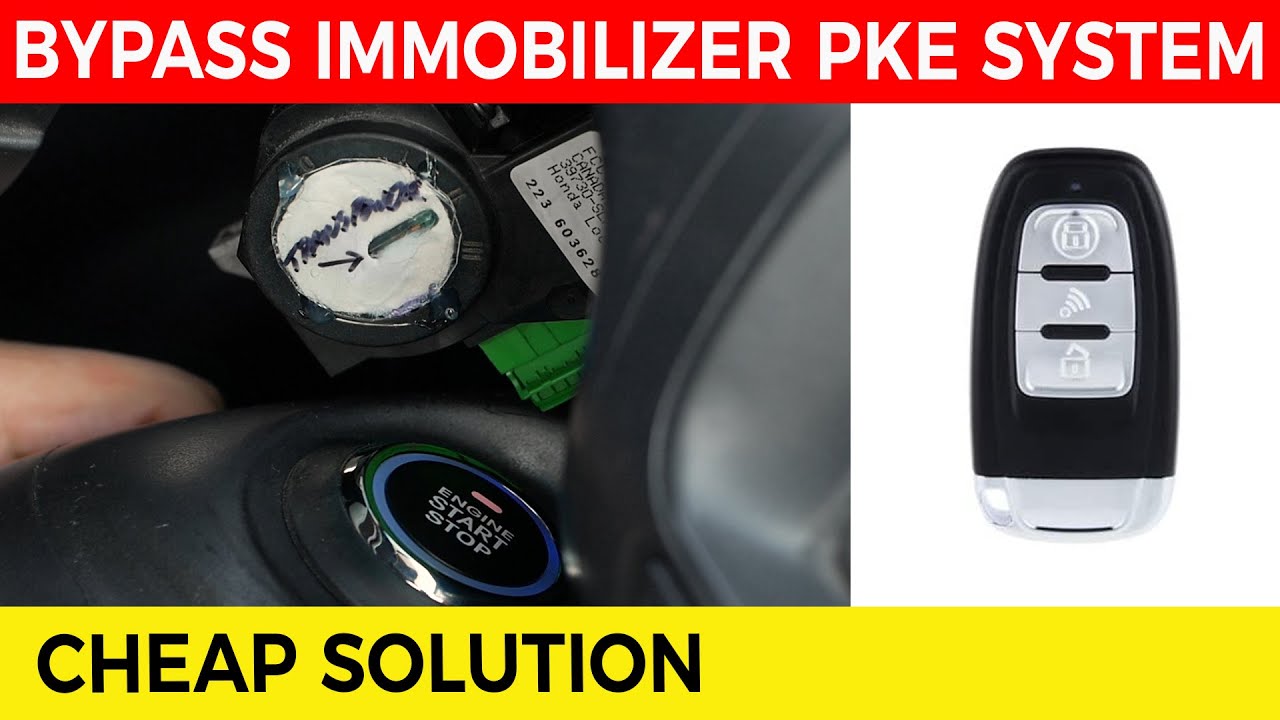

~“…have a way to bypass the HiTag chip to start my vehicle”
I had the same setup, looked at that document and went to the RFID Discord for help.
I put enough time into it, to realise I should look at alternatives.
2 Very easy ones to start you off
The way he does this is not personally how I did, or would do mine, but it works so worth a share
Or in my opinion, a better option
The second ones would be a good option if you wanted to add an xAC :xac_v2: into the system
Scan - { xAC powers Bypass } - Turn non chipped key or press Push to start etc
