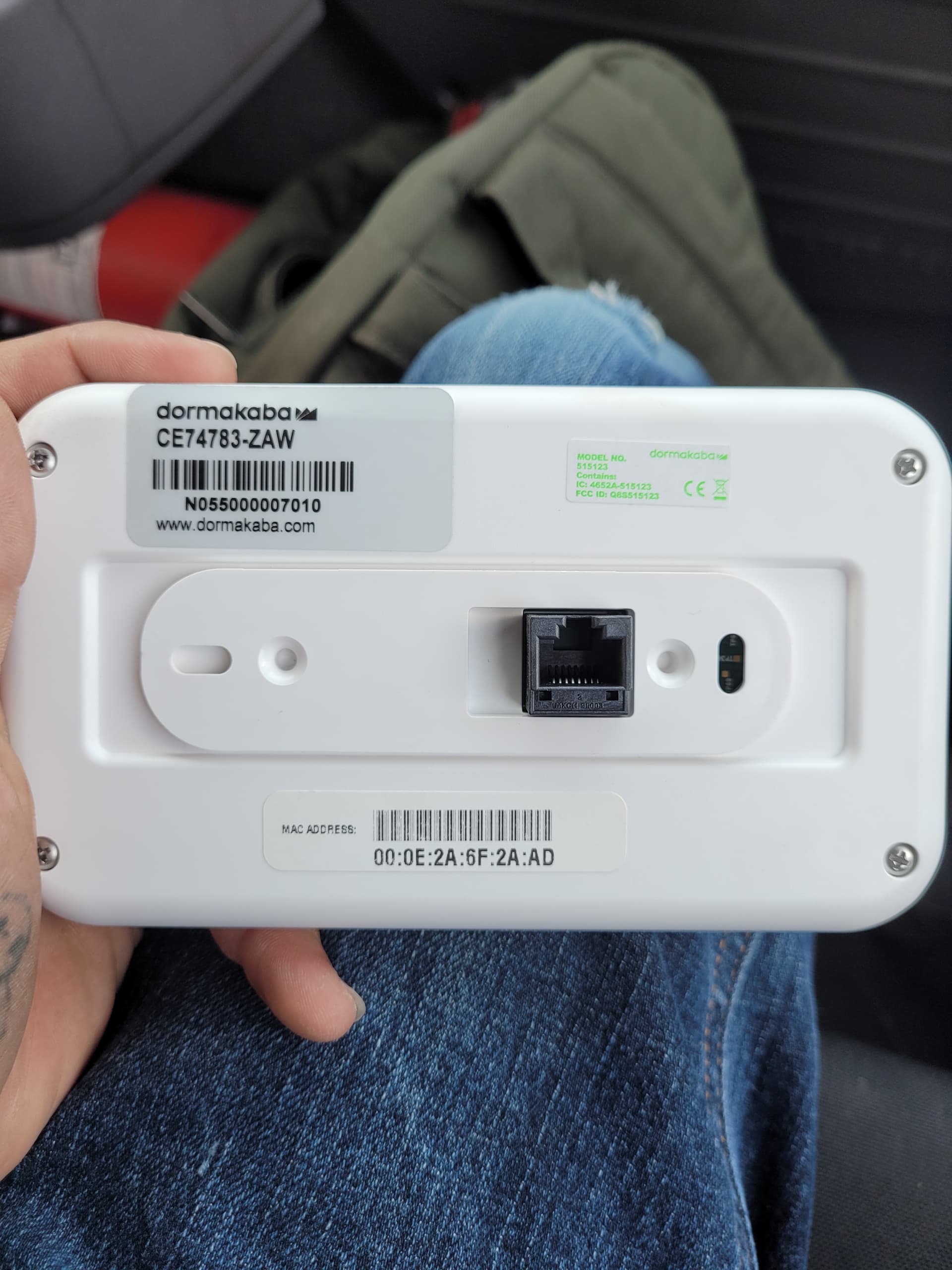

I have a few CE74783-ZAW
ZIGBEE HUB SAFLOK WALL MOUNT N AMER G
Boss was throwing them out. All brand new, most still in packaging besides the few I took out to look at.
I believe they are just the READERS. But all have its own personal addresses…

A zigbee hub as described would indicate it’s a receiver for zigbee devices not an RFID reader. But yeah seems like the company doesn’t even mention the product on their site so it’s hard to find info. The one site has them listed for over $800 but without any other sites to compare it to, could be just a “Hey Jimmy, stick it up there with some stupid price to see if someone buys it” type deal.

Looks like there zigbee hubs for hotels ect where the doorlocks, aircon ect are connected. Found a datasheet with the part number, dosnt seem like there rfid anything :frowning:

Pages 13-15 give you an idea of the system. “Useless” is a stretch if they can be used with something like homeassistant then they could be fun or I’d there hackable in any way.

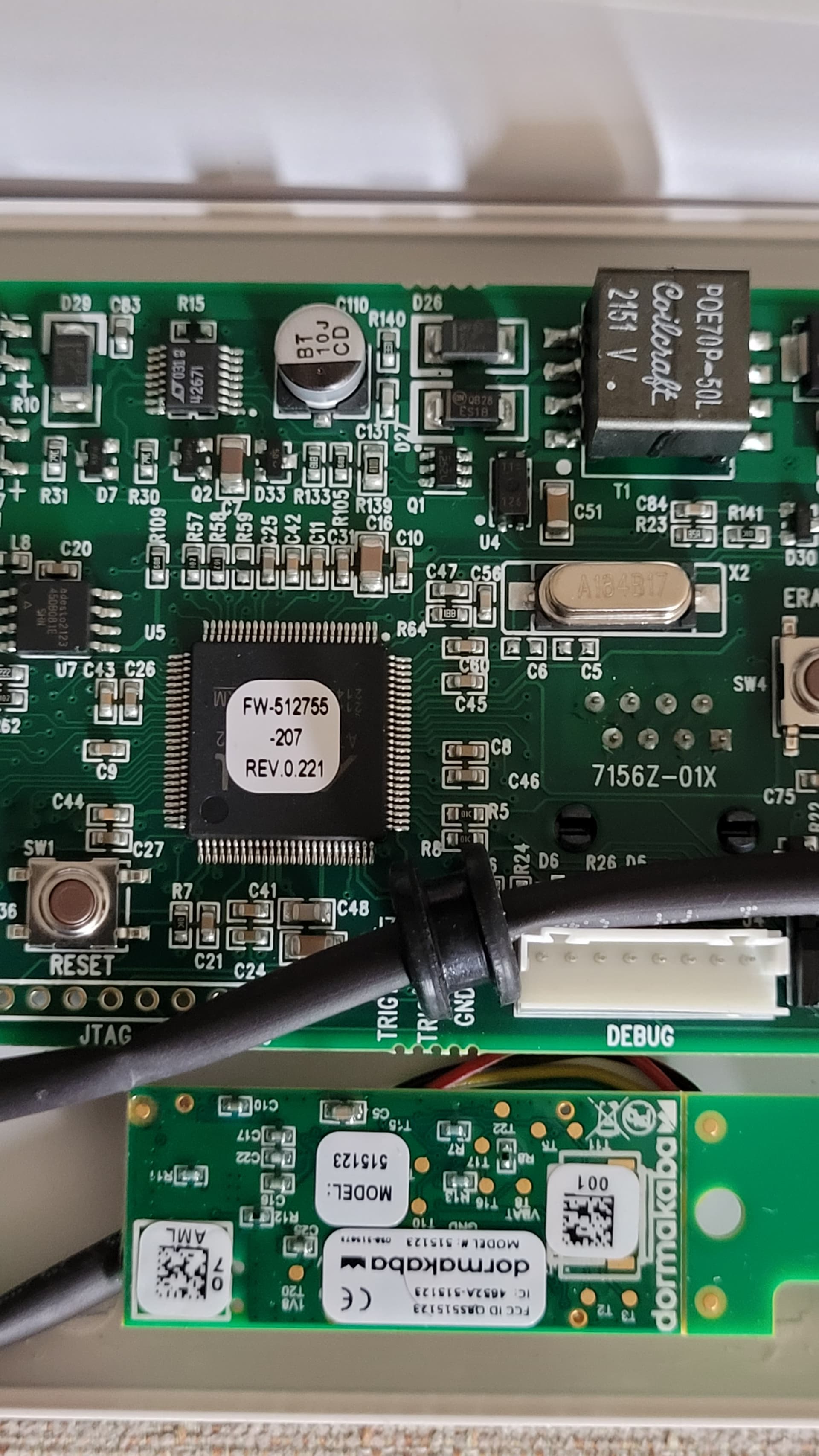

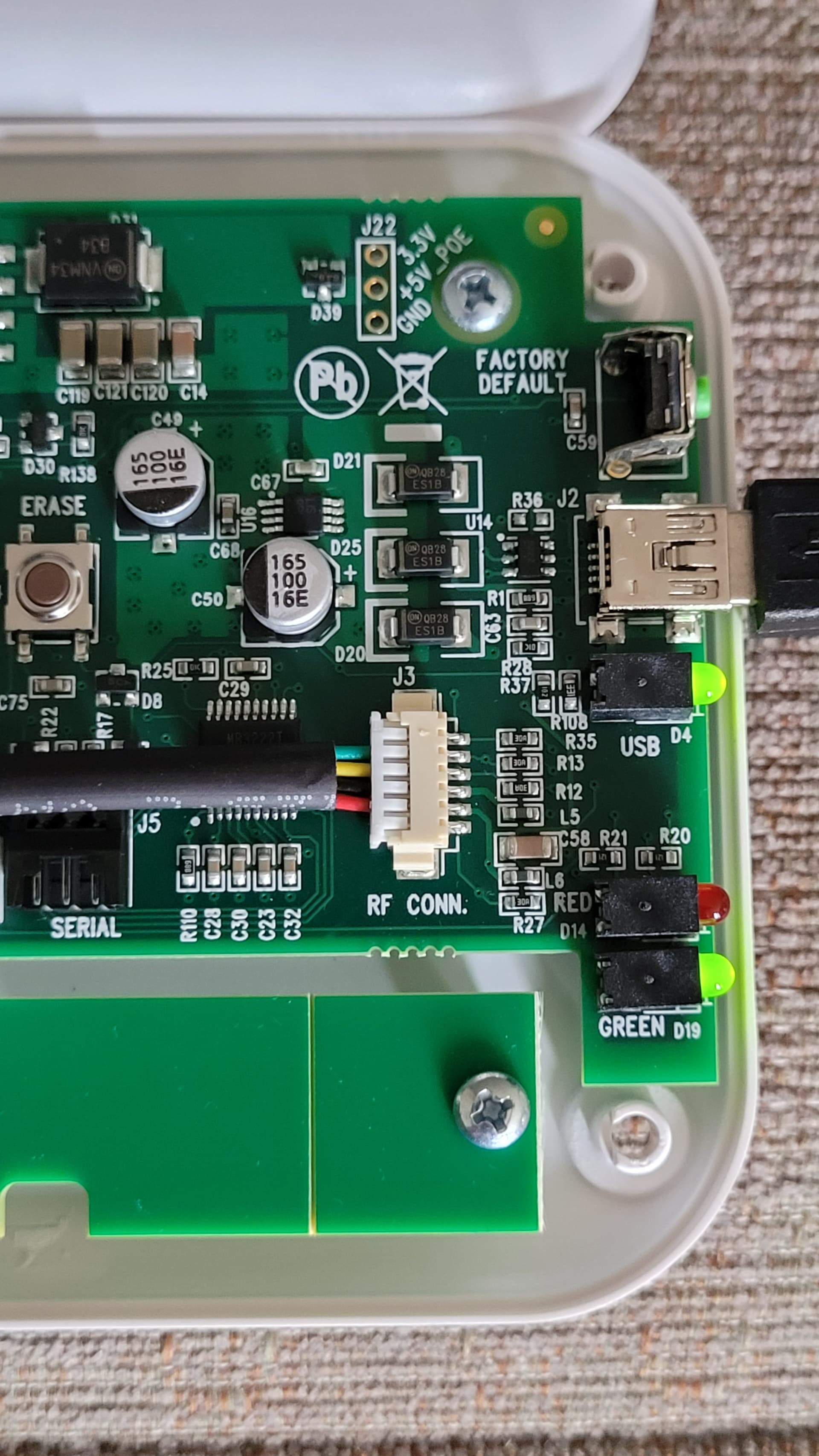

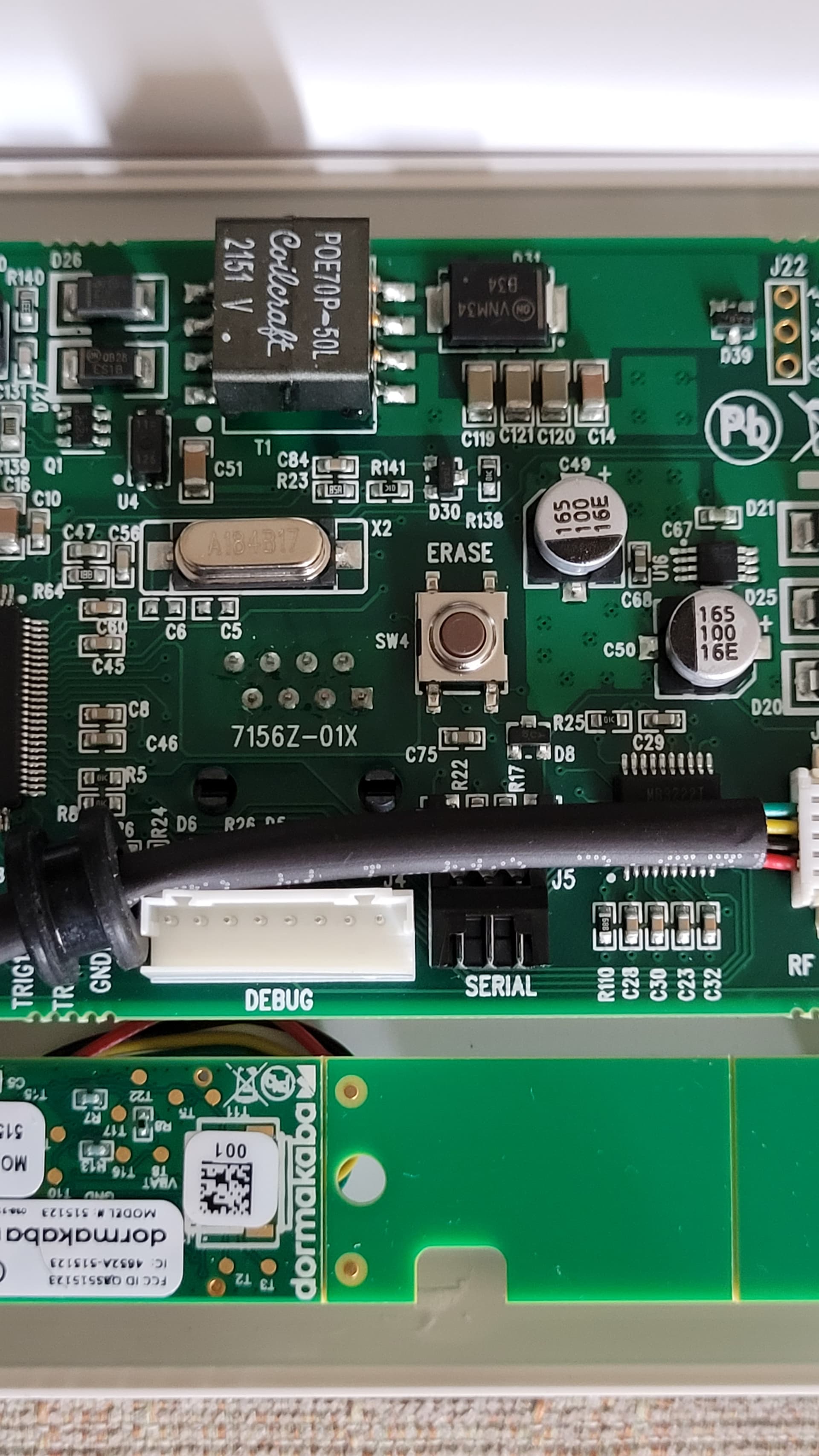

I can also open one up and post what’s inside… I just don’t know enough to tell anyone anything that I’m looking at :sweat_smile::man_facepalming:
I do have a whole lot of them though​:pray::pray:
Crack one open and post lots of pics, there’s better people than me on here but pictures are definatly a start.
Guessing they are proprietary to work with their Messenger LENS access control system.

yep no rf antenna so not much to do on the rfid side of things. would love a crack at using it as a hub but that’s as far as it stretches personally
So there’s ethernet (port not populated but looks like everything else is) including controller tlk110.
Big atmel chip (sticker covering partnumber best case its something like a atmega 2560) and interestingly looks like the zigbee controller is completely seperate board. Debug and jtag connectors as well as serial. I’d love to get one to see if it’s usable but if you wanna list them on ebay you might find a buyer.
