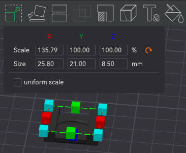

So I modified @StarGazer1258’s watch band model to fit these AliExpress dual frequency tags. When I say I “modified” it, all I did was scale it to 25.80mm across the x axis.
I printed it in TPU and it works wonderfully! I get reads super easy compared to my previous solution!
Here’s the modified file if anyone wants it:
Watchband_RFID_Tag_Holder_Long.3mf (676.2 KB)
