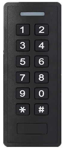

The following Reader/Keypad is a comes as a Stand Alone programmable access control system.
By default it reads both EM and HID Credentials and adding a credential is very easy with the swipe of
a master add card, swipe credential to be added then swipe master add card to end programing.
Has a built in relay that can be used to trigger a lock to open or any other device one would like to control.
keypad can also be used to enter a pin code for access as well.
A very nice device I though would be worth sharing.
Link?
I think I found the link: http://www.smilesbio.com/product/Waterproof-Access-Control-System-Door-Keypads.html
Not sure where it can be ordered from in single quantities though.
I believe I got mine from Alibaba.
Generally they will allow single purchase if you tell them you want to buy one
as a Sample to Test the product.
My concern with something like that is that someone could just expose the wires and “hot wire” it so they could gain entry.
I suppose with branded items that stuff is largely taken care of, but you’re limited to what you can do with their products and vice versa.
This is true, however in my over 32 years of working in the Locksmithing Profession, Not once have I encountered it being done.
They do make the very same unit that is not a Stand Alone unit and wires to an Access Control Panel which totally eliminates this possibility. I use them so customers can issue Keyfobs or cards to their tenants and issue access codes to delivery drivers like UPS, USPS, Amazon.
Work very well for this purpose.
