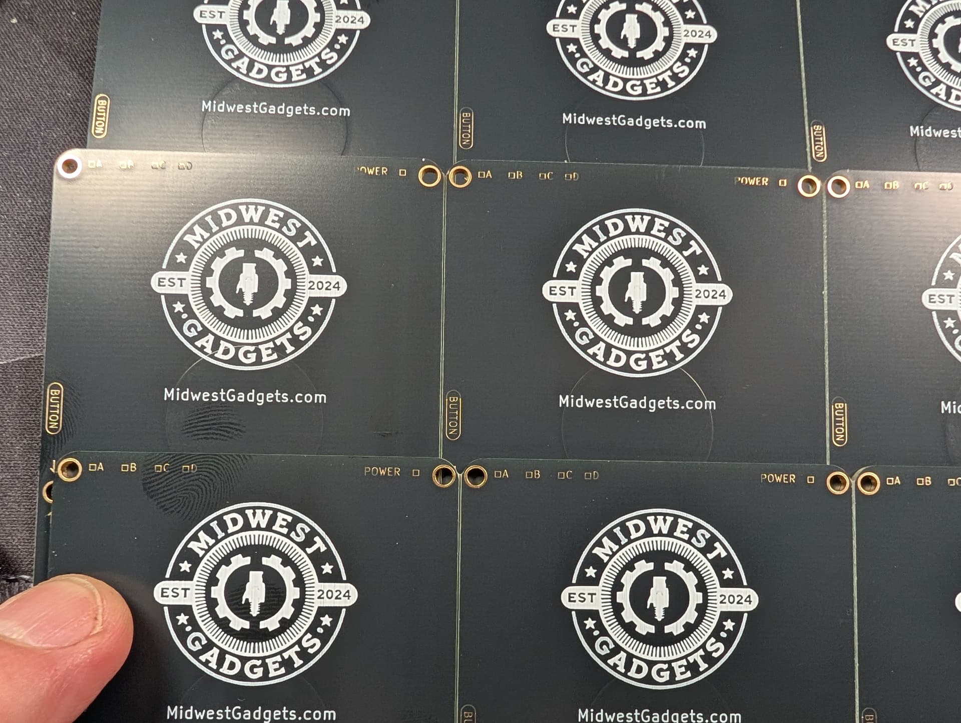

QC is HARD. like incredibly hard. Ive been at this a year and most of my time is spent QC’ing.

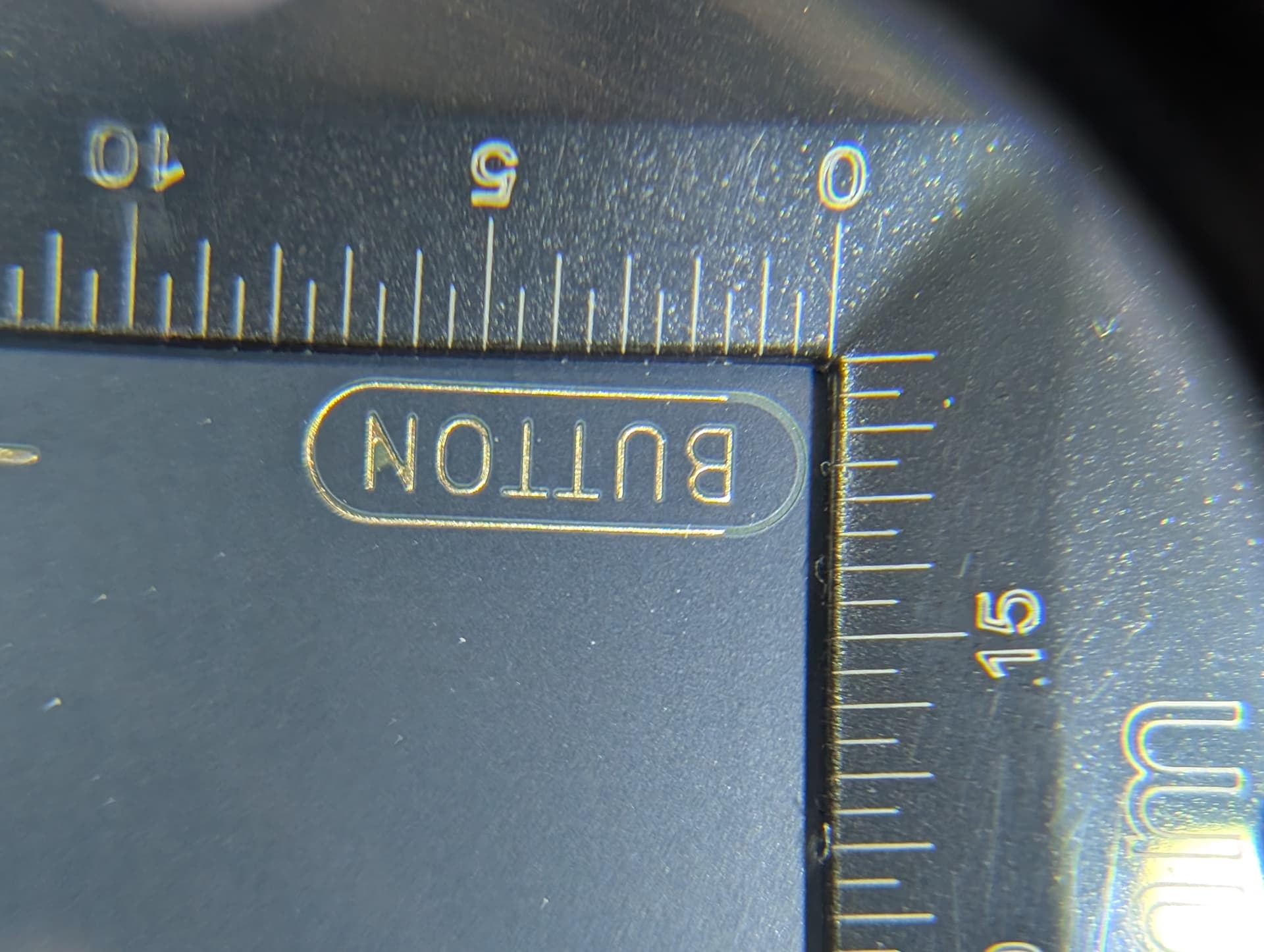

The PM3 Midboards would have been released early January if it wasnt for poor QC. I could have released a very inferior product due to something like this:
Does it affect the performance… no. does it look bad on you for allowing something like this out? Absolutely.
Amal is working on a much stricter set of QC. There are real concerns around sterility, biofouling, and potientially having his products in someone that is not functional.
