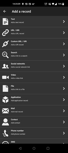

How do I write the url inside the NExT implant. Please provide a link for instructions or a video on how to do this.
THX
I want to write the URL inside NExT so that someone else’s NFC phone can read the URL

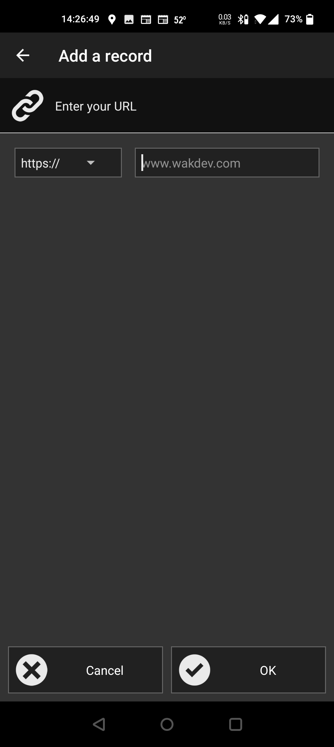

If you download TagWriter or NFC Tools on your phone, there’s an option to write a URL, all you need to do is paste the URL in the text field and then scan your implant. Then when someone scans your implant, it’ll open the URL.
